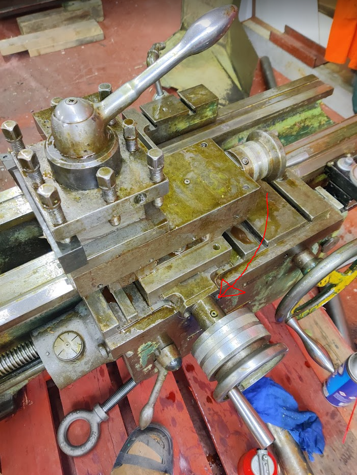

I am lucky all my nipples are perfectWas going around all the oil points last night putting a good bit in before moving it all loads to make sure its all lubricated , mainly on the apron. For some reason the cross slide I think its called at the red arrow , It was a bit stiff to turn took two hands at first but pumping oil through it freed up a little down to stiff for one hand. I think one of the issues could be the oil points as some seem perfect the ball is on the spring and moves but other oil points seem all crusty and not moving hard to tell if oil is going anywhere.

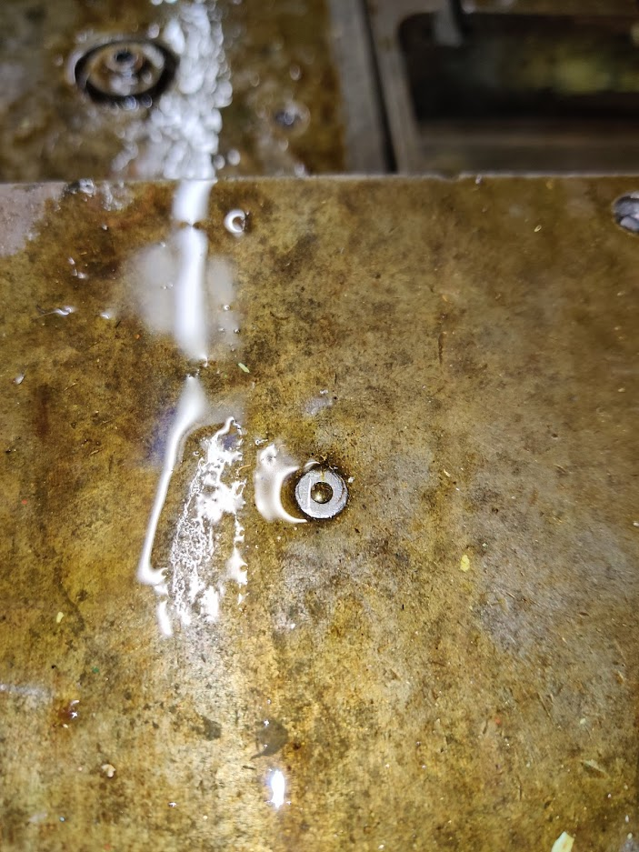

This is the main center one for the compound slide , It was worse before so used some thin Wd-40 pressuried oil to try and clear it out a little so ball moves around but dosent spring up

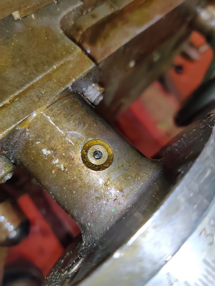

Then for the compound slide arrow labeled dial this is the oil point

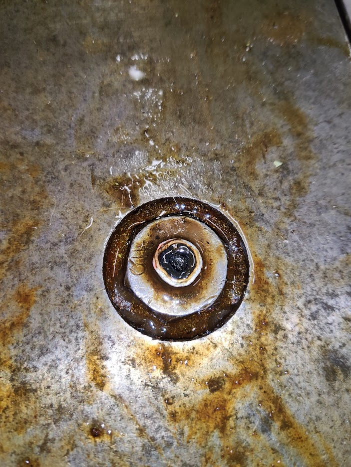

Then on this one I believe the cross feed slide
That was alot more free and could move it up and down fast with little bother however the oil point does look a bit messed up
Was watching a restoration on youtube and he punchs these out from the inside and replaces them just pressure fit, Im not really looking to strip it all aprt like that so was thinking If i could use some sort of puller to take them out and replace.
That is the compound slide. On the later Triumphs there is a single setscrew for you nipping it up to lock it. Looks like the earlier ones have a gib there and 4 screws. Loosen the screws then retighten until you just feel pressure whilst sliding and then check there is now movement radially on the slide and you should be good to go...., mainly on the apron. For some reason the cross slide I think its called at the red arrow , It was a bit stiff to turn took two hands at first but pumping oil through it freed up a little down to stiff for one hand. I think one of the issues could be the oil points as some seem perfect the ball is on the spring and moves but other oil points seem all crusty and not moving hard to tell if oil is going anywhere.
