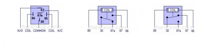

Here's a SPDT automotive type.
http://www.the12volt.com/relays/relays.asp
That one is a single pole, single throw.
You need a single pole, double throw.

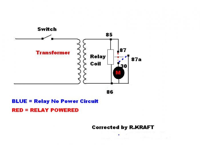

I have to hurry to work.

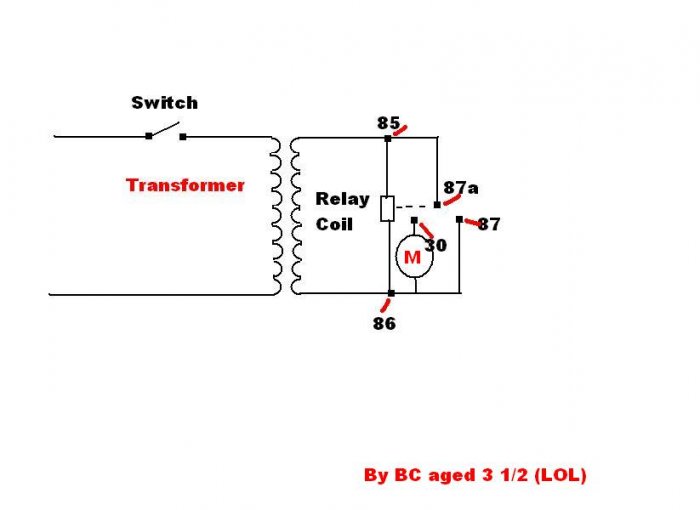

So look close before you use this, #87 would be power from the speed control.
#87a would be on the Neg side of the motor with the ground wire.
#30 would be on the positive side of the motor alone.
When the motor is coasting it acts as a generator.
When the relay shorts across the motor it loads the motor/generator and makes it stop.
If it stops it too fast, you can use a resistor in series with your 87a lug to ground , to let a little more wire feed.
Can you post the modified circuit as I cant see that this will work?

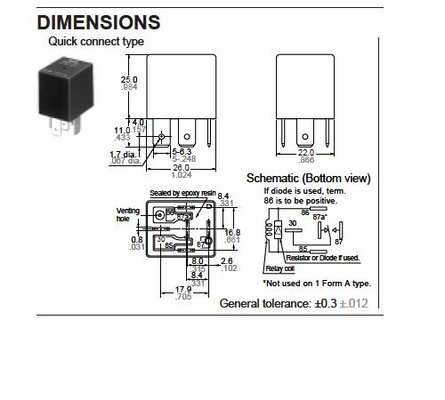

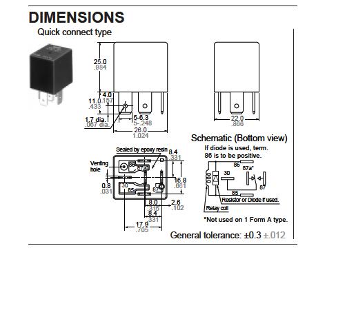

Ahh Good old RS
Choice of just one with 24V and automotive type spades but I think it ticks all the boxes
http://uk.rs-online.com/web/search/searchBrowseAction.html?method=getProduct&R=1782006
