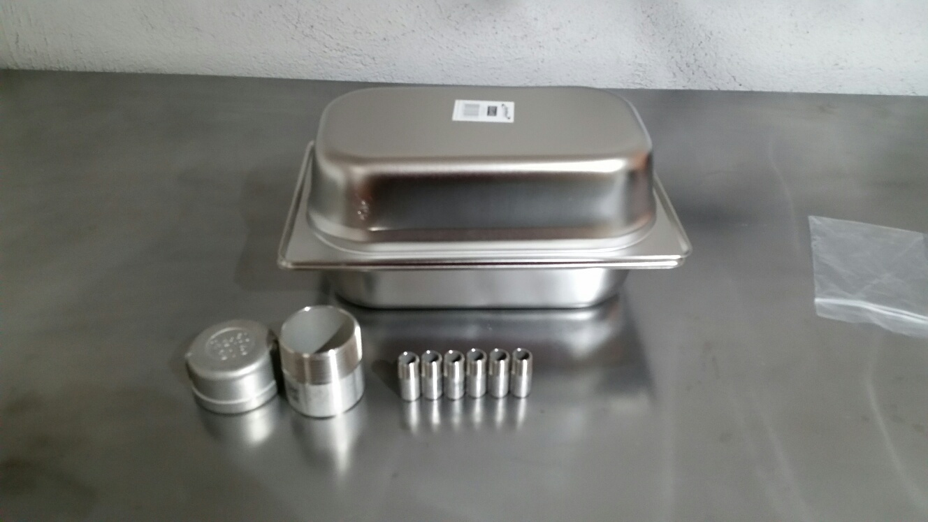

Maybe get a set of three taps for the thread, they're usually slightly larger each time, the second boring and the last finishing the thread.
Run the primary one through before welding, then if it hardens any it isn't so difficult to get the latter two through...
You'll also have a thread in alignment so you don't have to cut it all out if it's wonky
