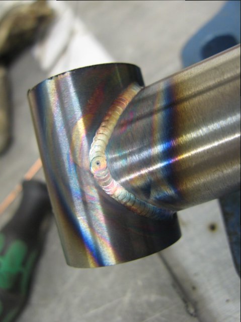

Hi Richard,
I also use fast pulse settings if the machine offers this option.
It seems to stabilize the arc at low amps and edges on workpieces don´t melt away.
The pic below was a testpiece
at some 0.6mm Crmo with ca.1000hz (I guess it just from the noise I heared).
