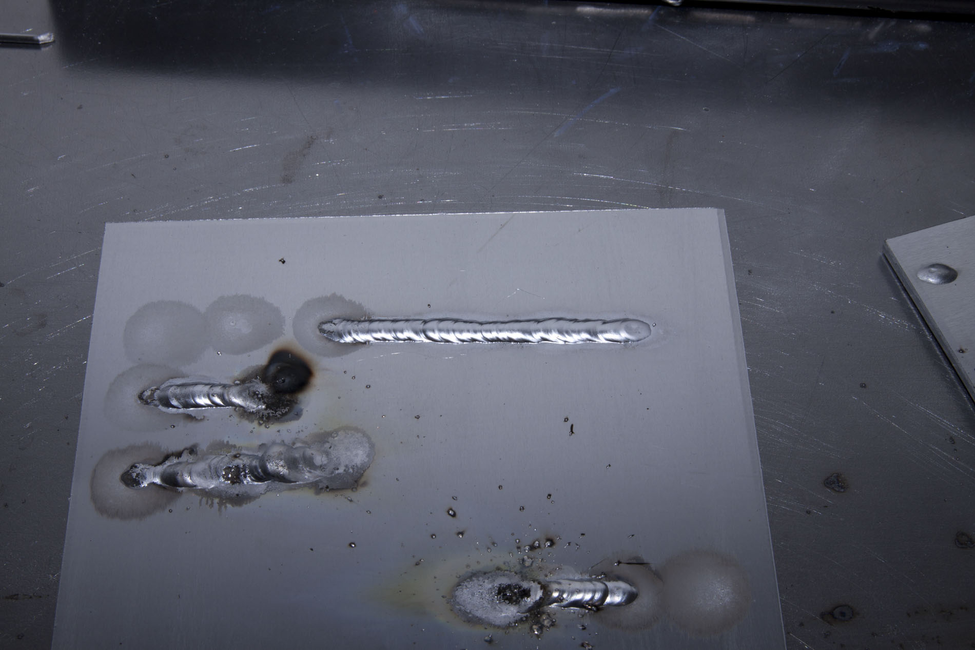

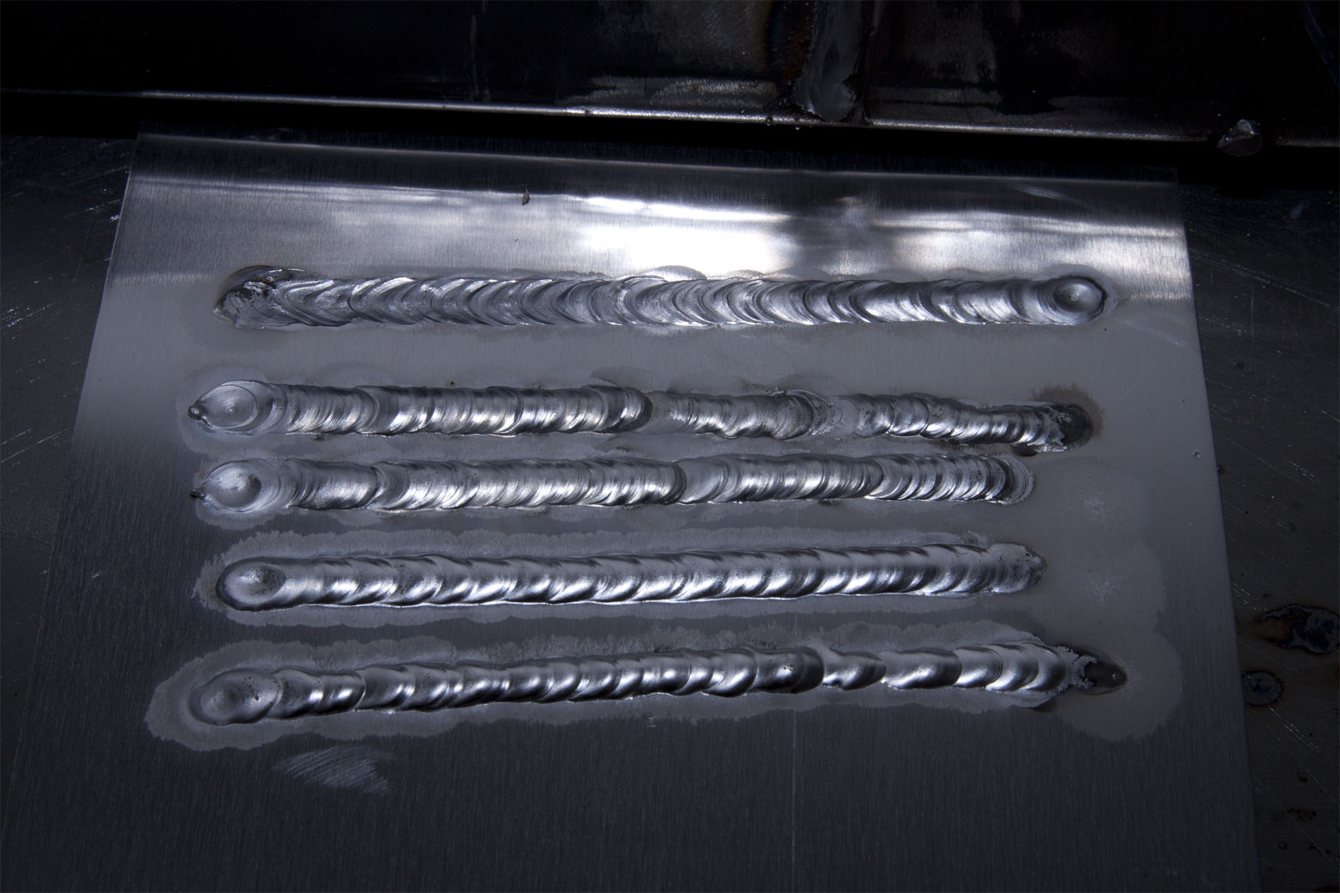

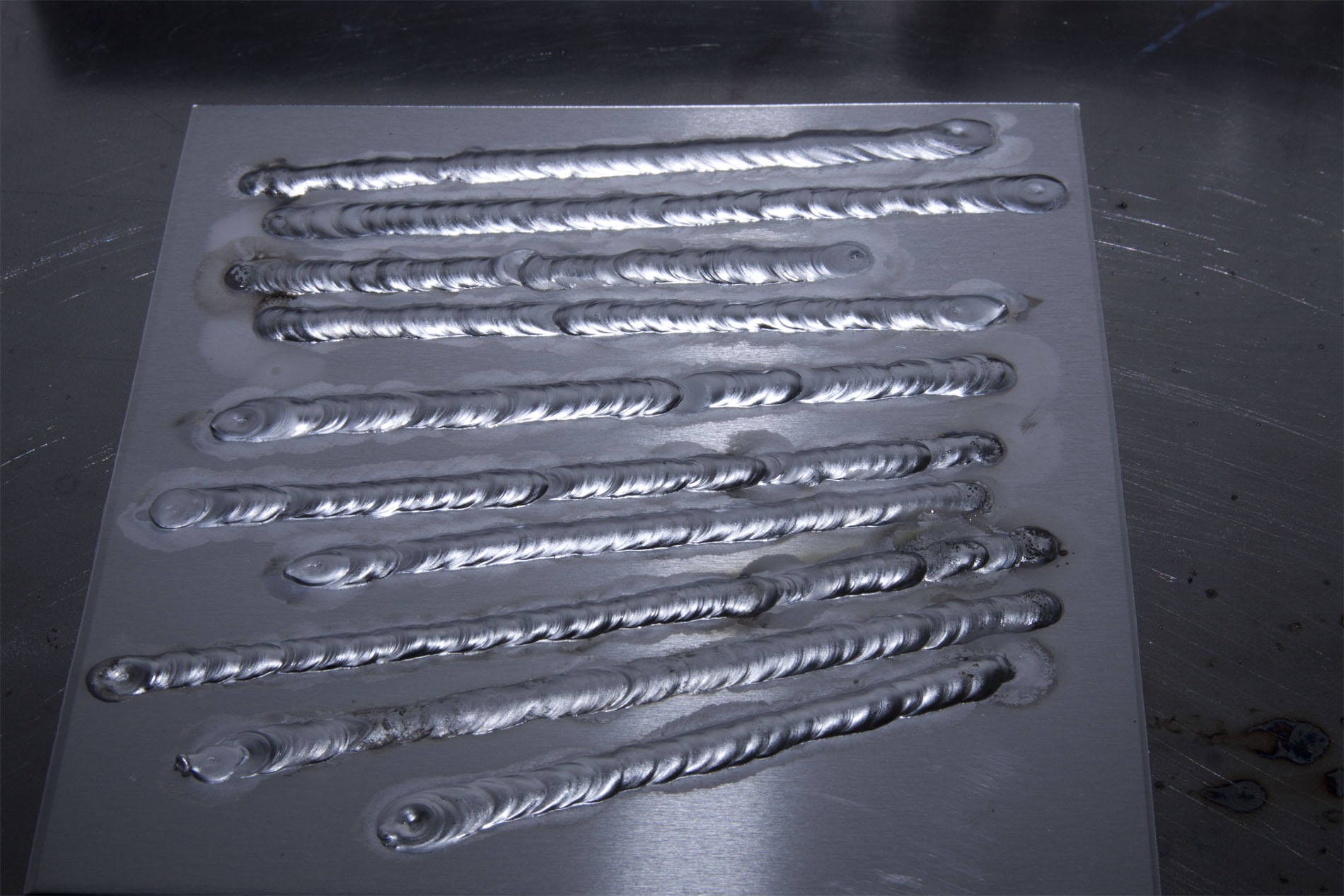

I think i've half sussed it.
I need to set a search arc and upslope if using the hot start or the tungsten destroys it self.
search arc currently set at 50% up slope 2 sec hot start 2.
@brockenhammer did you use the search arc (button before upslope) and upslope on the aluminium?
@Jim Davey are you familiar with the hot start on this machine??
After a few nice runs here and there on other used bits of aluminium, i decided to start a fresh piece and dassle you with some nice beads.
Only..... to slap the tungsten with the filler three times in a row.
Did get one slightly better run though. The cleaning area on start is massive i think this may be something to do with the search arc??
