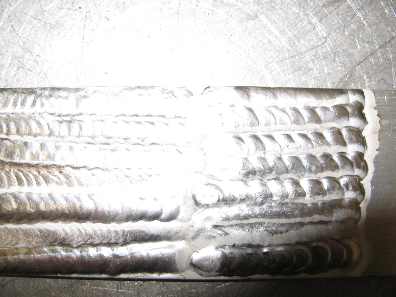

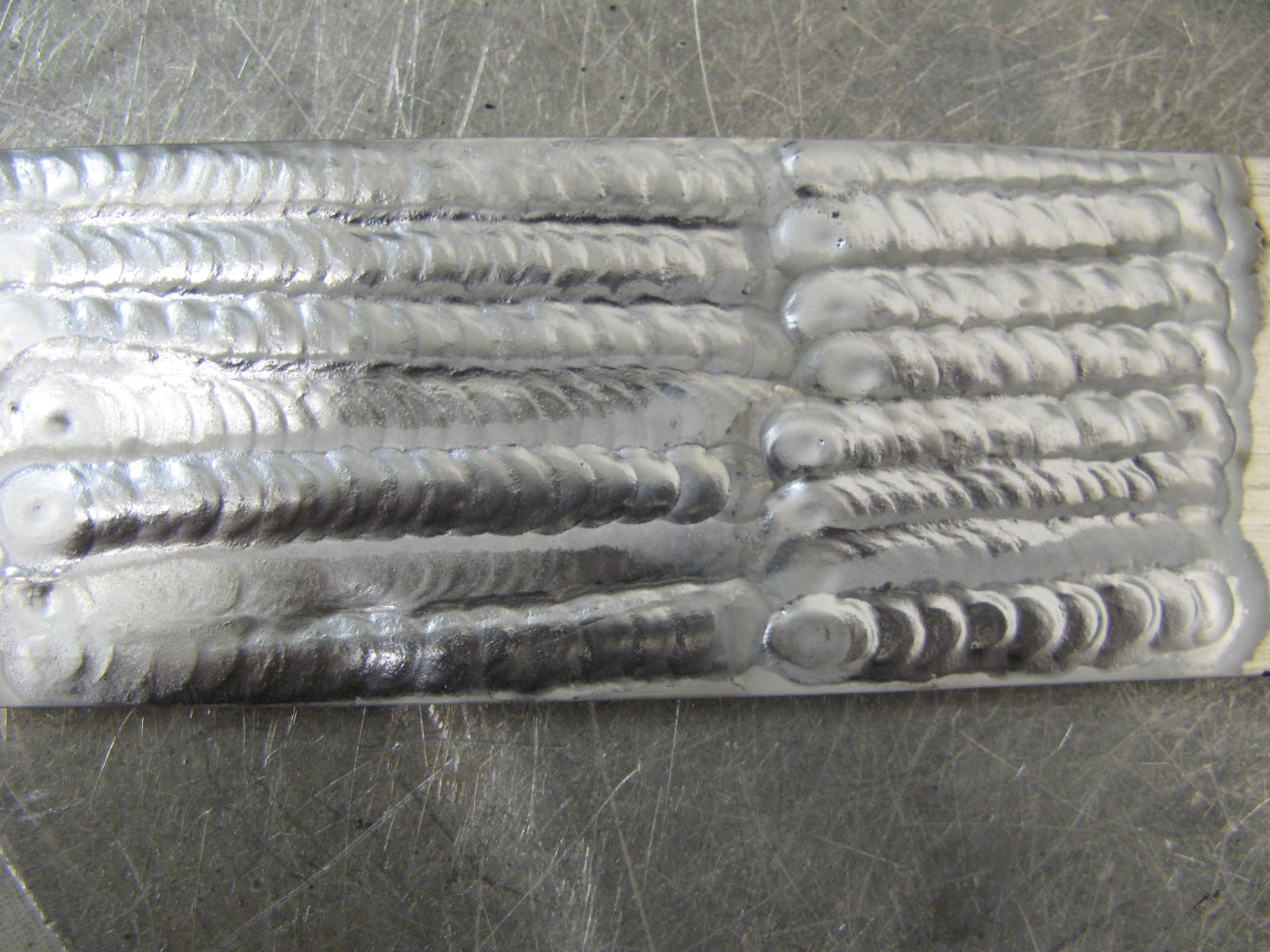

Started off with some small stop starts today trying to stop adding filler before pool is formed and stop the crater at the end.
Then some more beads. A bit more contamination this time, i dropped the gas from 8lpm to 6lpm.
If i wait for the pool to get perfectly clear everything is too hot. Maybe more amps?
