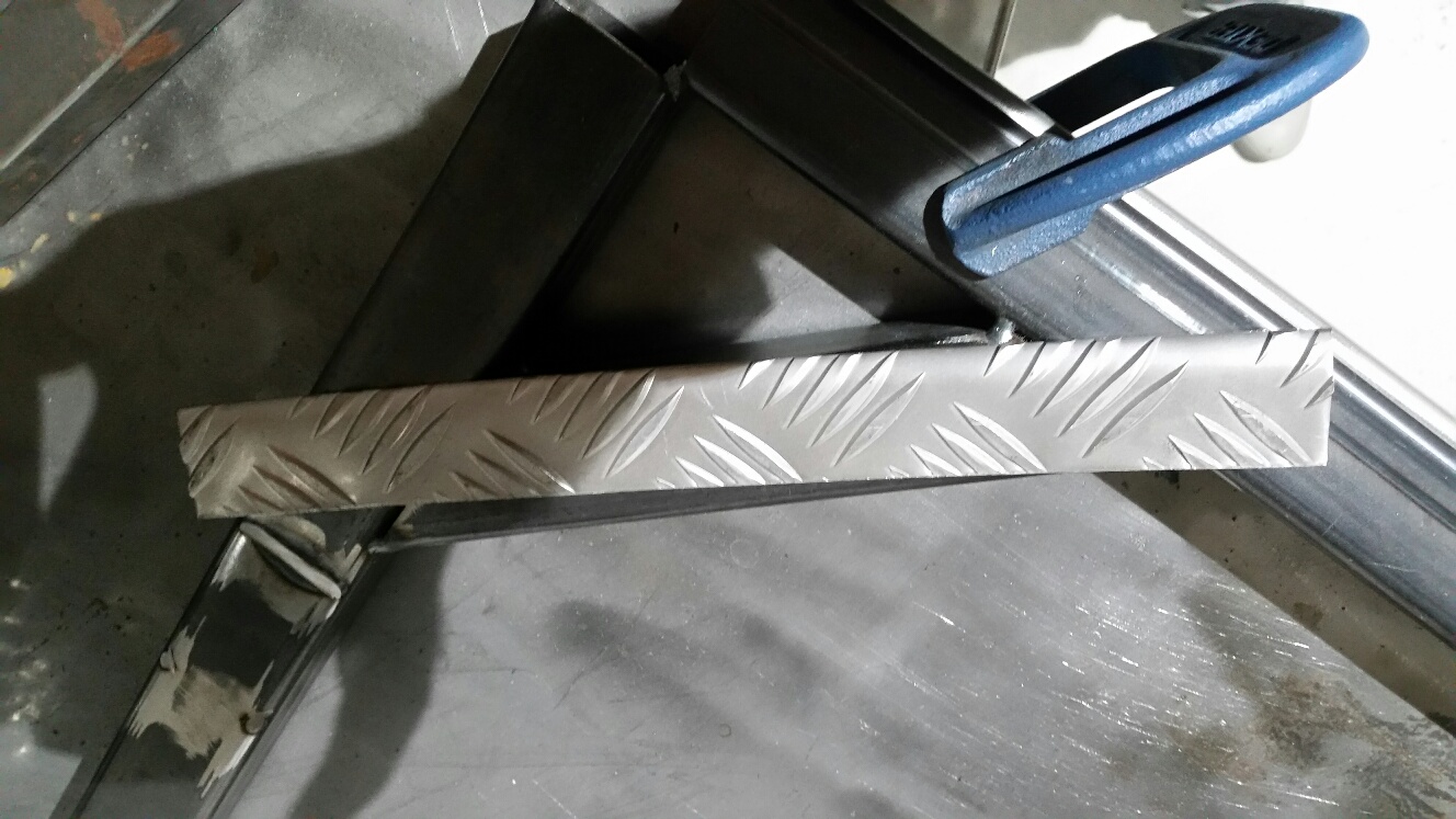

The trays will likely be grade 304 so you could use 308 which is cheaper than 316.I'm not shy will always post pics if they are bad. Most are bad .
Now i need to buy more filler rod. 316L 1mm or 1.6mm.
Like I say you may not need filler for those but if you do 1mm would suffice.
