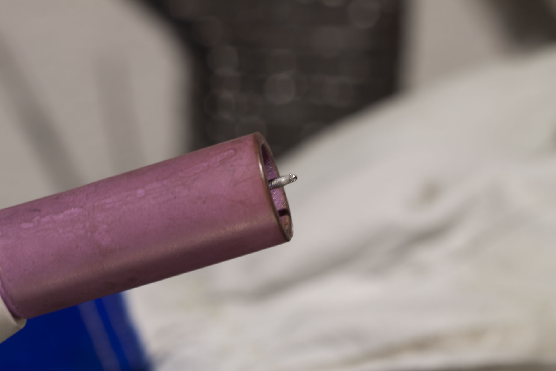

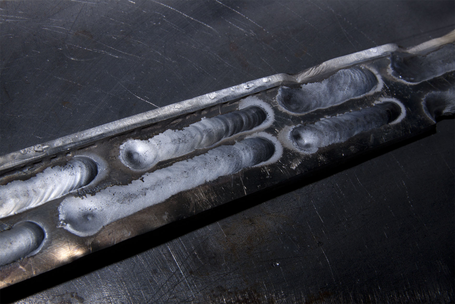

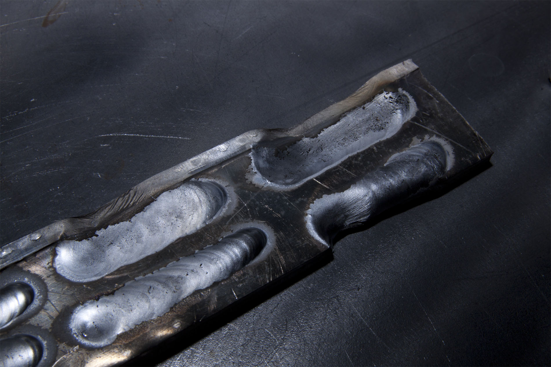

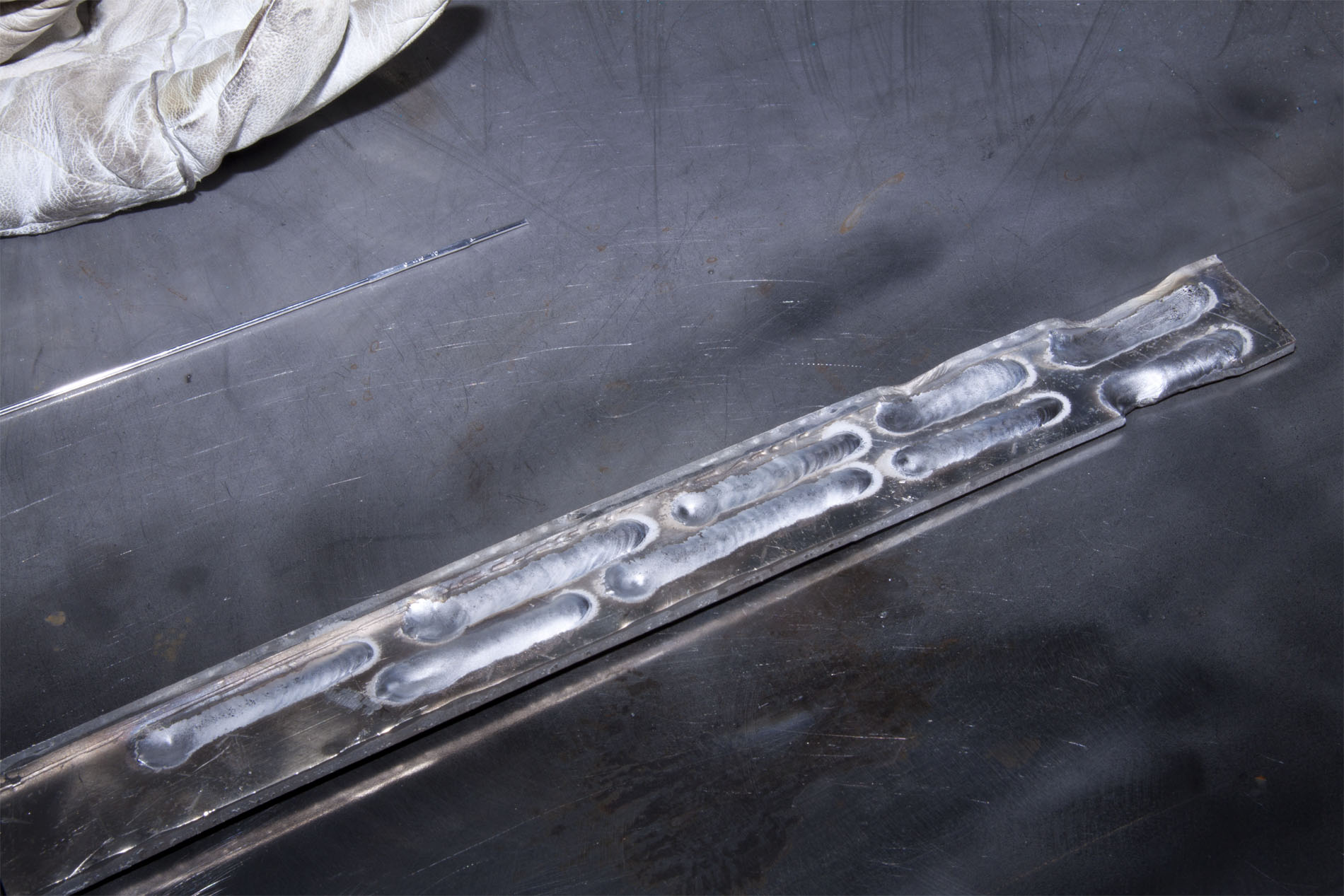

That's balled really nicely daz. You've kept it well controlled. You can afford to move the balance a little more towards the + side. Maybe try 10-15%. Which I'm guessing is 60-65% en. This should brighten up those welds. If the tungsten starts to melt to much and become unstable take it back to 20.Thanks Richard, although its my fault i'm really happy that the machine is working as expected . Cant wait to get a nice cooler attached to it.
The balance was dead on -20.

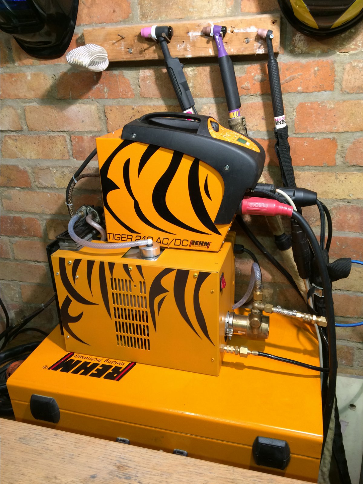

I had to stop a few times today at 90 amps dc .You'll defo need to get that cooler going if you start getting into AC. It batters the life out of gas cooled torches.
Look forward to seeing the thread. I finished my cooler off tonight with the last touches. I'm very pleased with its performanceI had to stop a few times today at 90 amps dc .
Going to have a mess about with them stainless cooking pans next week which should be fun. Started to order a few other bits and bobs.
talk about a matching pair...that looks totally factoryLook forward to seeing the thread. I finished my cooler off tonight with the last touches. I'm very pleased with its performance
Cheers bud. Yes I'm pleased with the result. Those procon pumps perform like a dream.talk about a matching pair...that looks totally factory
