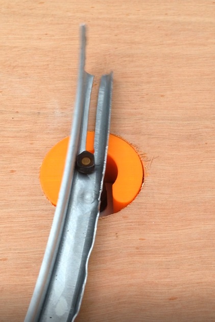

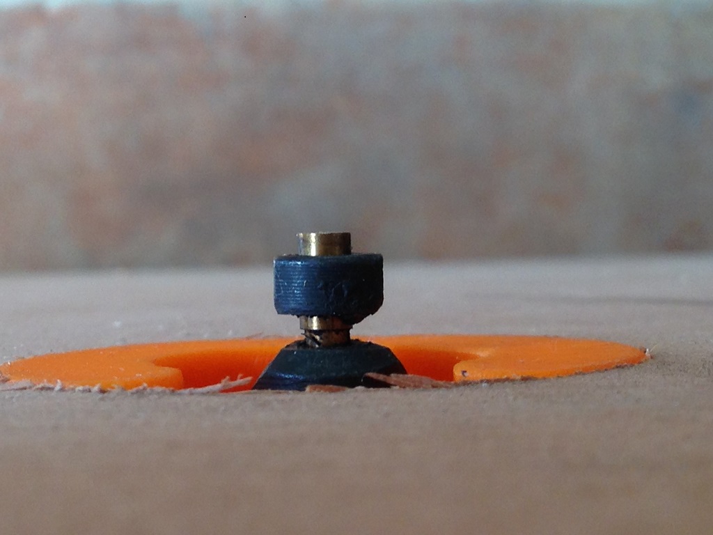

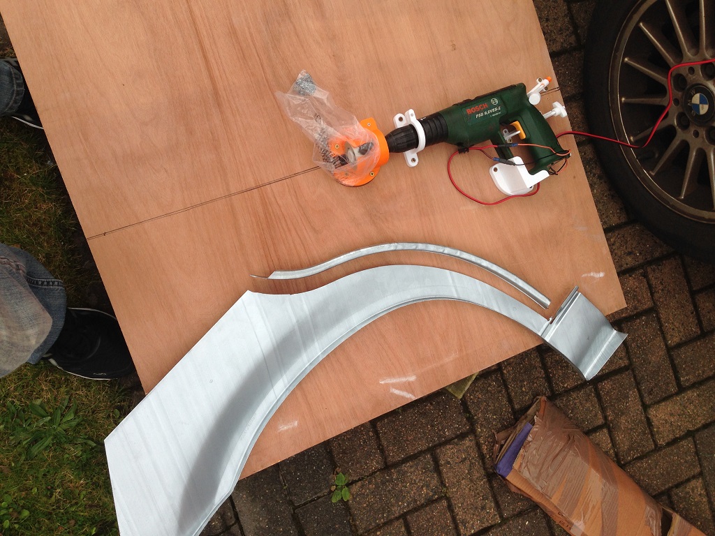

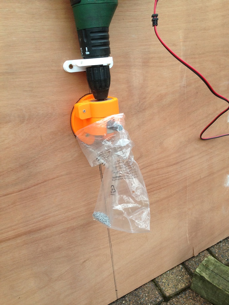

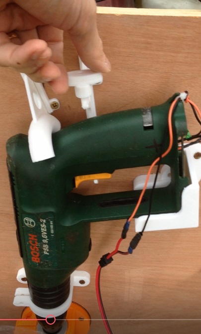

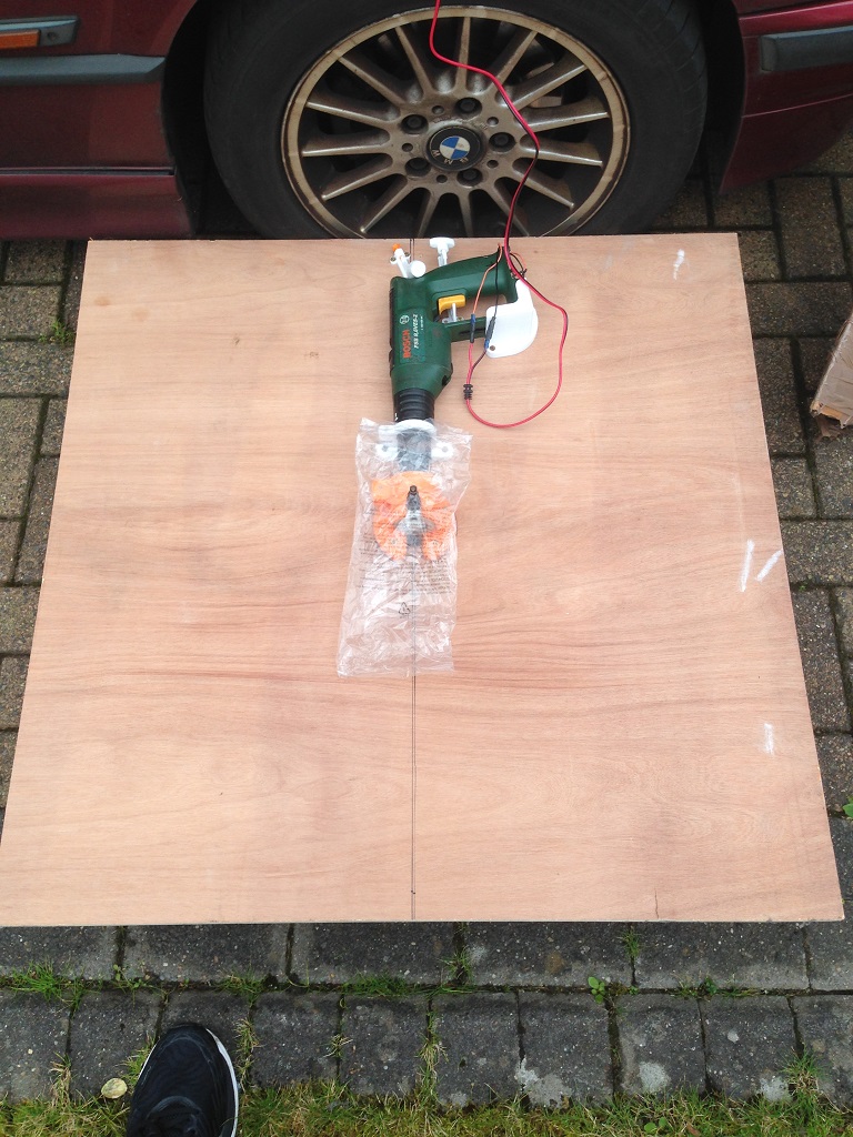

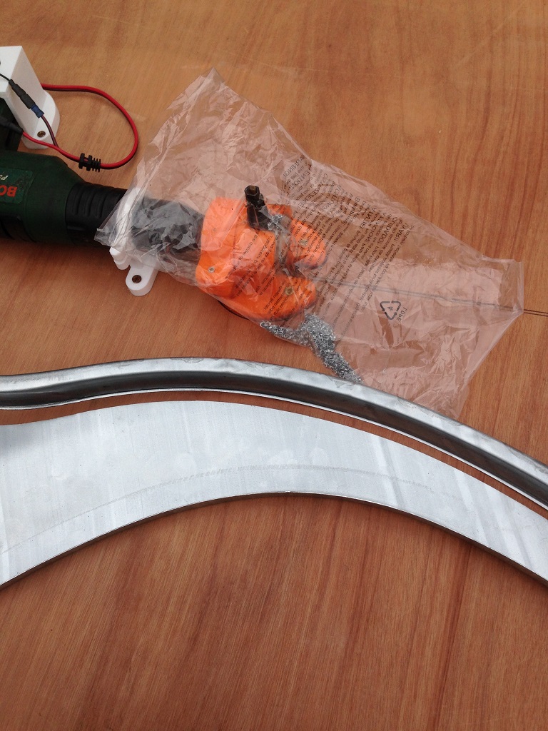

I've had one get inside my boot and work it's way into my foot in rotation so I had to wind it out with pliers.We think alike! I have a pair of Falcon nibblers one of which was damaged by an electrician who thought they should cut square steel trunking, I cobbled one up to a sheet of ply with a fence for cutting sheet into strips. Did a good job but what a mess those crescent chips make and they get EVERYWHERE!
I can easily do something but:dump the plastic bag and fit around a chute down to a collection box then when needed you can empty collection box and just carry on
a large enough one and it will take a while to fill up
Except with non magnetic materialsVery nice , re the chip collection , how about an electro magnet that is on a timer circuit so that the chips can drop off into a container cyclically or even just a switch to deenergise the magnet as the chips build up, might work with some experimentation,

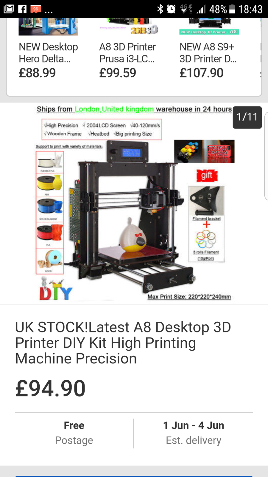

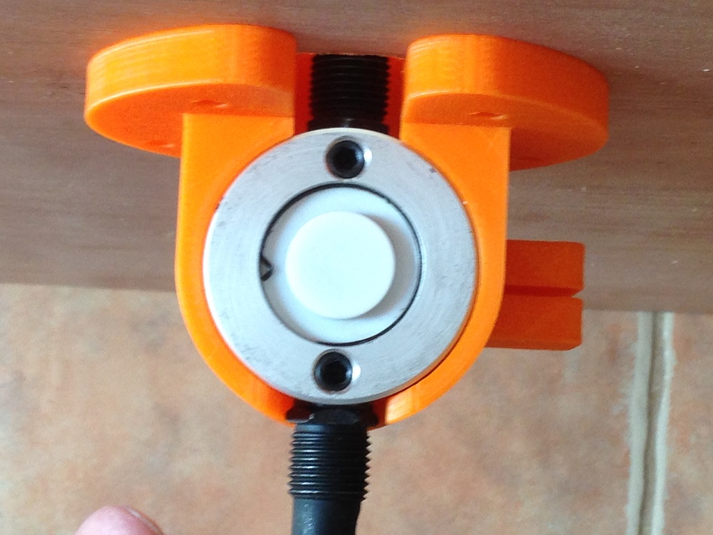

Come down in price now..FYI the printer is a £130-ish Anet A8 and drawn using FreeCad 2
Same thing I printed a few bits for the welder on recently
Or have a look at FreeCad 2, you cold install it for erm free. The two easiest way to do things are sketch, so you draw a flat drawing and pad it to a thickness, or draw a sketch on a face of something to make lumps and holes as applicable, or you use "primitives" which is just normal shapes like cylinders and cubes, cones etc and put them together or subtract them. Seriously the tutorials make it easy plus a learning curve. I could draw in first or third angle but had never used cad before.must be nice to have and to know how to use a 3D printer........hahaha.........I'll have to wait till my next rebirth.........hahaha.......
great idea.......
I don't see the "Anet A8" name in that listing frame looks sturdier than mine but also mentioned wood, I tend to think acrylic is more stable shape wise, if not rigidity wise...…. but the second thing you print after a test piece are printer improvements, usually from some one else's designs on a site such as thingiverse.com
50 quid less...For c.£150, it's a no-brainer really. I have probably a dozen projects *now* for a 3d printer

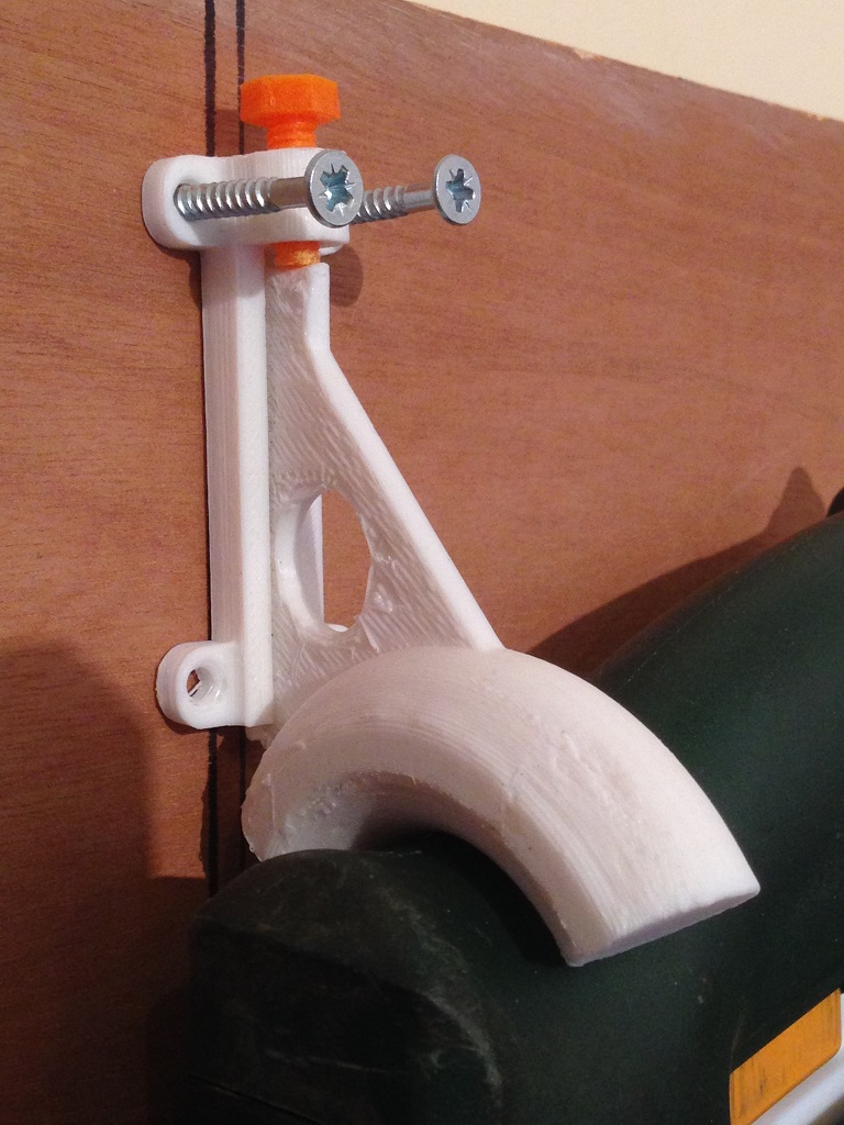

First is a new fan cover for the back of my planer motor:
a new cover is going on £15.
It can also be used for making casting patterns, and some custom tool holders for my ongoing, long term, "studley style" tool cabinet project.

Are they used much on non ferrous materials?Except with non magnetic materials
Ah i see..lolOr have a look at FreeCad 2, you cold install it for erm free. The two easiest way to do things are sketch, so you draw a flat drawing and pad it to a thickness, or draw a sketch on a face of something to make lumps and holes as applicable, or you use "primitives" which is just normal shapes like cylinders and cubes, cones etc and put them together or subtract them. Seriously the tutorials make it easy plus a learning curve. I could draw in first or third angle but had never used cad before.
We can use fly paper for the non ferrous.Are they used much on non ferrous materials?
