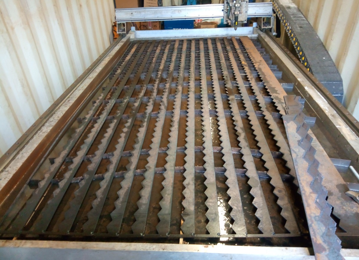

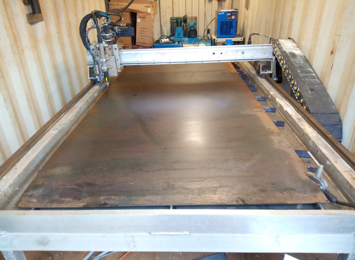

That soft sense is so much faster than the swift cut tables. That’s rapid.Sheet of 3m steel was with me first thing so got it hauled round and put on the table. Managed easily myself which is something I would never have managed with the previous table, so very happy with that.

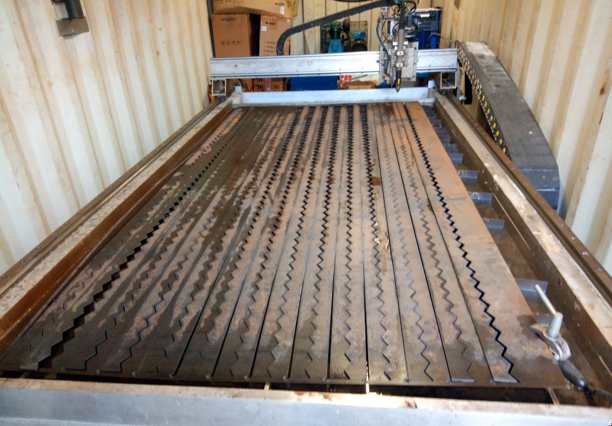

Got it cut up into the slats.
I was going to run along with the plasma and cut the second set of slats free but was just as quick with the grinder.

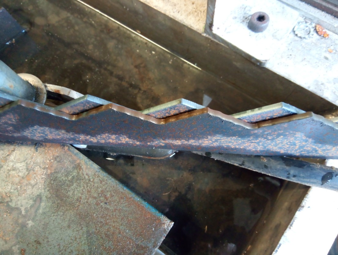

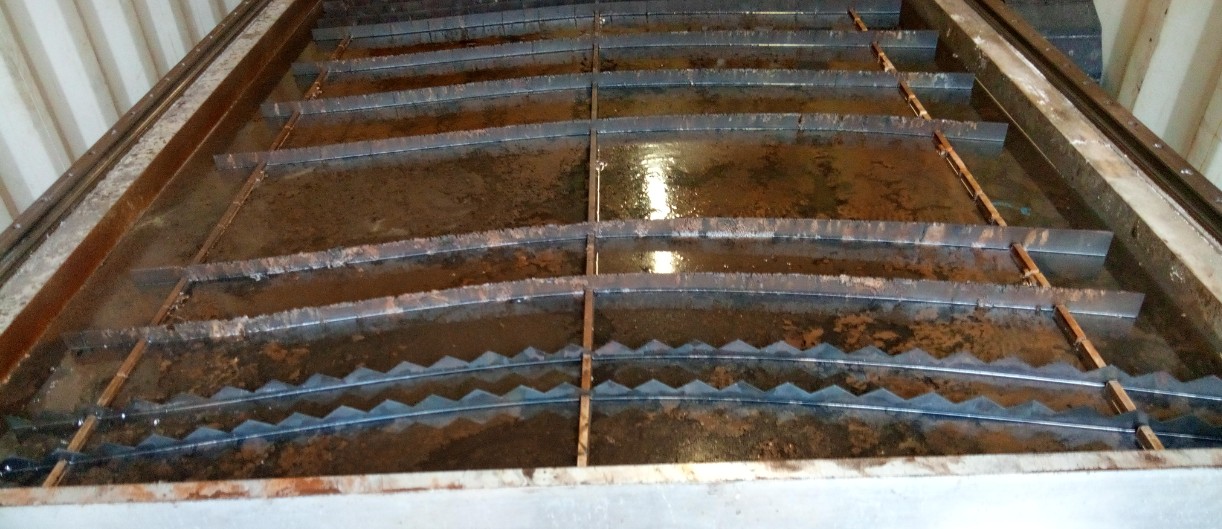

A couple of slats cut to length and placed in to see what they are like.
I do have a problem though and I am going to have to put the slave motor back on. As can be seen the finish is jagged and worse on the slats that are furthest from the motor side of the gantry. Not an issue for this but definitely needs sorted before I do any more.

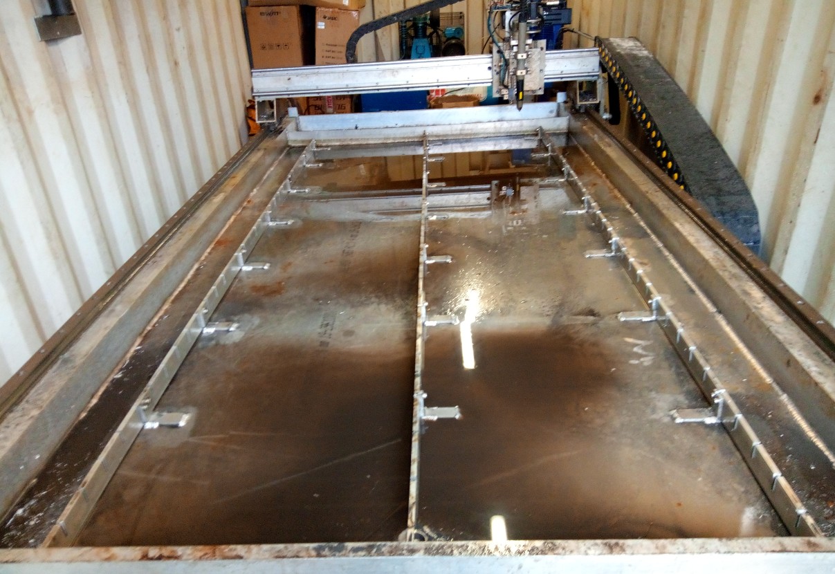

I have now drained the table.
No marks or anything with the washing soda but if left for a long period I think it would eventually have shown issues so best with it out and I will get some borax or something.

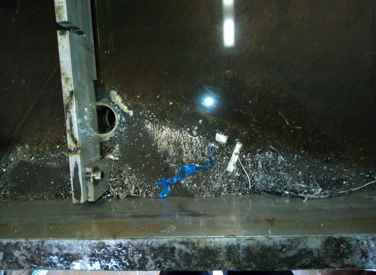

Plenty of sludge though, lots from the steel but also a lot that was left on the table before I filled and also a load falling off the slats.
