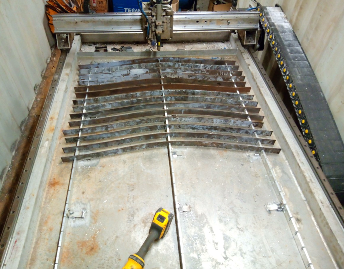

I have no physical experience of it but there is a table that uses the legs as a tank to drain the water tray down into.I got the aluminium slat holders fitted and levelled today and fitted some of the old bars that were of reasonable condition.

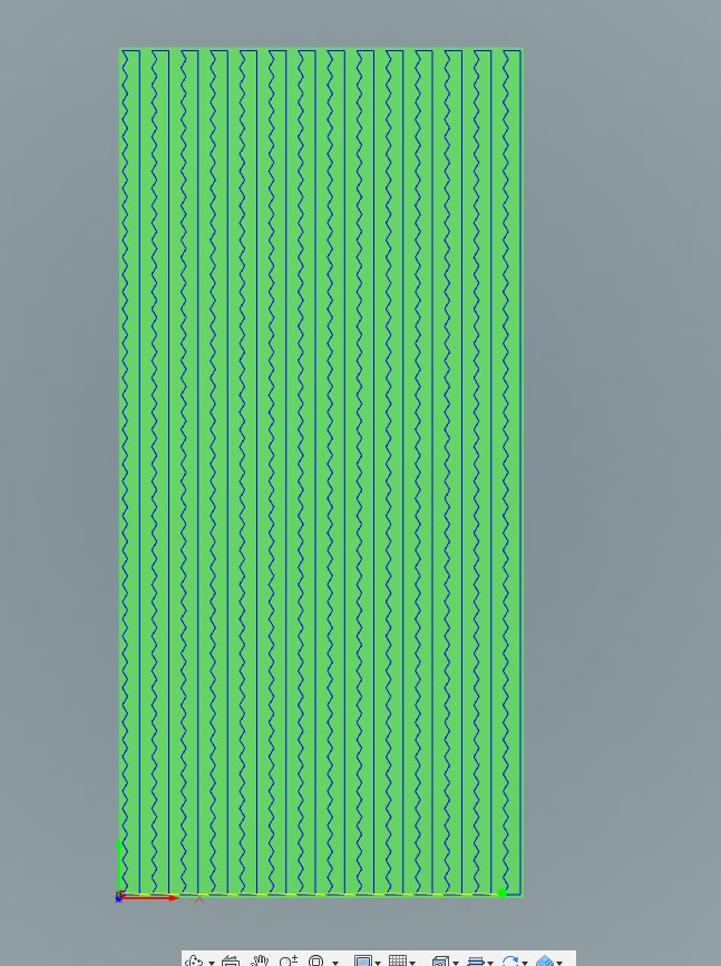

Not sure whether to get a sheet of 3mm and cut as per the pic below which would give me enough to do the whole table or just get some more 50mm x 3mm flat. Hopefully, whichever way I go, I can get it ordered tomorrow and delivered Wednesday.
I don't have the tank plumbed up yet, not even sure how I am going to do it, air or pump. I have a central heating pump that I could use, not sure how it would stand up and may be a bit slow but I really like the idea of using air as there is nothing to get clogged up except the pipes.
Air Lift works great. Used on ponds sometimes. Cheaper than a pump vs volume of water moved.I have a tank made already, just need to decide on pump or air.
Air seemingly works very well and you only need a few PSI. I have an old oxygen regulator I was going to use for adjusting the pressure but I am not sure if I have enough valves and other fittings lying around to complete things and this time of year is a right PITA for getting anything delivered.
Might actually be better with big bore air pipe as it would fill quicker at the low pressure, that would mean the regulator wouldn't be any use though. Will have a mess around with things and see how it works but at least I can just fill the table and work away with it for a while before having to worry about it.
