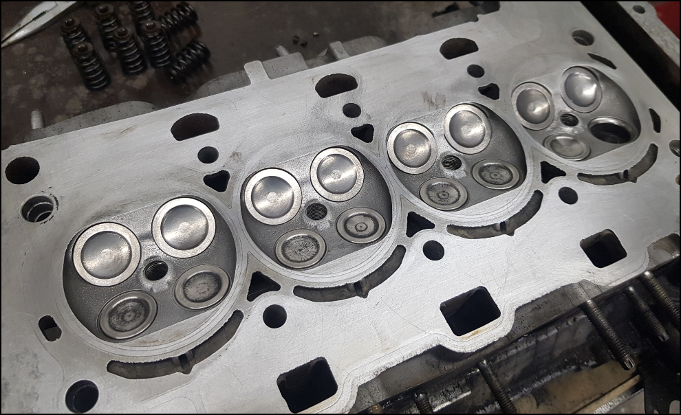

Any idea what caused the valve to burn out in the first place?
Tappet closed up? Or just a manufacturing defect?
Would have thought it was noticeable for a while though, not a sudden fault
What tensions the timing chain ?
Had problems with a Seat, all down to the plastic hydraulic chain tensioner.

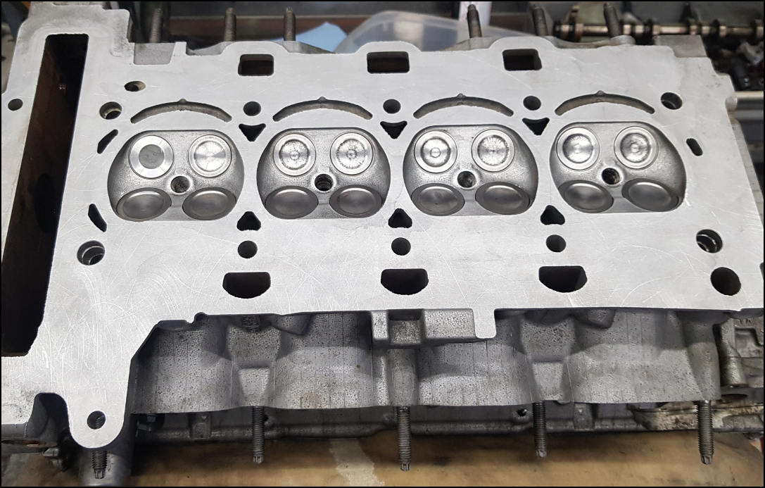

Did you re surface it on the pavement?Didn't go to work today still rough from this rotten cold. I managed to get a bit done, valves lapped and installed, head also lapped flat ready to re-fit. Need to build up the cam train now.
