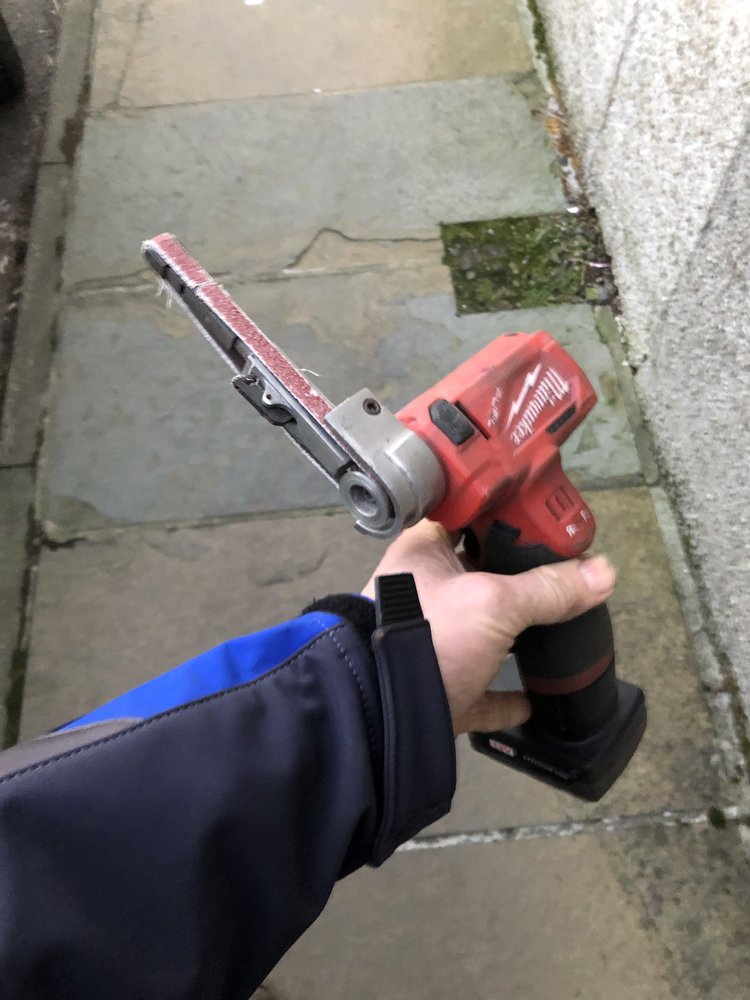

It might be my imagination but I have a feeling that most of the reason for the belts apparently snapping for no reason might be due to the end bearings on the tool.
I have run cheap belts on good tools and not had any snapping from them.
I think the bearings on the cheaper tools get hot and bind up slightly or something.
I have noticed that, when replacing a snapped belt reasonably quickly that, the end bearing is suspiciously hot and often stiff if you try and spin it.
I have a really nice pneumatic one and that directs part of the air over the bearings to cool them.
If you don't want pneumatic then I would look for something that has a lot of torque and a lower speed. Then you can get a courser grit belt on it and run the thing slower.
