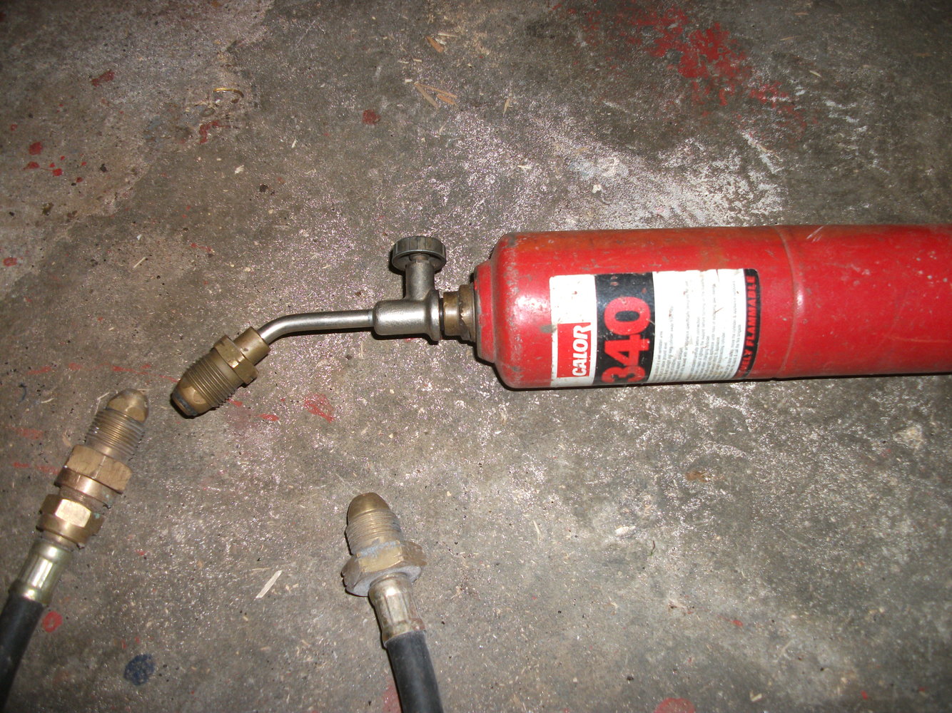

heres my refill adaptor its just a screw on torch with the one way valve removed and a bulnose threaded on to where the gas nozzle went can fill em of a 47kg bottle for about 50 pence instead of 12 quid
I like that, I use the type of bottles below.only time i disconect mine is on the 2000 bottle is if im swapping an empty put a full one on and i refill the empty . only ever had to change the o ring last month its been on for 50 yearsheres my refill adaptor its just a screw on torch with the one way valve removed and a bulnose threaded on to where the gas nozzle went can fill em of a 47kg bottle for about 50 pence instead of 12 quid

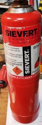

I have four bottles, just wondering what I needed to make up refill fitting?its a sievert torch. all is needed is a bulnose of ebay and it needs drilling and tapping to fit on to the torch where the nozzle was. someone is flogging a torch and 2 empty bottles on ebay at the mo under 20 quid then u just need a bulnose of an old regulator or a new one of https://www.ebay.co.uk/itm/176790204695?_skw=primus+2000++bottle&itmmeta=01JJ7QKJ4YBQMXK9D9XEBBFZX7&hash=item2929847117:g:zn0AAOSwGzhnhn~k&itmprp=enc:AQAJAAAA0HoV3kP08IDx+KZ9MfhVJKkwPA1KKytrbe8fHpiwyMvlBiC+DkFCvtH7USz7MtxQ9FFhSm6itW23hPCZnbVXtPM3j9d9uSaVuxXISEuvI0vLY6ivKqhGDZtHbIiXWWrh6UpuKs3J+Z313/ItcQvxMdgkwiCyHw5QVAfZoxai7G9l7lmqJalAGkzRdZ+iRO/P7DTWKhNUG3SJosqobHkFOoaJrRNH3WPcKf3iW2f6L+p7QTn/bWEynUM7ZDWNY8tRp1ZoSDm8jyfrPBAWZNOzT5Q=|tkp:Bk9SR-aizveRZQ
just the torch and an old propane regulator you can screw the bulnose offI have four bottles, just wondering what I needed to make up refill fitting?
Something like this, what do I need to drill and tap and what size drill bit?just the torch and an old propane regulator you can screw the bulnose off
cant remember what size and thread i did mine will have to take it to bits and look .i have a spare torch you can have to make one as i have another 2 spare torchesSomething like this, what do I need to drill and tap and what size drill bit?

Thanks, I have bottles and torch heads, I like the idea of just refilling my primus bottles from a larger one if need be.cant remember what size and thread i did mine will have to take it to bits and look .i have a spare torch you can have to make one as i have another 2 spare torches![]()
just looked i have a spare torch it needs a couple of new o rings fitting and remove the one way valve . ive threaded mine 8.0mm and can also do that for you all is u will need is a regulator . cut it off the pol fitting and drill and tap it m8 and it will screw on to the adaptor . cant remember the proper weight to fill them so will get it of me bruv as he fills all of his . all you do is turn doner bottle upside down screw the 2000 bottle on open valves for a minute and you can hear the liquid gas going in then it will stop. remove the bottle and press the valve down and remove some gas refit and repeat the process then its full .weigh it and fit torch job doneThanks, I have bottles and torch heads, I like the idea of just refilling my primus bottles from a larger one if need be.

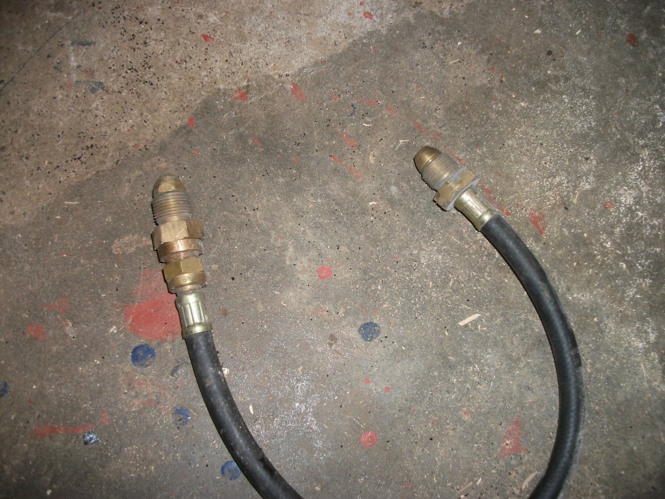

i also have the adaptor flexi hose with a pol fitting either end for filling the bigger bottles cheap doing it the same way as above , its simple and safe enough. just do it outside though
