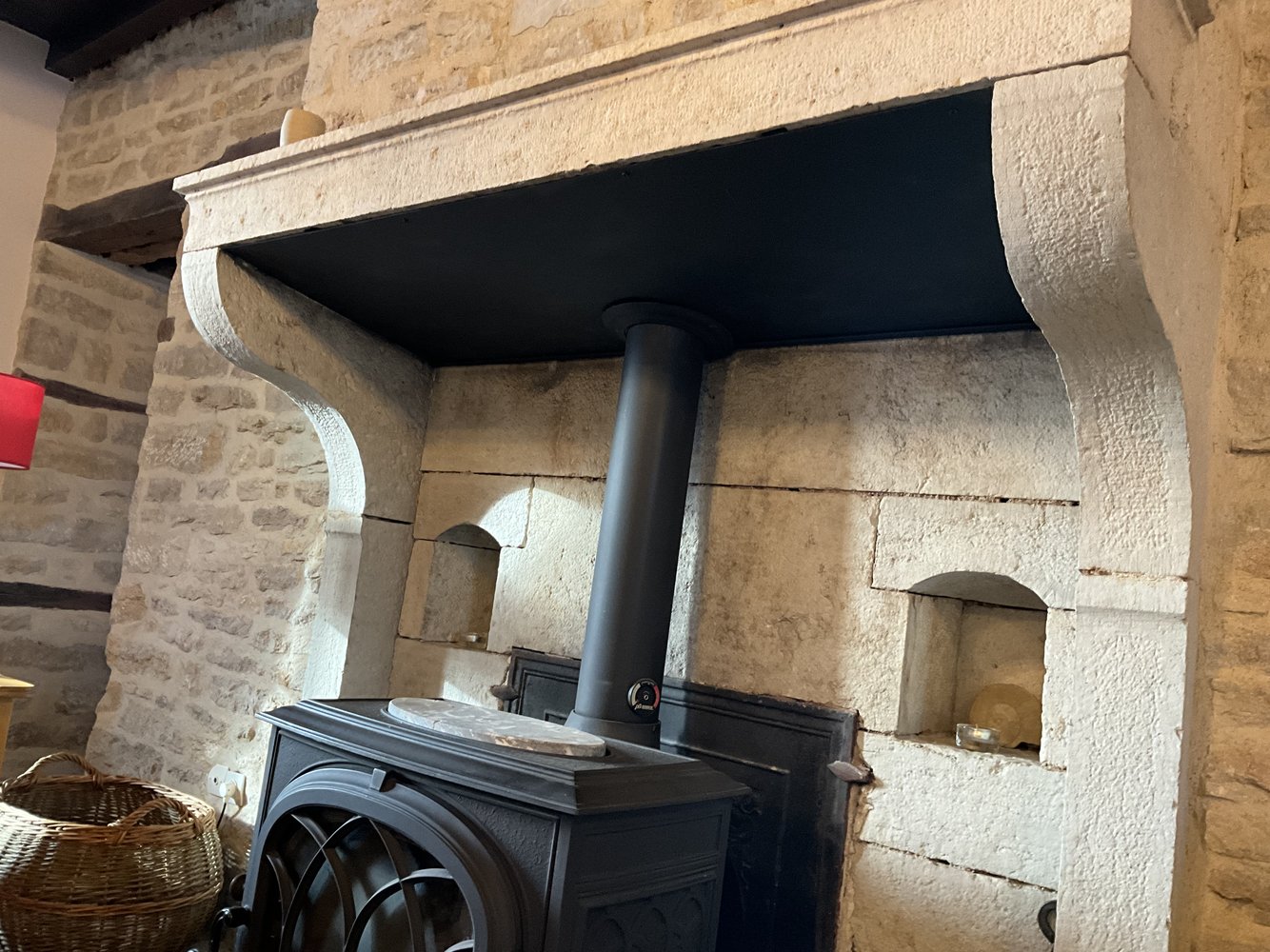

no timbers….mines steel
Painted black with stove/high temperature paint?
. Id bewary of touching it from an insurance perspective!
Make a simple blower gun to push sucked up vermiculite up above the plate via a removeable steel plate
Check YouTube for filling a cavity wall with vermiculite chips there are several very good 3d printable designs for such a gun.
A hot air paint stripping gun with heater removed was good enough to produce the blow .
Yes or your loosing heat from the flue reducing the draw too.As in fill the whole space around the flue with vermiculite, up as high as it will go?
When I filled ours space around the clay chimney liner I dont remember the vermiculite being that dear. But I was spending money on building materials at a great rate, so perhaps just didn't notice it. We took our house back to bare stone, removed all floors and roof. So few bags of vermiculite would have disappeared into the total bill.That must cost a few quid?
