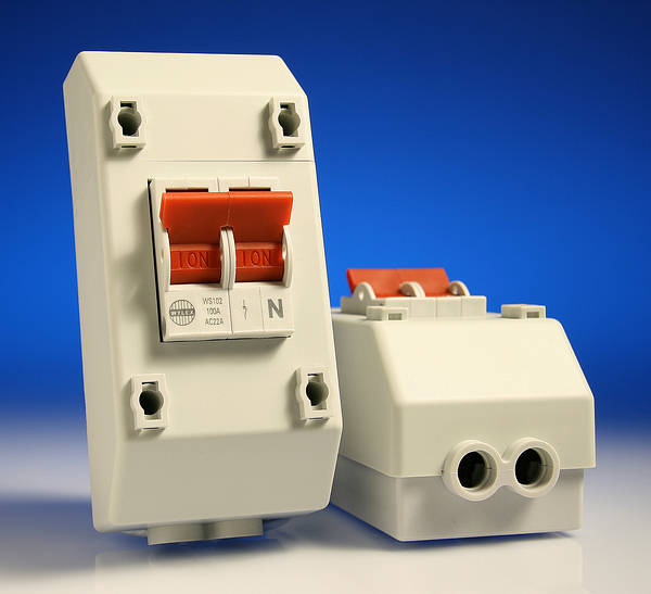

That’s another question I’ll have for the spark tomorrow
I don’t want the garage supply to come from the house CU
The house used to be 3 phase, when we bought it we got the whole house re wired, it’s now single phase, but, the old garage its going to be converted next spring for my wife’s business and that will come from the house CU, there’s already a cable from the CU to supply that, it’s currently unconnected.
I’m presuming that I can get a spur from the switch which is downstream from the meter to be split to get an independent supply to my workshop, that I’ll know tomorrow. That way there won’t be 3 buildings supplies from a single CU, and hopefully won’t mean I have flickering lights in the house or the other building whenever I weld or a compressor starts up.
Maybe I should have kept the 3 phase with hindsight haha!
A hundred amp fuse from the meter will be more than enough for all 3 buildings though
And I presume that the 10mm swa will need a fuse or CB to protect it after the tail/spur from the main fuse though I’m not sure what ratings these come in, this is above my knowledge just now.
