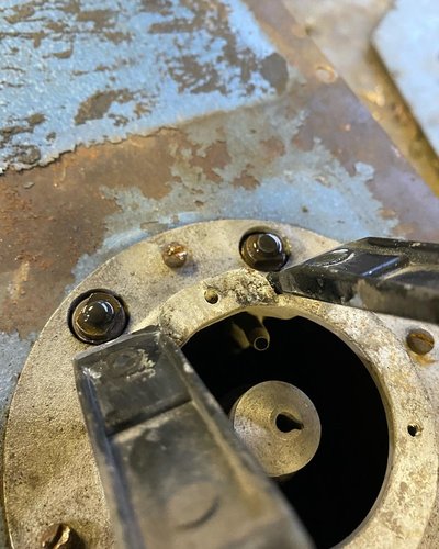

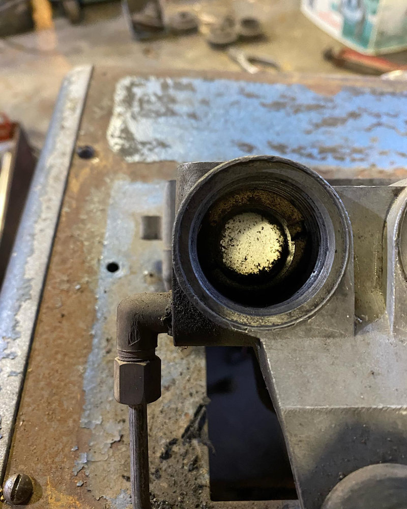

While your needle may be worn, it could be the fuel level in the float chamber that is incorrect - meaning it may be the float, the needle valve or even some gasket material interfering with the float movement. I’ve also come cross leakage around the foat valve where it is screwed into the carb.
Other faults could be the air supply - filter, or choke mechanism loose. More unlikely, intermittently leaking, or not leaking, air into the induction side, thus changing the perceived settings in an uncontrolled manner.
Fuel level in the carb can be altered by bending bits or by changing the washer thickness under the float valve. The gasket between float chamber and cover may also be allowing fuel to enter the airstream without passing through the carb jets.
You need to know how the fuel metering is changing throughout the speed range, but hopefully, for you, the new needle will resolve the problem.

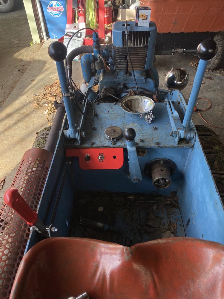

that's what I like about jobs like this, having to fix something that I need to fix the something that I'll need to fix the something else so I can repair the original thing I was trying to repair in the first place... aaargh........ maybe that's why things take an age to get out the door.... ah well at least we move forward..
nice work by the way...
