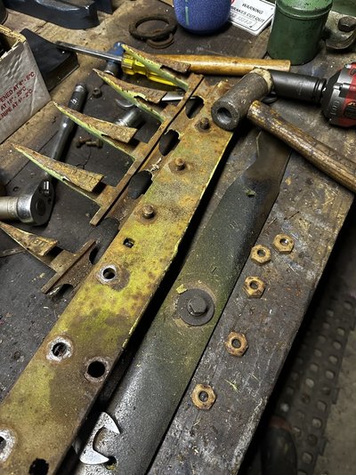

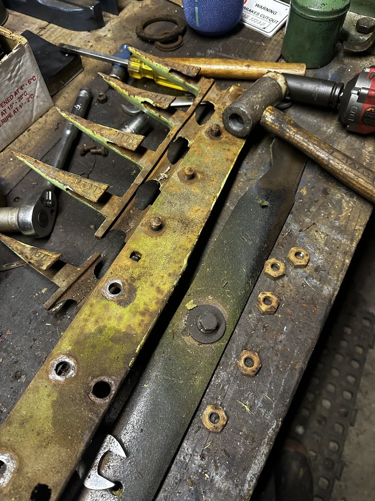

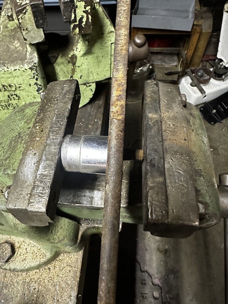

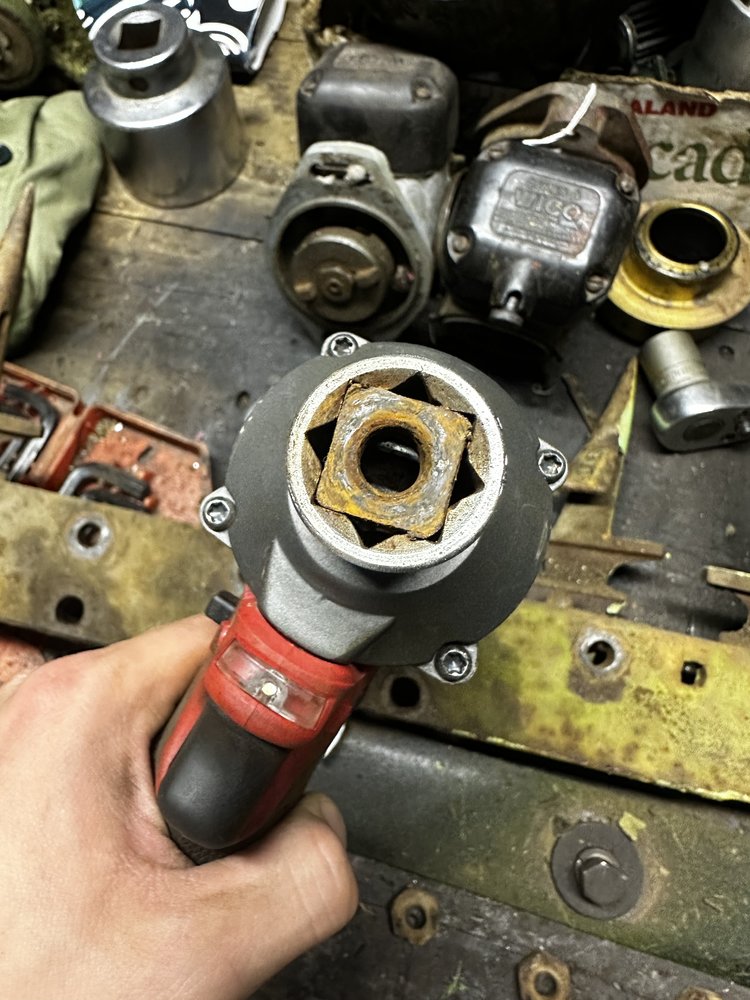

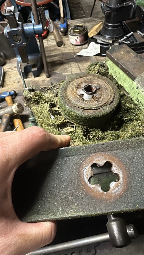

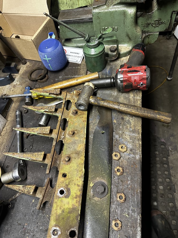

If you haven’t got a socket, cobble one together and use a big impact gun on it. That’ll come right off I’m sure.Trying to remove the accessory and starter pulley. The cap screws were completely seized in there. This called for drilling.

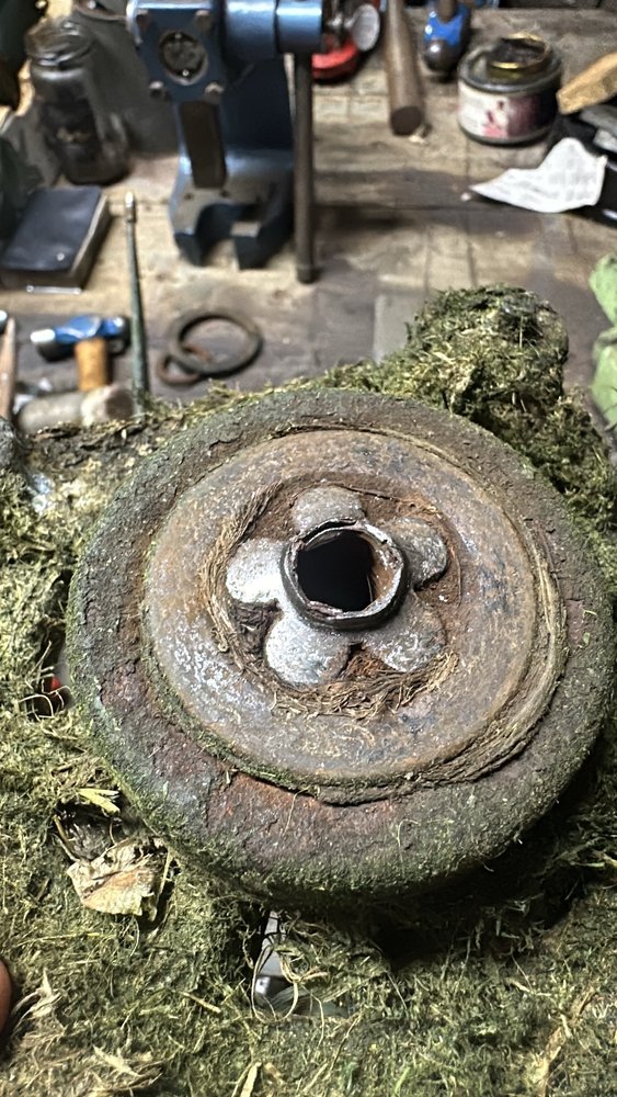

I don’t really like doing this but it’s the only way. I drilled beneath the depth of the head, then snapped an easy-out in two to make it shorter and fatter, this got the heads cracked and off the bodies. The pulley was corroded and mated to the flywheel.

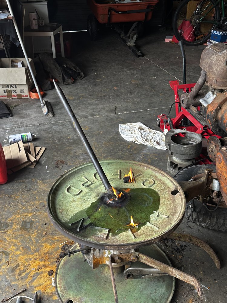

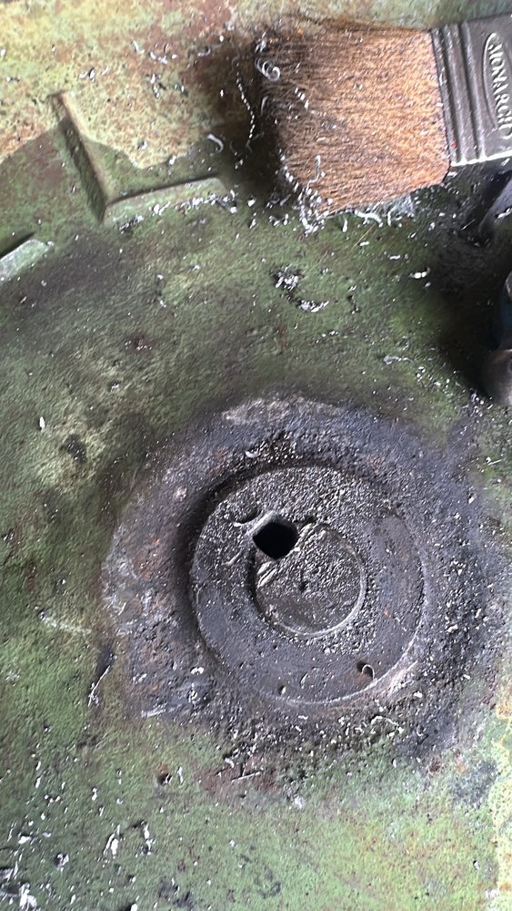

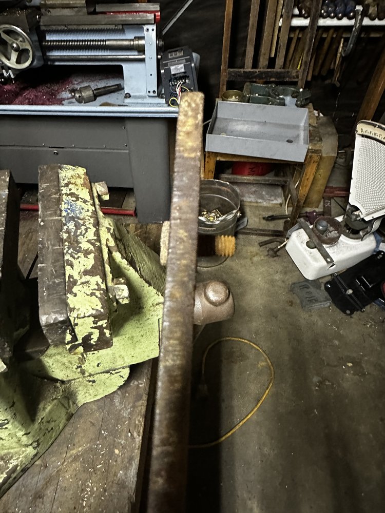

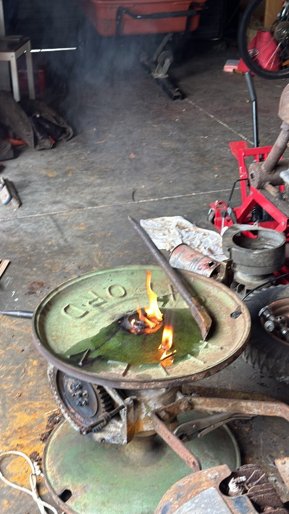

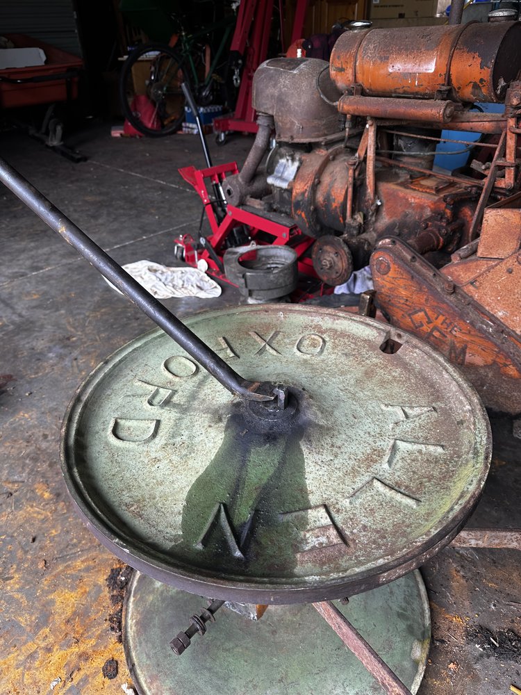

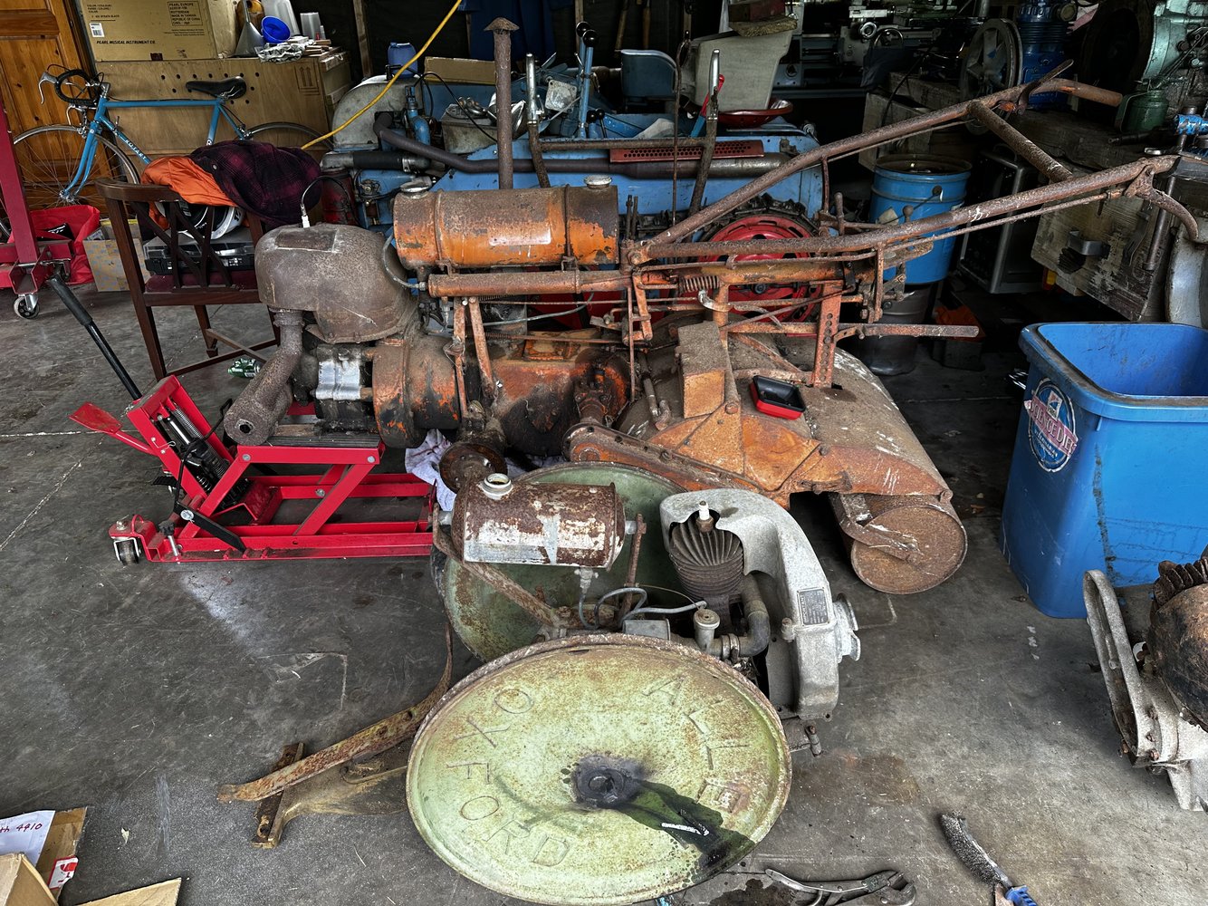

I’ve got no clue how I’m going to remove that centre nut, I’ve got the block strapped to the bench at the moment with a rod of alloy through the small end to stop it moving, obviously I don’t want to exert huge forces on it as I fear the small end will crack before the rusted nut goes, at least I’ve got access to it now.
