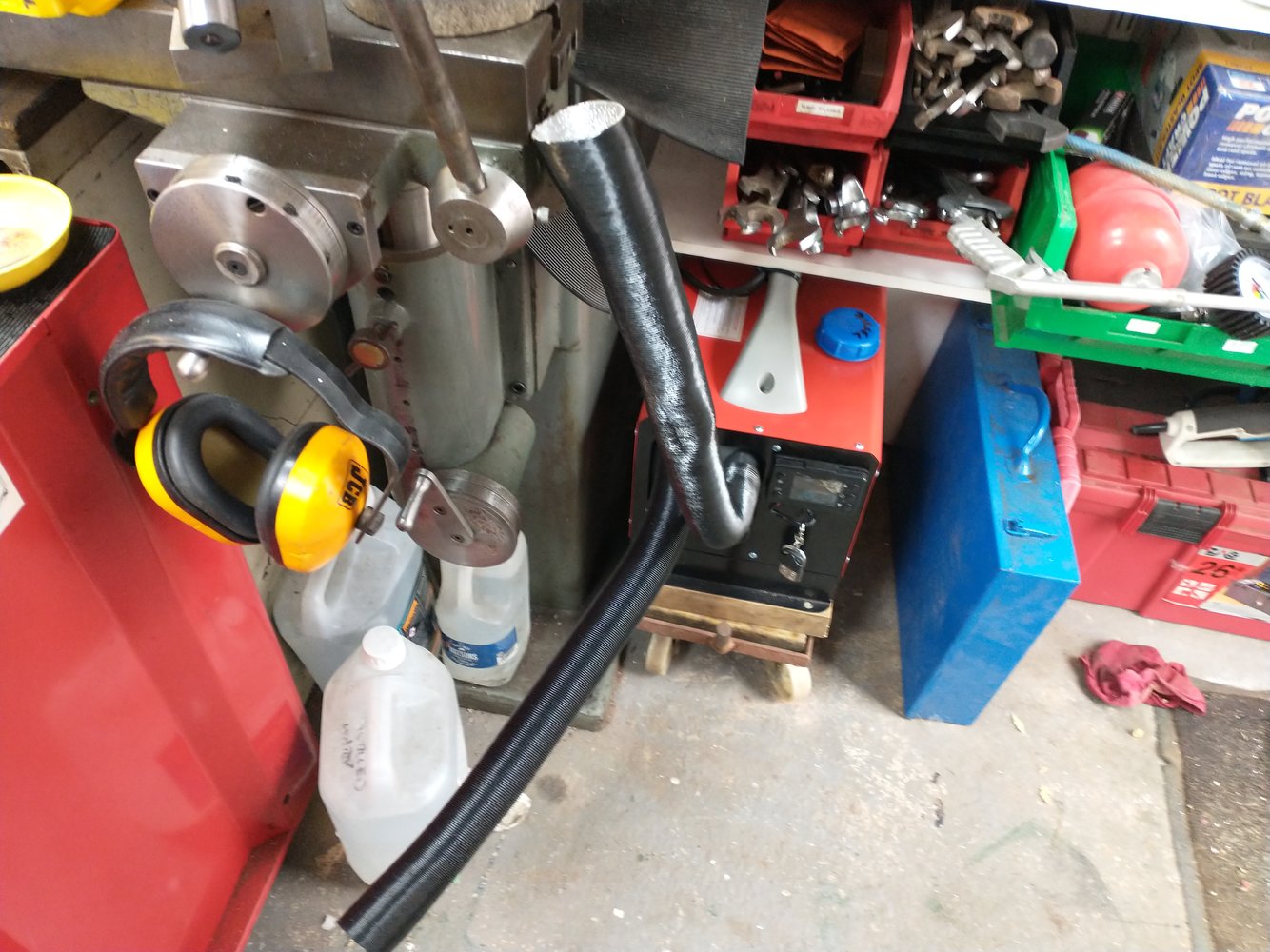

Condensation could cause problems with the burner if the exhaust went upwards. This would probably be most problematic during start up in cold weather. The exhaust gets hot enough to cause burns in normal operation.The exhausts on these Chinese heaters, does it always have to run downhill? Or could it go up a couple of foot above the heater?

Exactly what I suspected.Condensation could cause problems with the burner if the exhaust went upwards. This would probably be most problematic during start up in cold weather. The exhaust gets hot enough to cause burns in normal operation.

I wanted to put one low down, as heat rises, but my workshop is partly below outside ground level. Means it would have to live at bench height, or at the wrong end of the building.
The heater output is fan driven, so the unit could be put at bench height and the hose outlet placed at ground level. The hot air flow rate would be lower than having the heater at floor level, but not by much.Exactly what I suspected.

TBH you'll probably need to service it from time to time so accessible is better anyway.Yes, the heat can be ducted, I have the perfect floor space for it though but it's not going to work.
I'd have to find somewhere to have it on a shelf. No big deal I guess.
They can go up. We do it on boats through a skin fitting as they’re usually in the engine room below water level.The exhausts on these Chinese heaters, does it always have to run downhill? Or could it go up a couple of foot above the heater?
