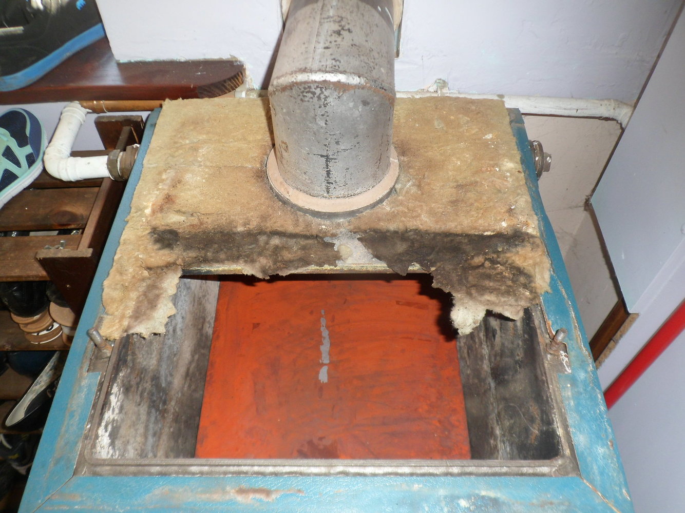

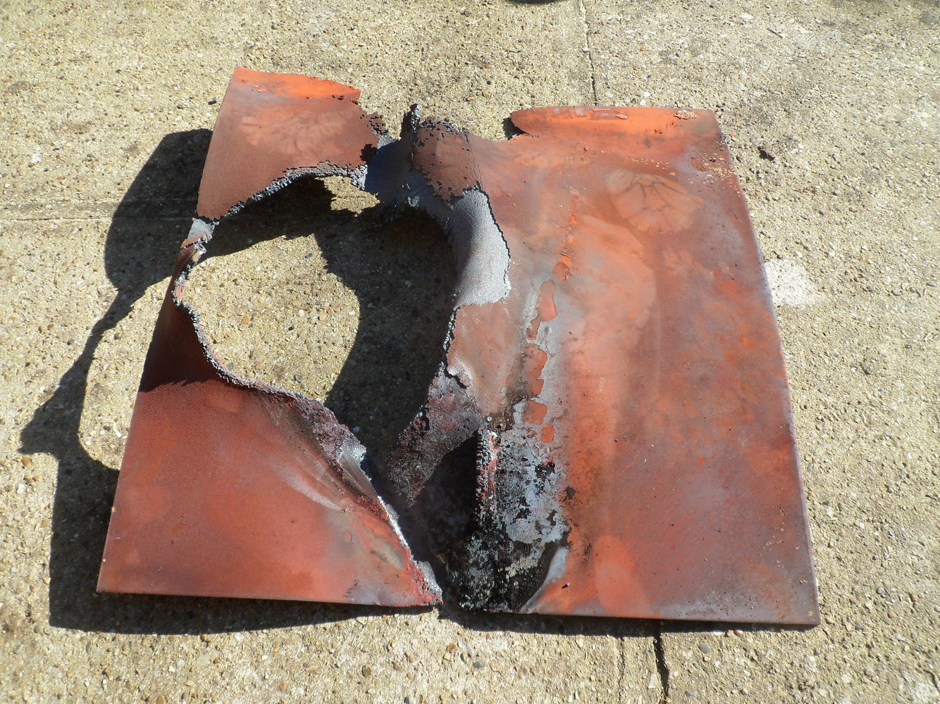

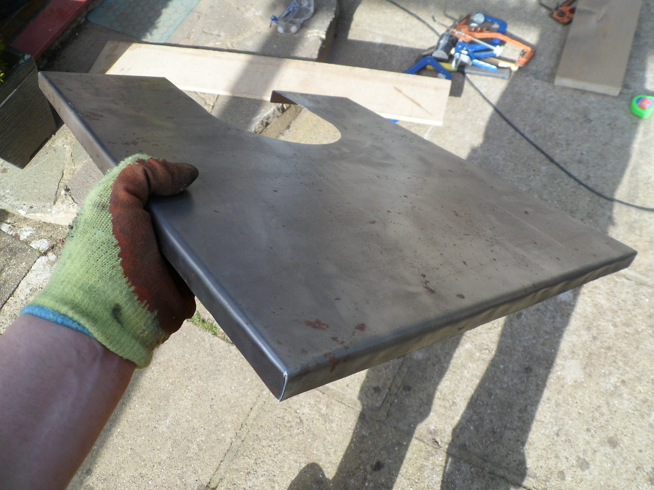

I will get onto this in the summer!I would. Mine was in a shocking state. Had to make a new baffle, new lid, replace the top insulation, the gasket between burner and firebox etc.
