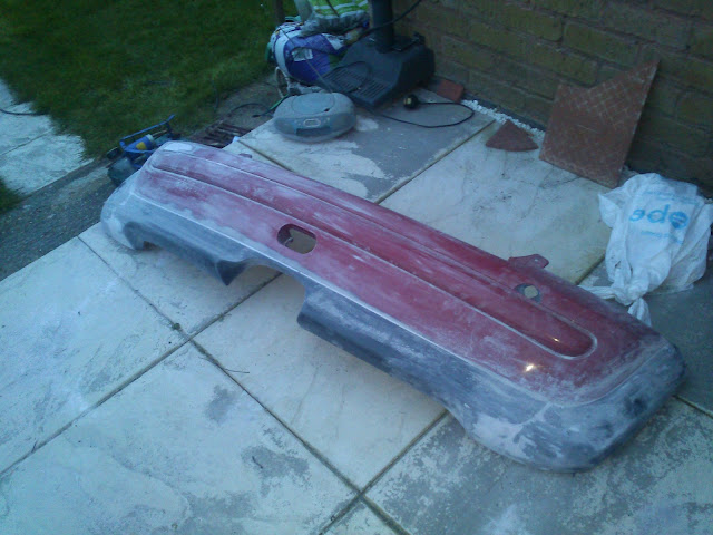

Finally I feel like I am actually getting somewhere with the bumper, been making some intensive mods to the bumper but I am really happy with it now. Stock grills are all going too. I think its looking very good
I had yes, we actually looked at it and tacked a few panels together on another car, sadly it offered less of a benefit. The new mini engine is mainly a front access affair.
I am suffering with having enough of changes and just want parts that fit. Worst part is most people will not even appreciate the changes I am making. I hope that all the changes are second glance or look OEM so they will not be able to identify what is different
This will be the last time in a while you will see the bumpers, they are off to the body shop in the morning and I am very pleased with how they look. So this is the front and rear bumper that will be going on the car. All the grills fit really well, as they should!

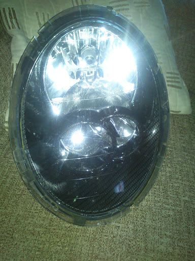

I tried so hard to get the insides of my lights done in carbon, got a good finish but when I came to assembly them they would not fit so to ebay I went, purchased new front and rear lights to start again.
I then came across a method of applying patterns called hydro dipping and with a call to www.pitstopdesigns.co.uk I had decided that only way to get the carbon on the inside of my headlights was to have the chrome "dipped"
I pulled the lights apart and sent them off with samples of the carbon so it would be close, I know its not real but close enough.
Well one week later I have them back! I have to say inside the lenses they are going to look very good, the finish is good and is very close to the carbon so will help to carry on my carbon theme, I can now spend a wet evening putting the lights back together.

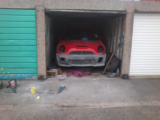

so this roof skin... Well after having already done this and paid someone in good faith to do a good job and they did a very bad job I just couldn't save the grp roof which had been made so out with the angle grinder and I removed all the rubbish, I then spent some time with my other half built a wooden table within the car just below the roof skin and then placed some large block of foam on the car. I then set about cutting and roughing out the foam. took me about a half a day but the shape is back now so with some filling and smoothing I will be able to make a new mould and then a new roof and thats it the car will be in for paint.
