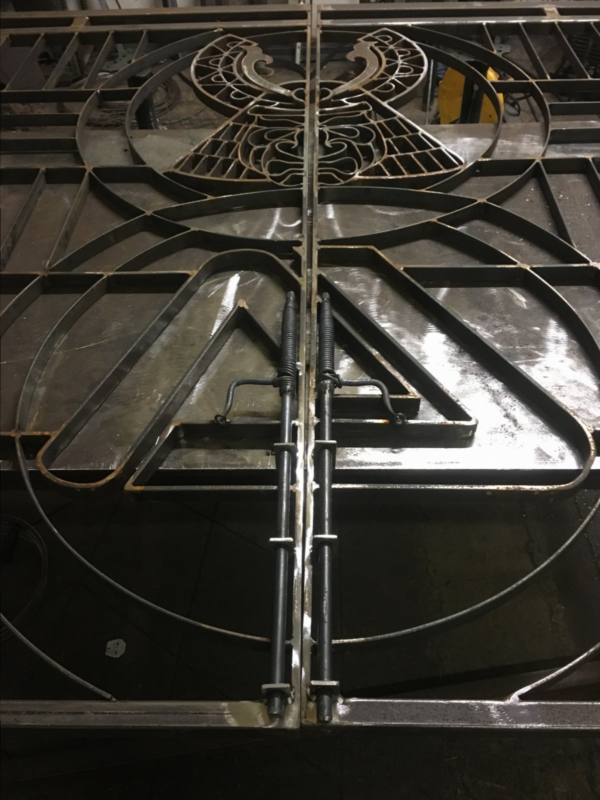

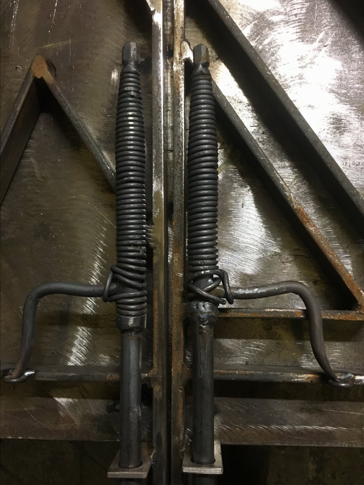

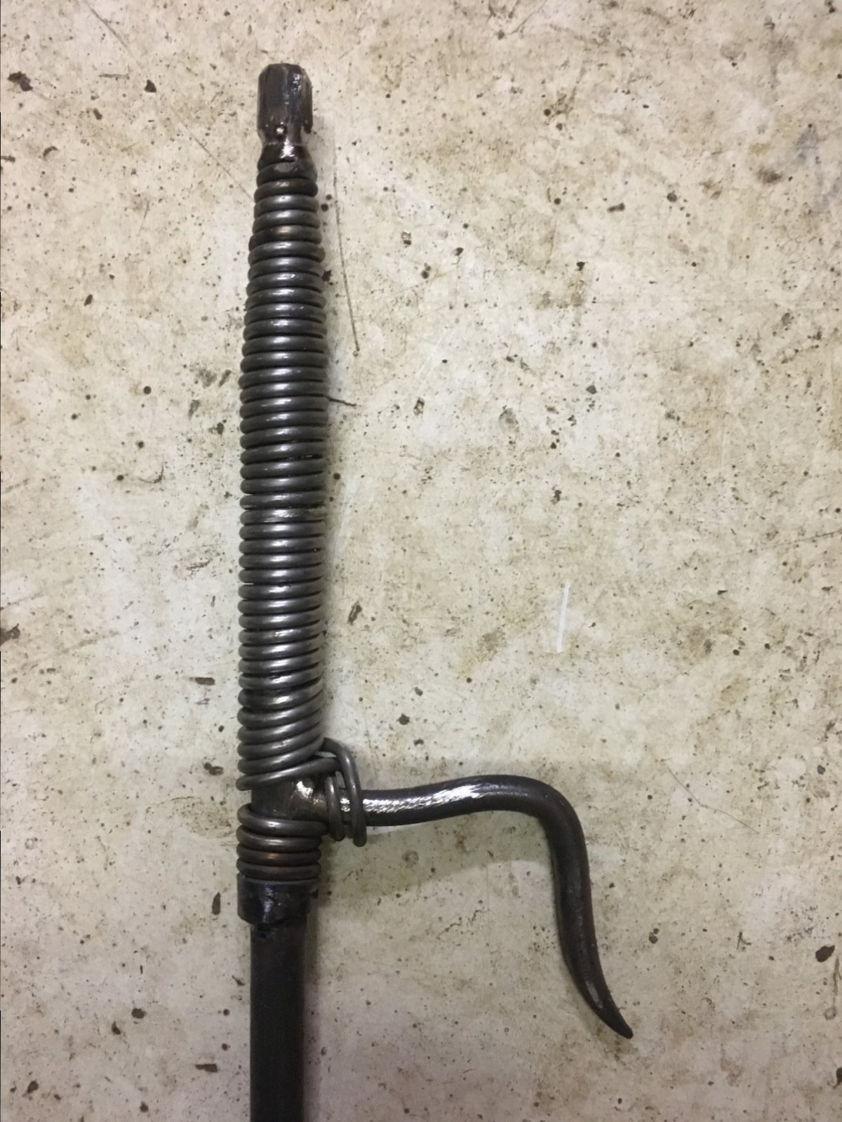

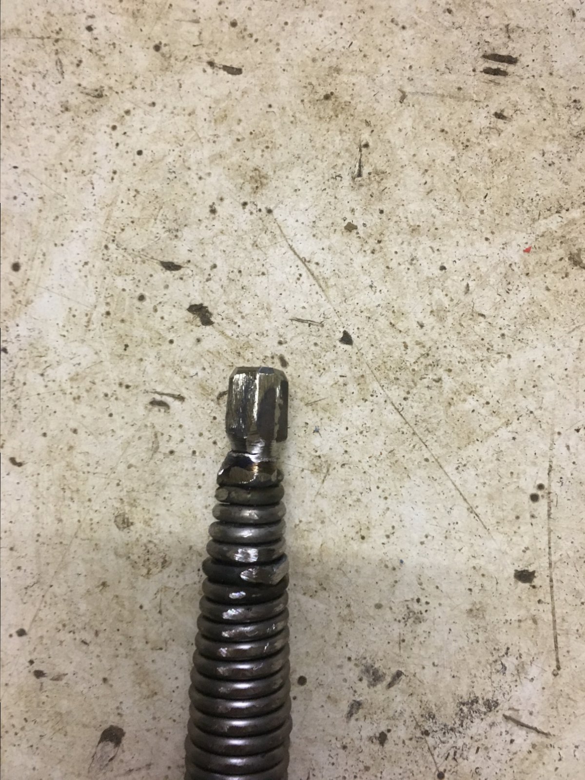

Good evening all. How's your weeks going? Mines been slower that I'd like but I've made progress in a few areas. I've finished the gate today. I decided to go ahead and make the Sai drop bolts. I'm pretty happy with them and think they finish off the gate nicely. I made the drop bolts from 16mm black round. I fired up the forge to tapper the end of the handle. I left a section at the end of the handle to forge into a octagonal shape at the end of the tapper. Then wrapped the handle in 4mm bright round.
With regards to the security. It is something I was Waitrose about. I got some security sleeves which I'll spotweld to the pin. That way they need a grinder to cut it off.
