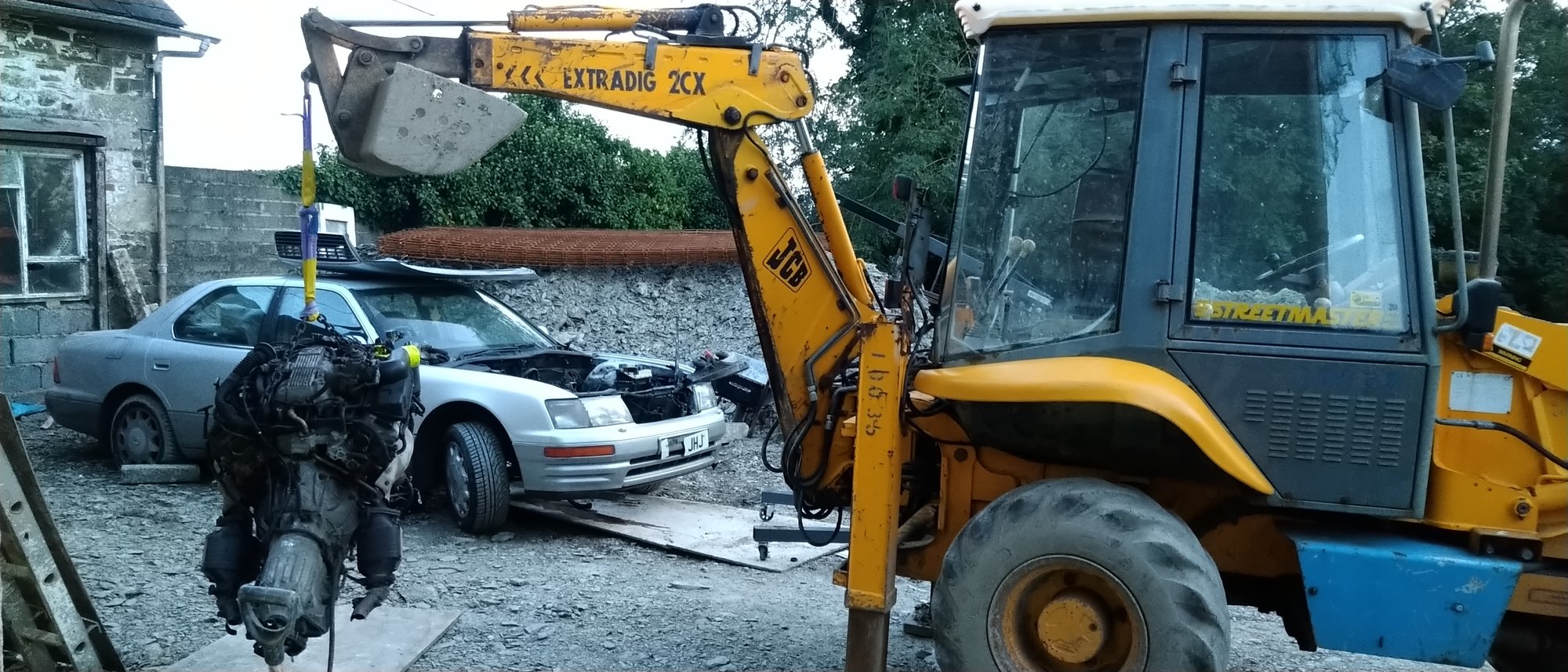

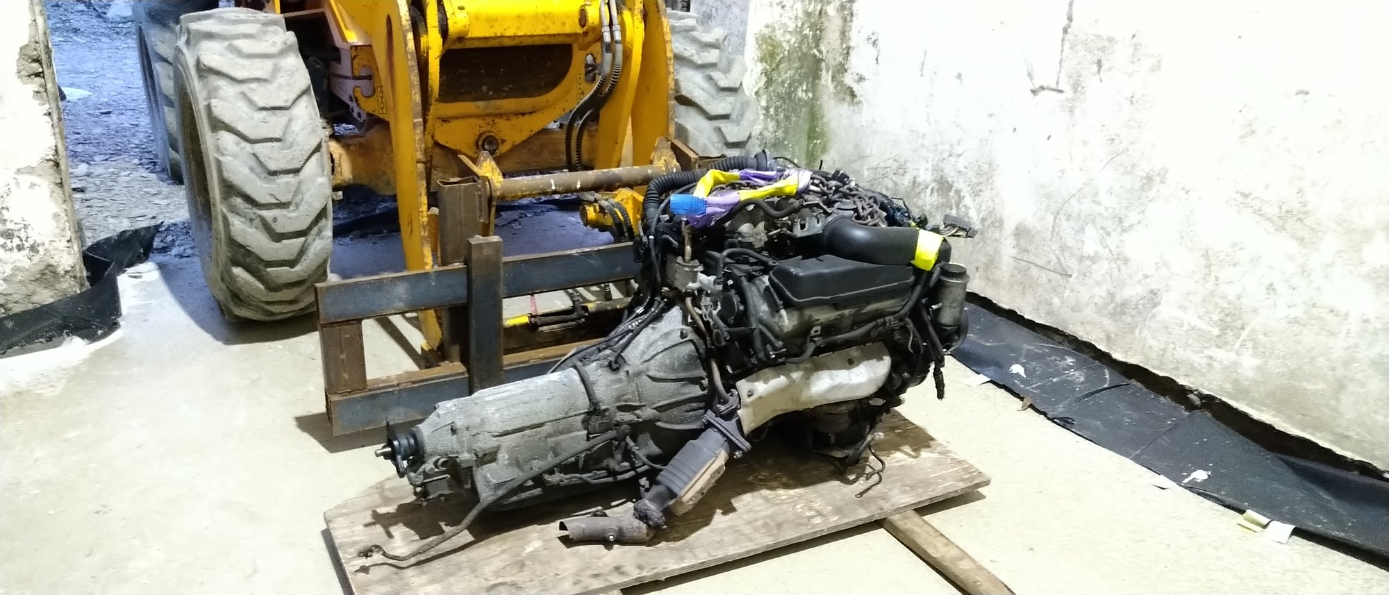

Needed a bigger engine crane to lift it out of the engine bay in one piece

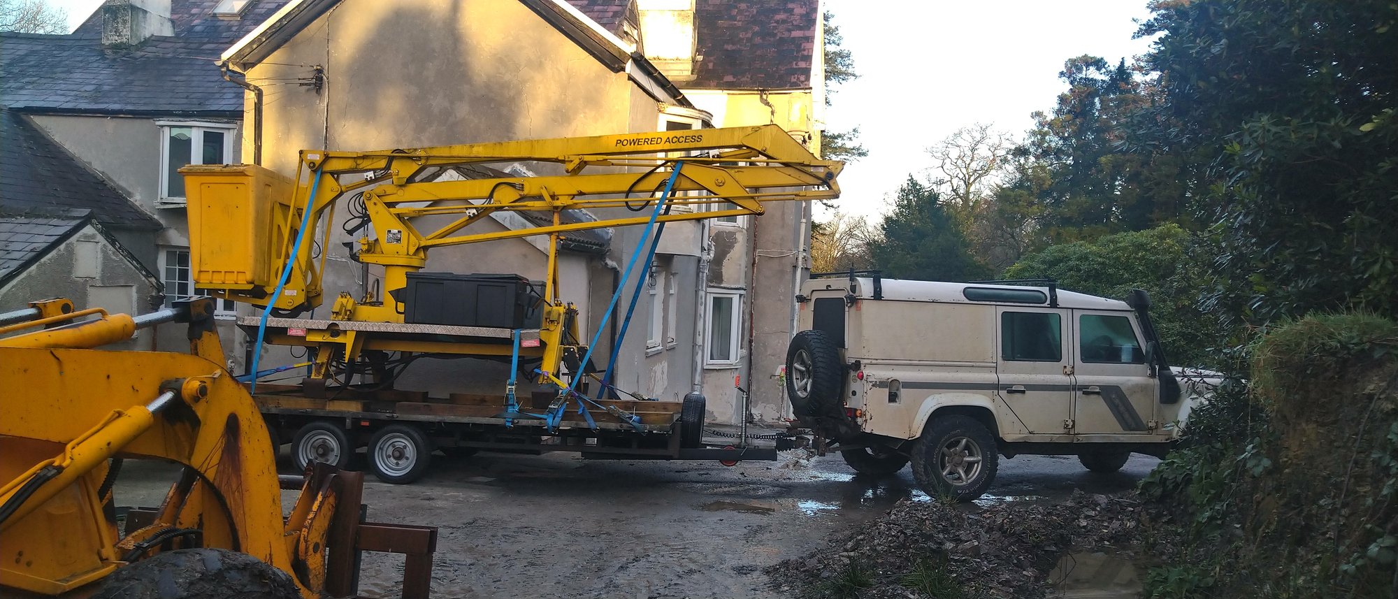

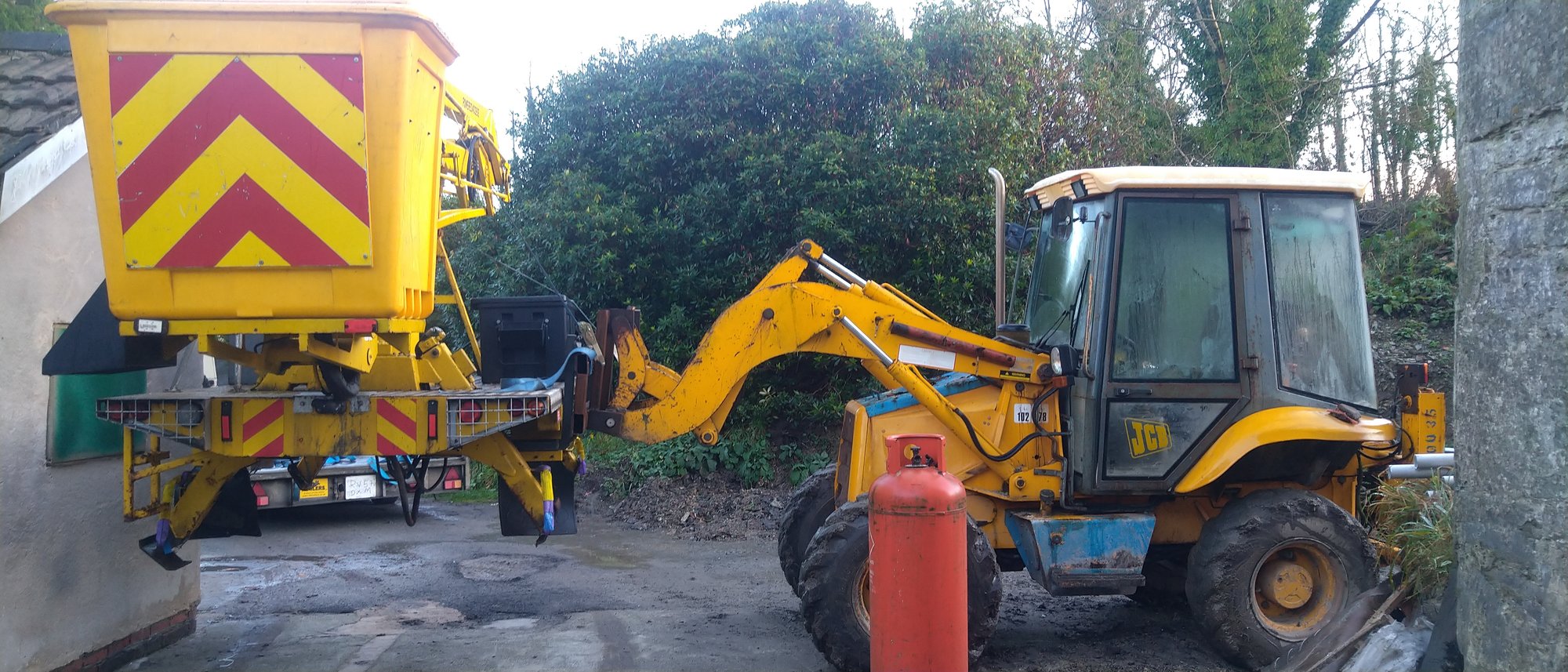

He's also a tight fisted b****** so haggled when he got there and got a decent amount of money off what was already a bargain.

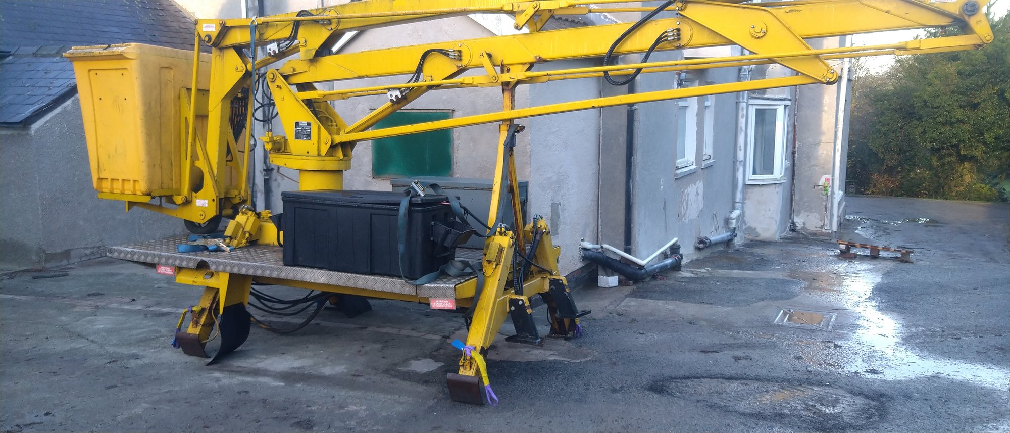

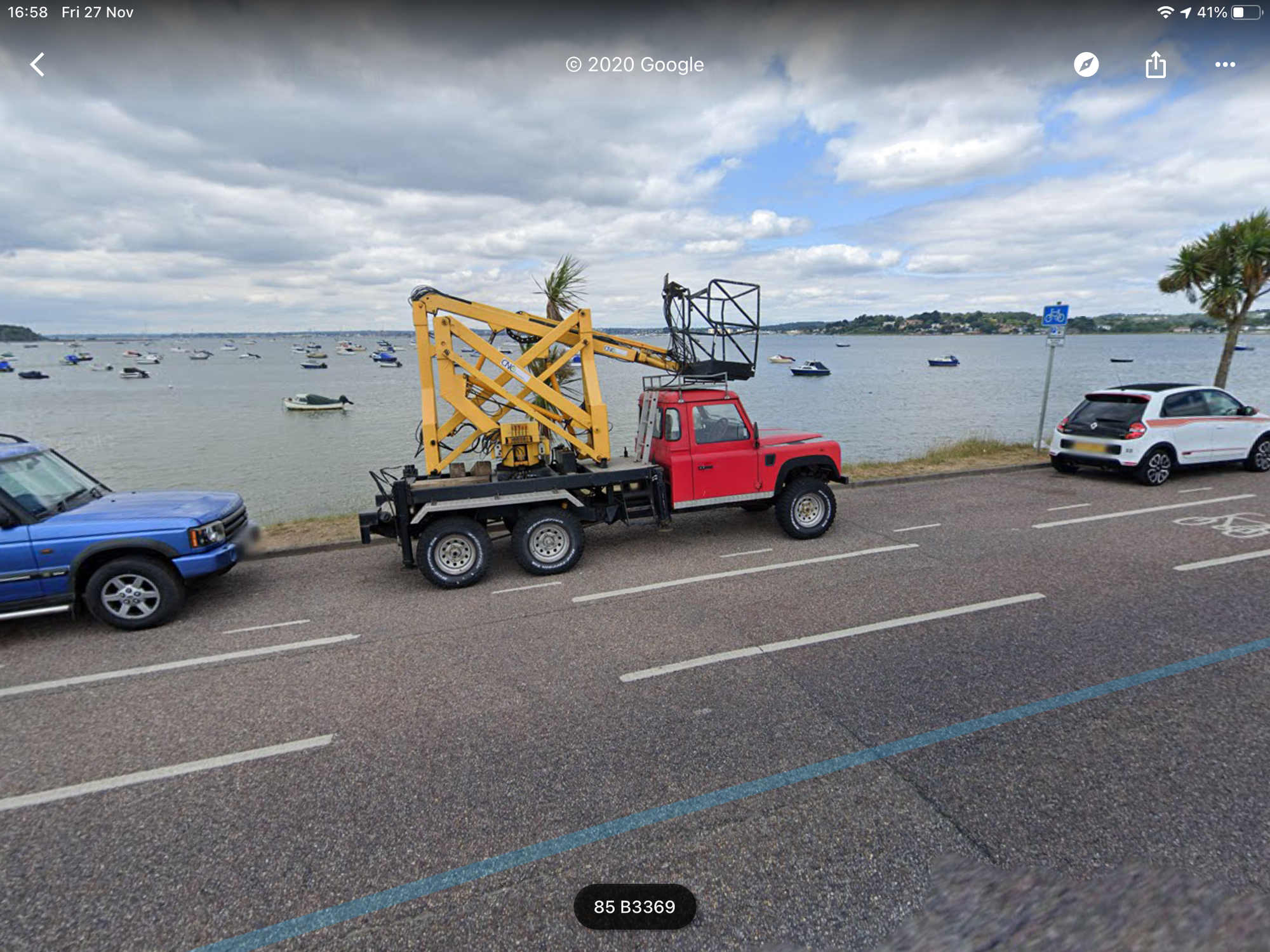

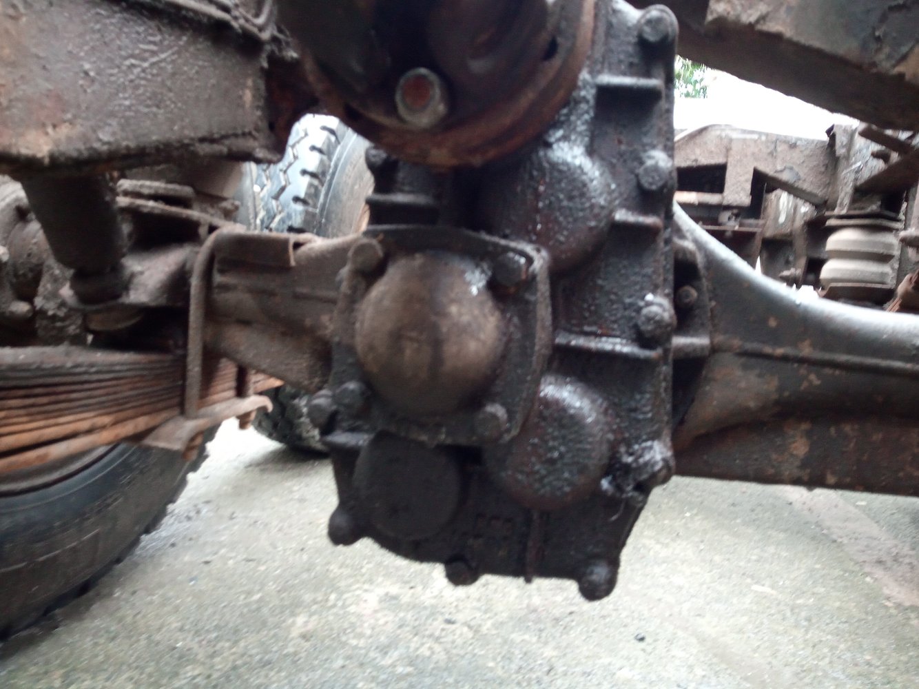

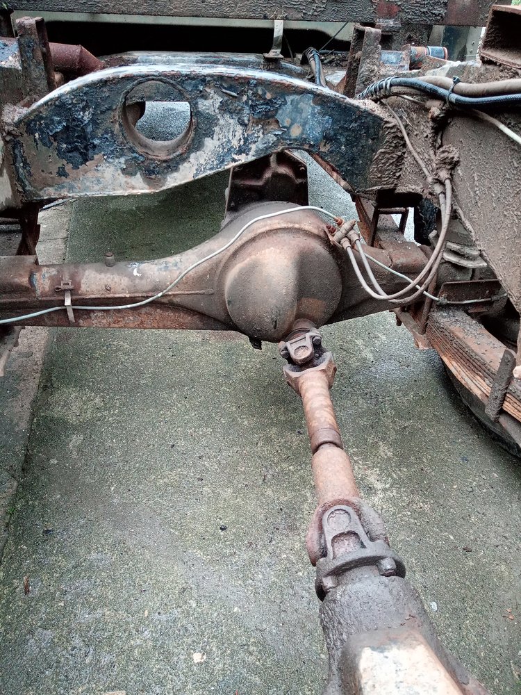

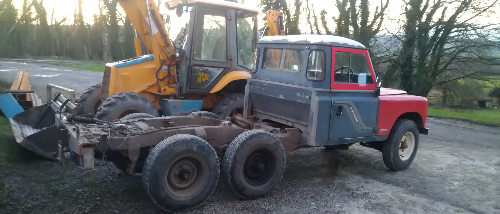

Doesn't look like a Sandringham - looks like someone's just bolted on an extra axle to a 130 in order to support the cherry picker.
In fact it looks very similar (the dodgy drivetrain) to one that @stuvy and I were discussing in PMs). The lack of apparent drive to the rear axle and the trailing arms looks suspiciously similar.

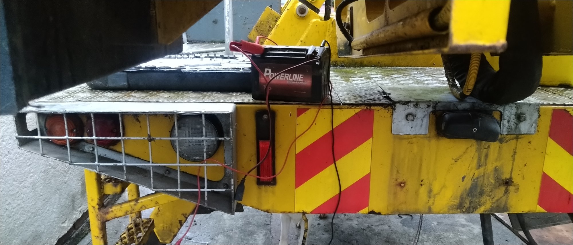

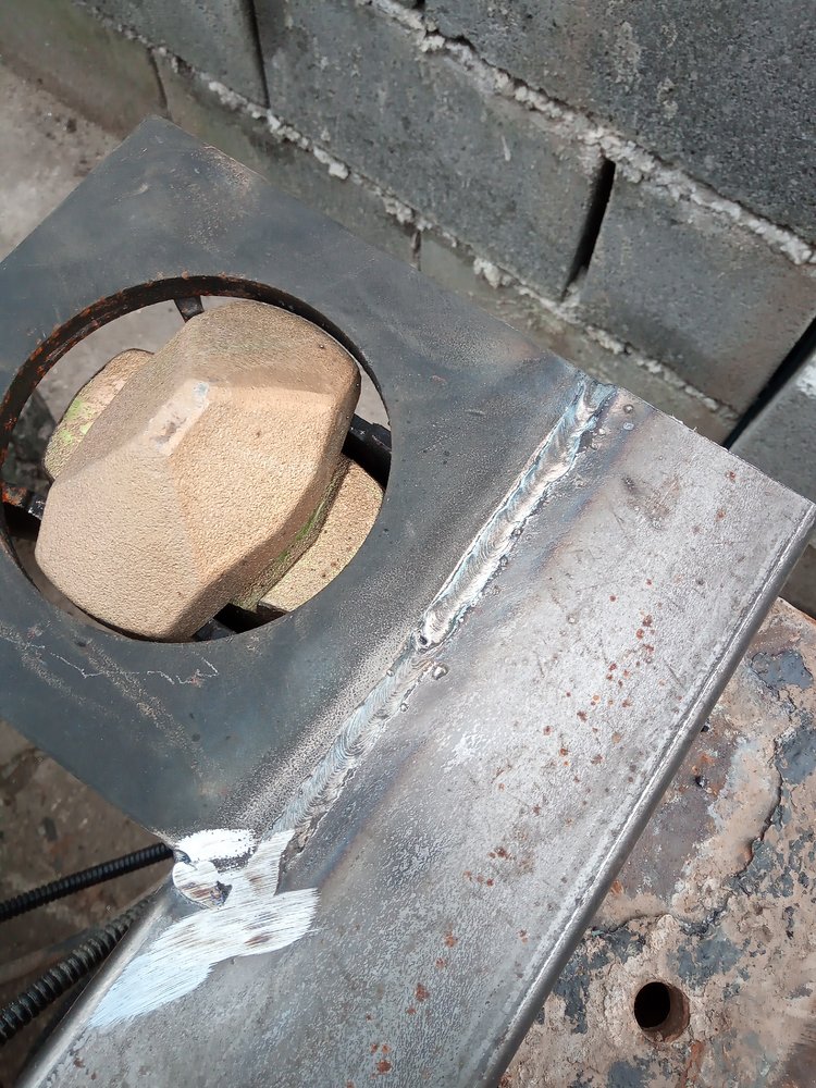

Did chamfer the plate on the top of the twist lock and took off paint near it. Mill scale was cleaned back but only with a slightly tired wire wheel rather than flap disc.
It was sticked / stuck rather than migged. Big question is does @8ob think I've taken his lesson on board?
Good enough for me!Ed it looks ok on google earth

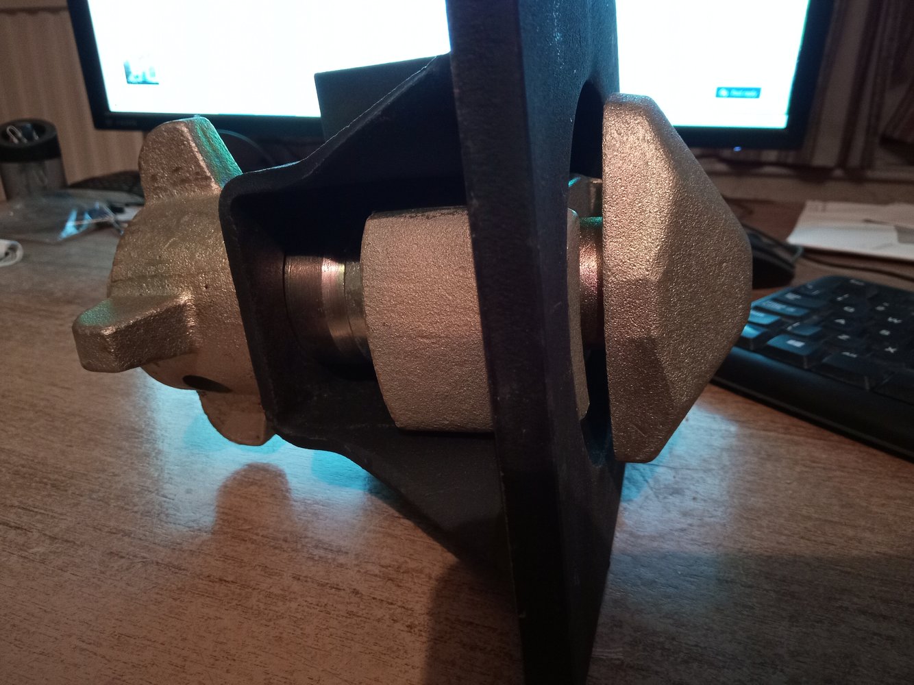

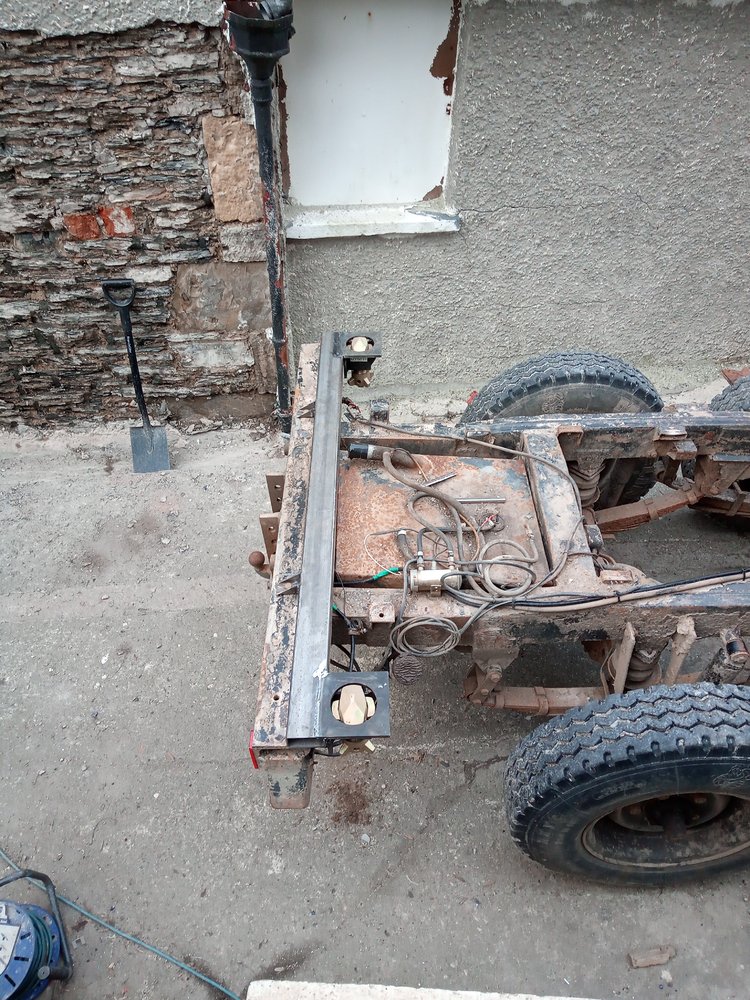

My initial thoughts were I haven't got a clue - thought I had it figured out but that made no sense (thought it was for assembly / replacing parts due to the roll pins used to lock bits together).Why the big circular hole Ed? both parts of the twist lock should pass up through a hole the same shape as the lock.
10mm plate at the container twist lock point sounds about right.Good enough for me!
It has made me wonder whether these are meant to be welded underneath the "bed" so to speak because with the thread done all the way up there's a ~8mm gap between the head of the lock and the plate - which means you need at least 10mm plate (no bad thing) to form the other half on the "container".
What I'm thinking is should this be the "unlocked" position with it welded from underneath the bed, then when you twist the lock 90° so the top is aligned over the bottom half it's now clamping against itself rather than empty space as it would in the current position.
When they arrived I was slightly surprised that the head didn't retract any further down into the slot that's been cast. Given this is for bodies that weigh less than an empty 40ft container I'm not overly concerned.
