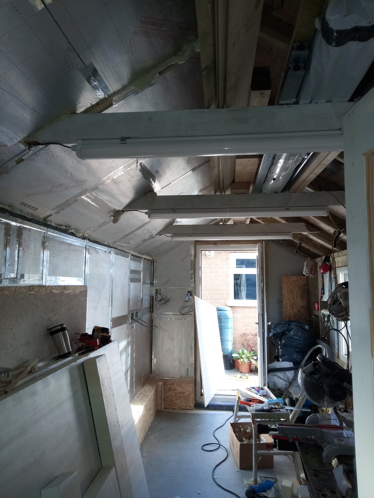

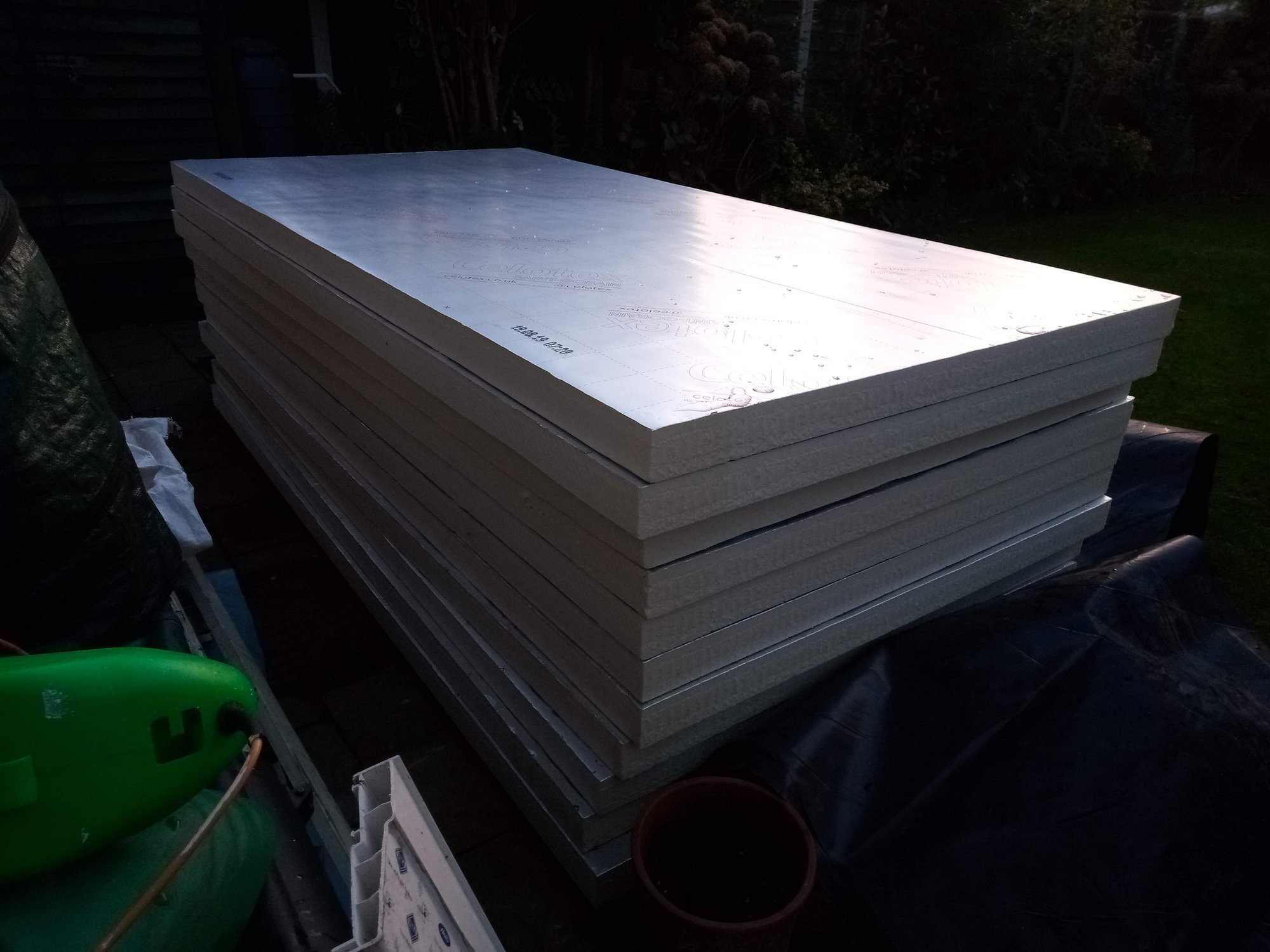

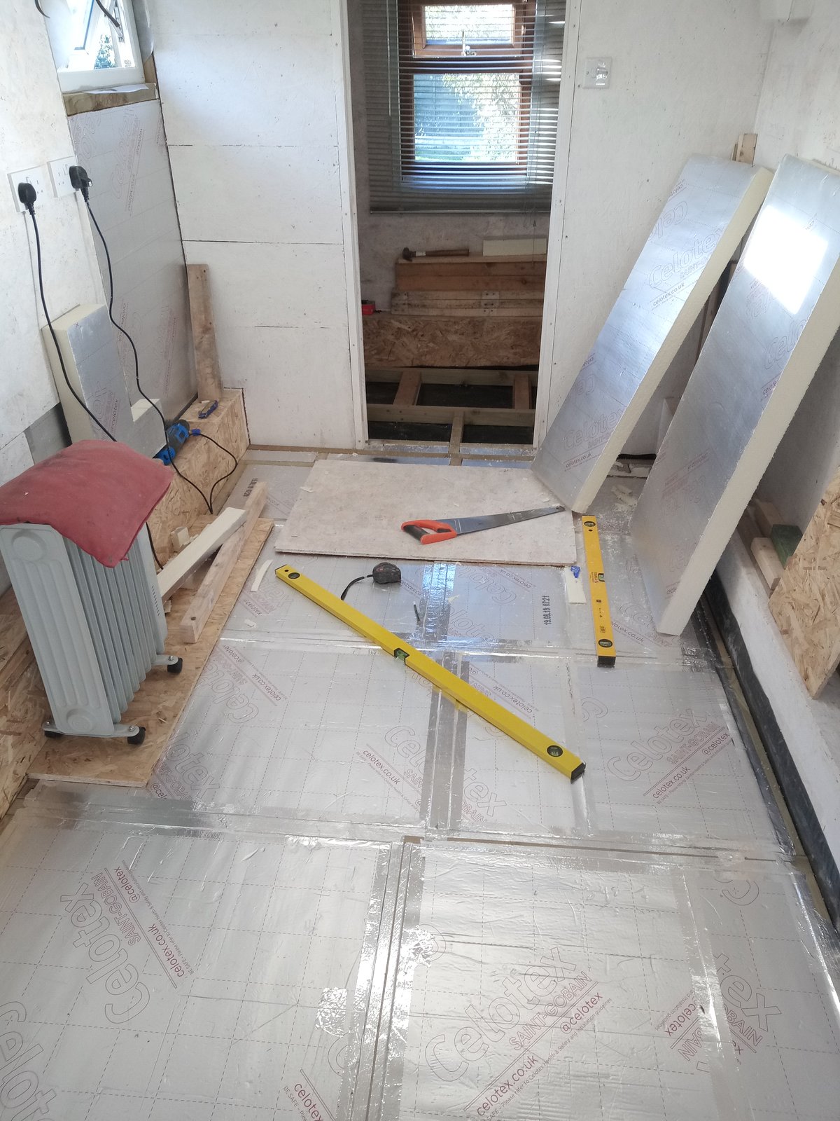

Pushing it along as much as I can as I'm not good in cold frosty weather. 16 sheet of Insulation is going in now so won't be much longer before I'm done then I can move on with the boarding of the walls and ceiling.

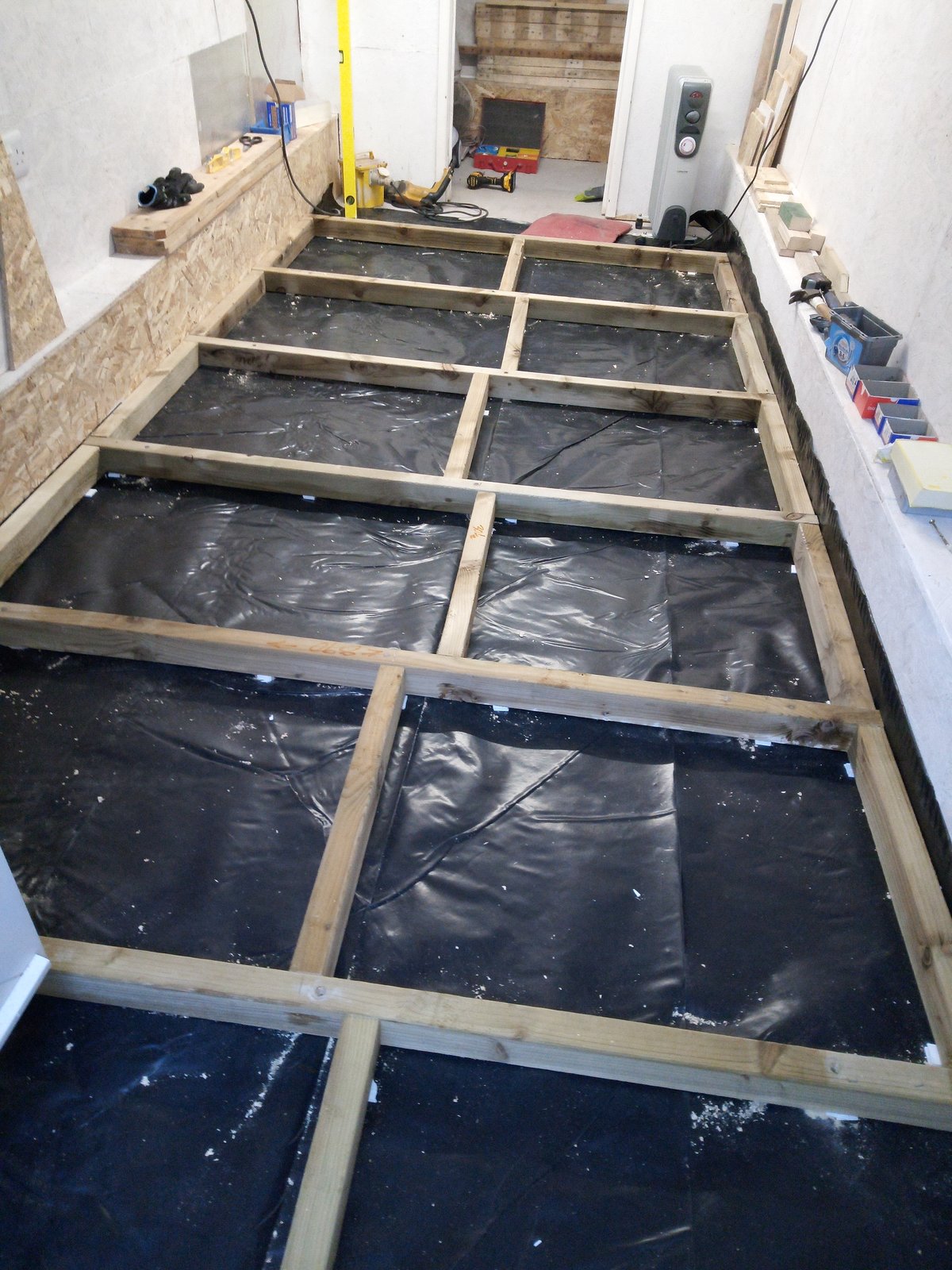

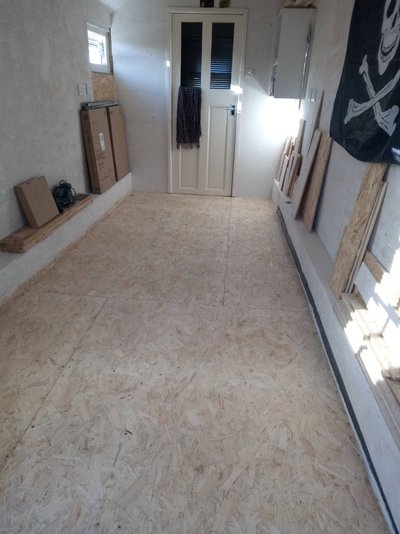

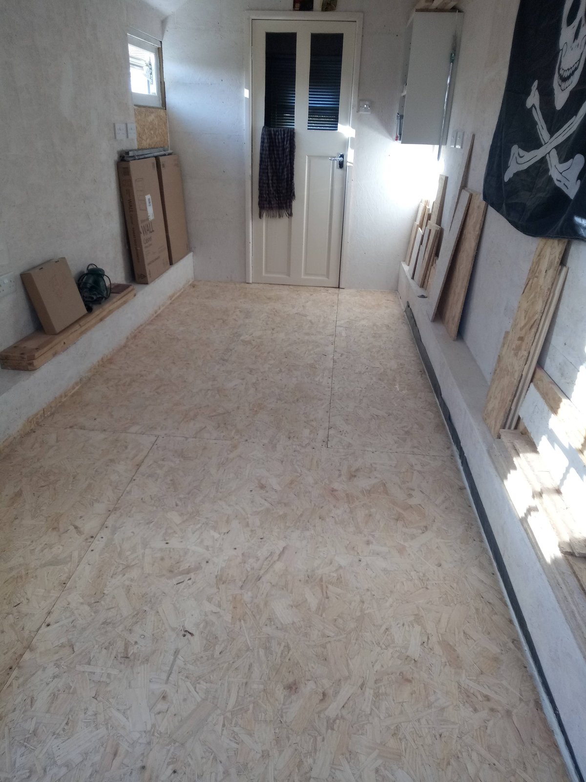

Update on floor . Used dpm with treated 3x2 timber then 70mm insulation that will be followed by 18mm osb3 . The floor is an early photo before I added more 3x2 .

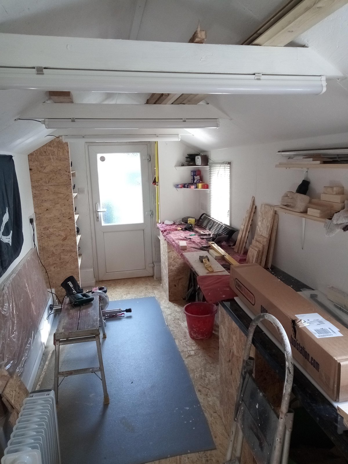

while we are on this subject i noticed you got an oil heater in ther whats the temps like in there but you wont really know if it can cope unless we have a really cold snap

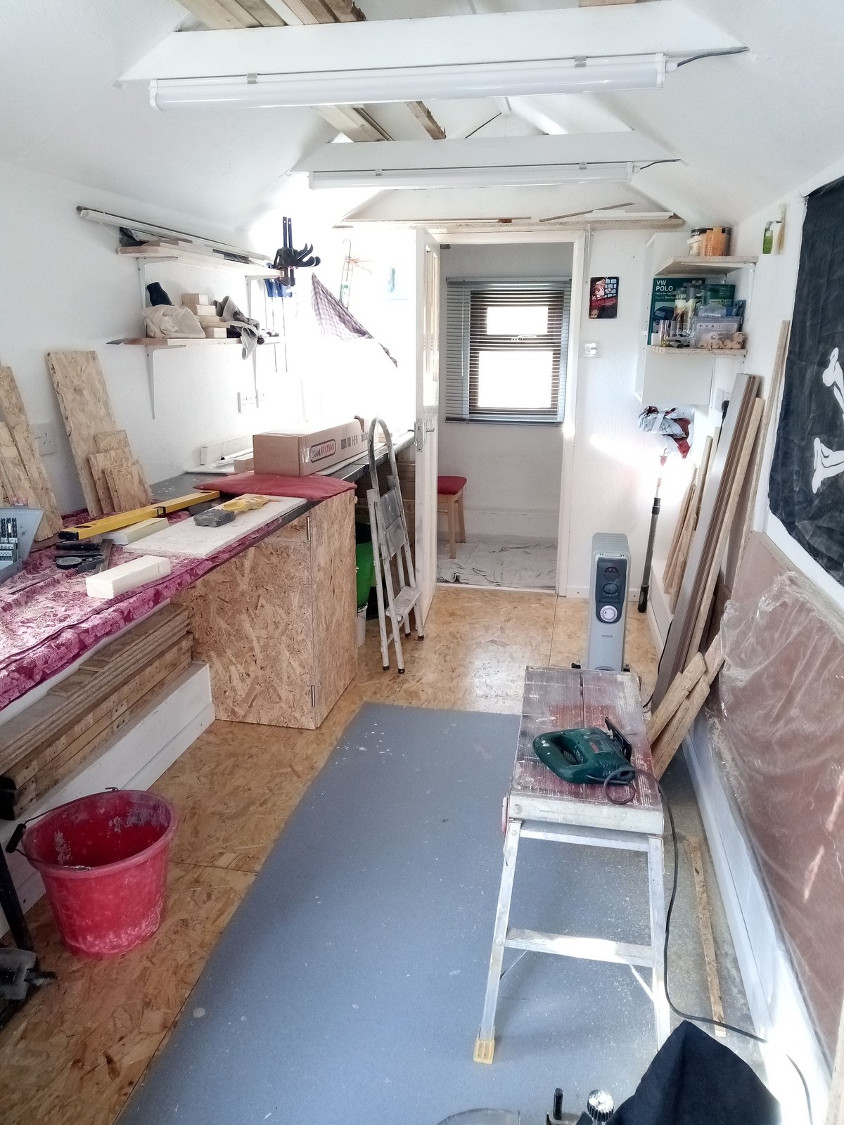

Small room is for my son I'm setting up PS4 and TV for him and tea facilities for me. Door will be fitted soon.
Oil heater is great but does get rather hot so I really need to turn the stat down. It has a timer so it's set to come on early so warmed when I enter.
Room holds heat well and I'm pleased I made effort to insulated floor walls and roof.

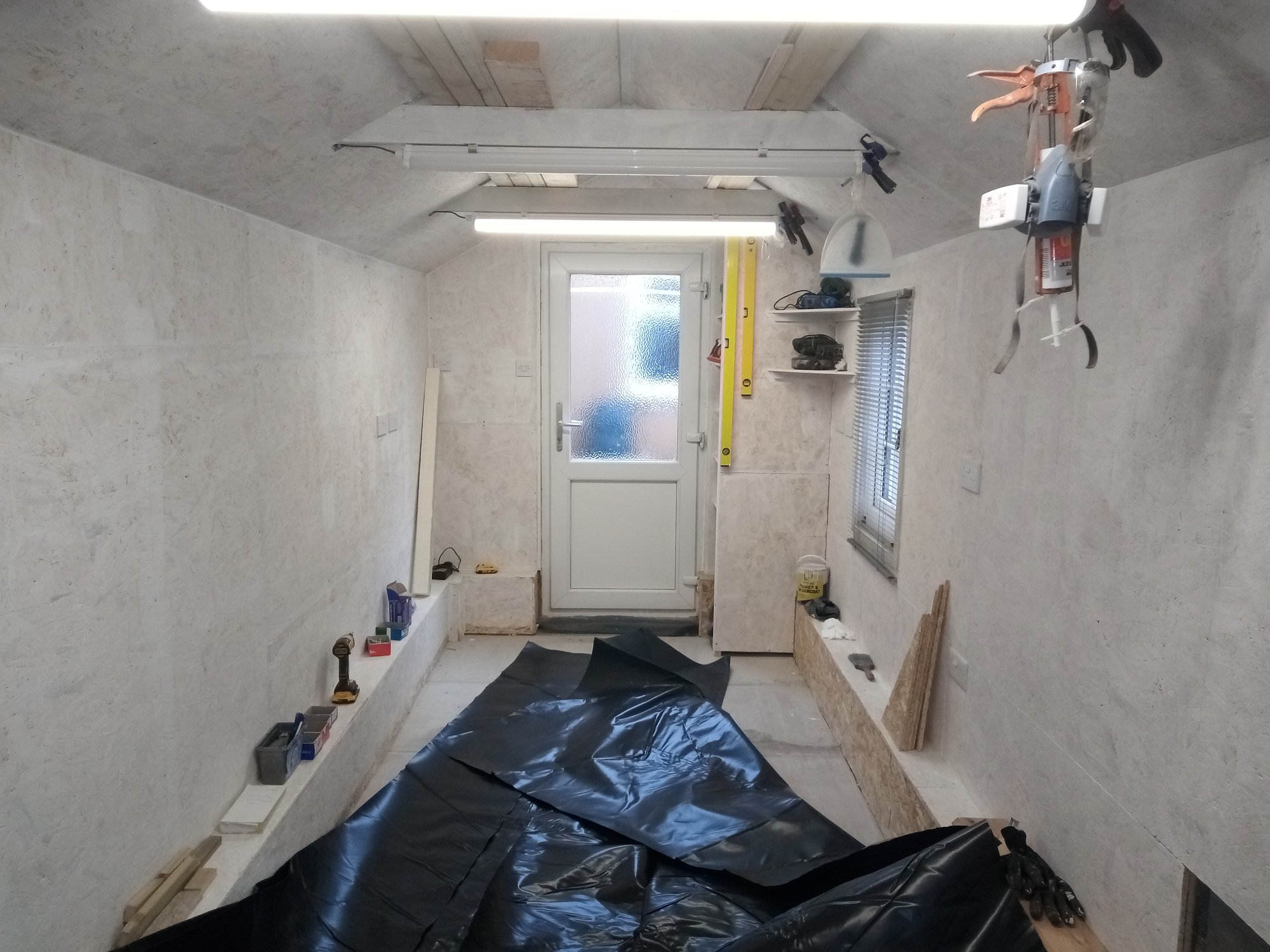

It has 3 windows and one door with glass and a separate section at the end with the door you can see in the photo.
I have 3 strip LEDs in main area that are not on in the photo. You can have lights on independently . Four downlight LEDs in the little room at the end. Twelve double sockets and outside security light.
So far I am enjoying my time on the build . I have a oil radiator that's keeps me warm and can get away with just a t-shirt on .
Sorry just got carried away with welding the vw beetle. Yes it's good over the cold spell I had a little 2kw oil radiator and it keeps warm . I made more shelf's that are full with RC cars . I got a couple of body panels wings and bonnet in there at the moment that I sprayed ready for the other vw project .
