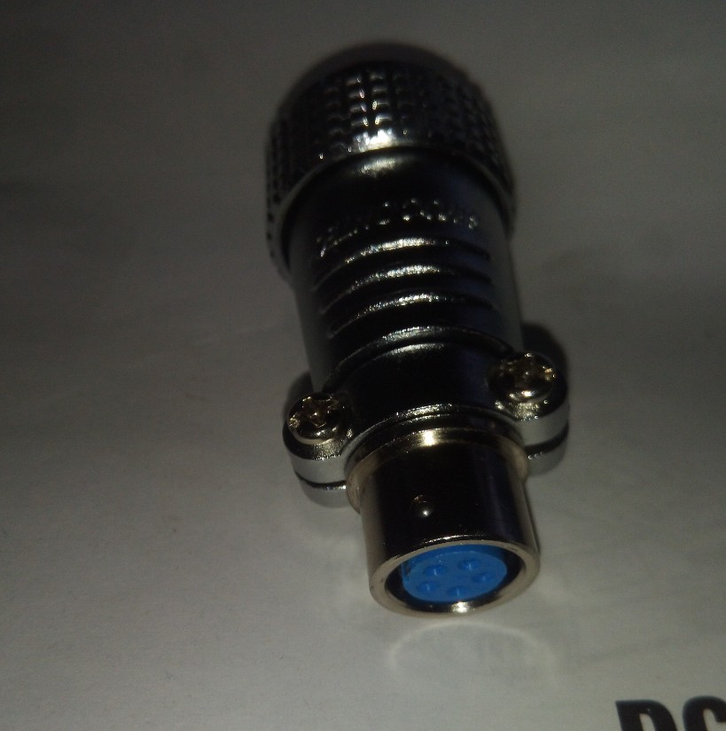

Since I got the plugs today I thought I might as well put them to use.
I have used a plug from the Stealth 320p and mated it to a socket from the ones I got today thus making an adapter for my WP20 if I wan't to connect it to the Stealth. I will also have to make another for connecting my WP18 torch so I can connect it to the Sherman if I want but will have to swap the plug on it to the same as the Sherman one first.
Anyway it works out quite nice seeing as the Sherman/Jasic socket is so small in comparison to the one on the Stealth.

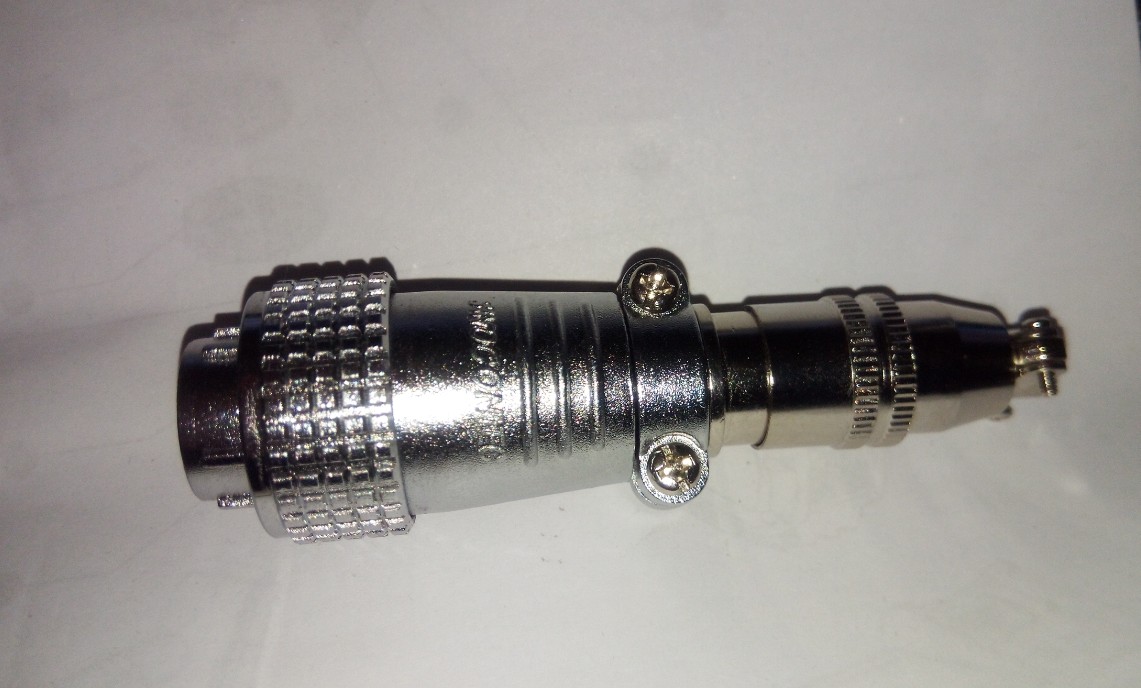

Screwed together.

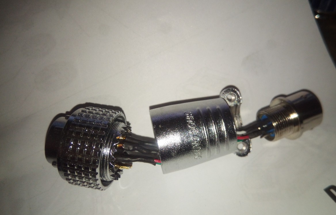

With a plug connected showing what it would look like when a torch is plugged in.
No idea what R-Tech use but if you are meaning the Stealth plug then it is a 12pin Sinocontec.That plug looks remarkably similar to the plugs that R-Tech use on their TIG machines...
