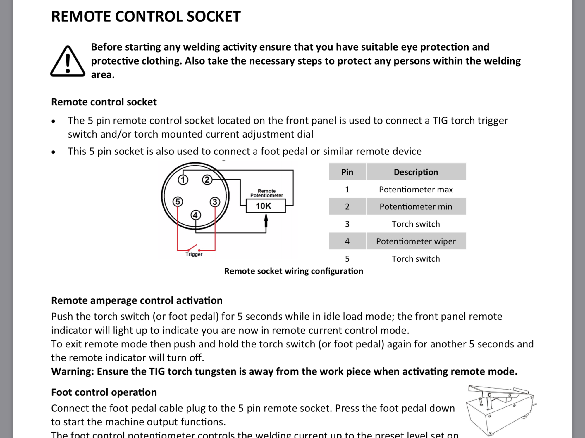

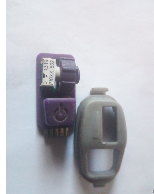

I just tried mine with the 5K pot when I nipped down to the workshop. Works fine except the max current I can get via the pot was about 190 Amps, min was 30 Amps. Maybe a 10K pot would make a difference but probably not.
I would like the values in the didplay to change if you don't weld

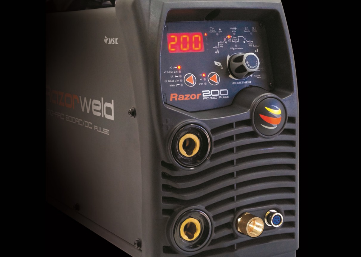

I don't have a Jasic so am unable to test but like you I suspect they don't.
The Razorweld manual seems to suggest that is the case as it says the display shows the max welding current but whether they are the same as the UK ones I have no idea, they are badged as Jasic though.

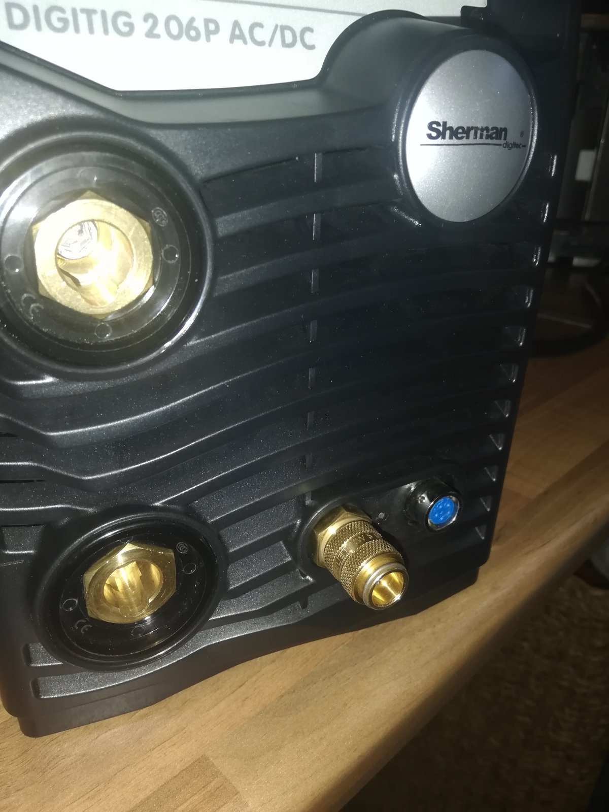

I note a lot of discussion around the weldes website.
Is there any reason not to buy the 206P via their ebay offer ?
Thanks
https://www.ebay.co.uk/itm/Sherman-...200312?hash=item342d3be8b8:g:JpIAAOSwZedeHxvR
