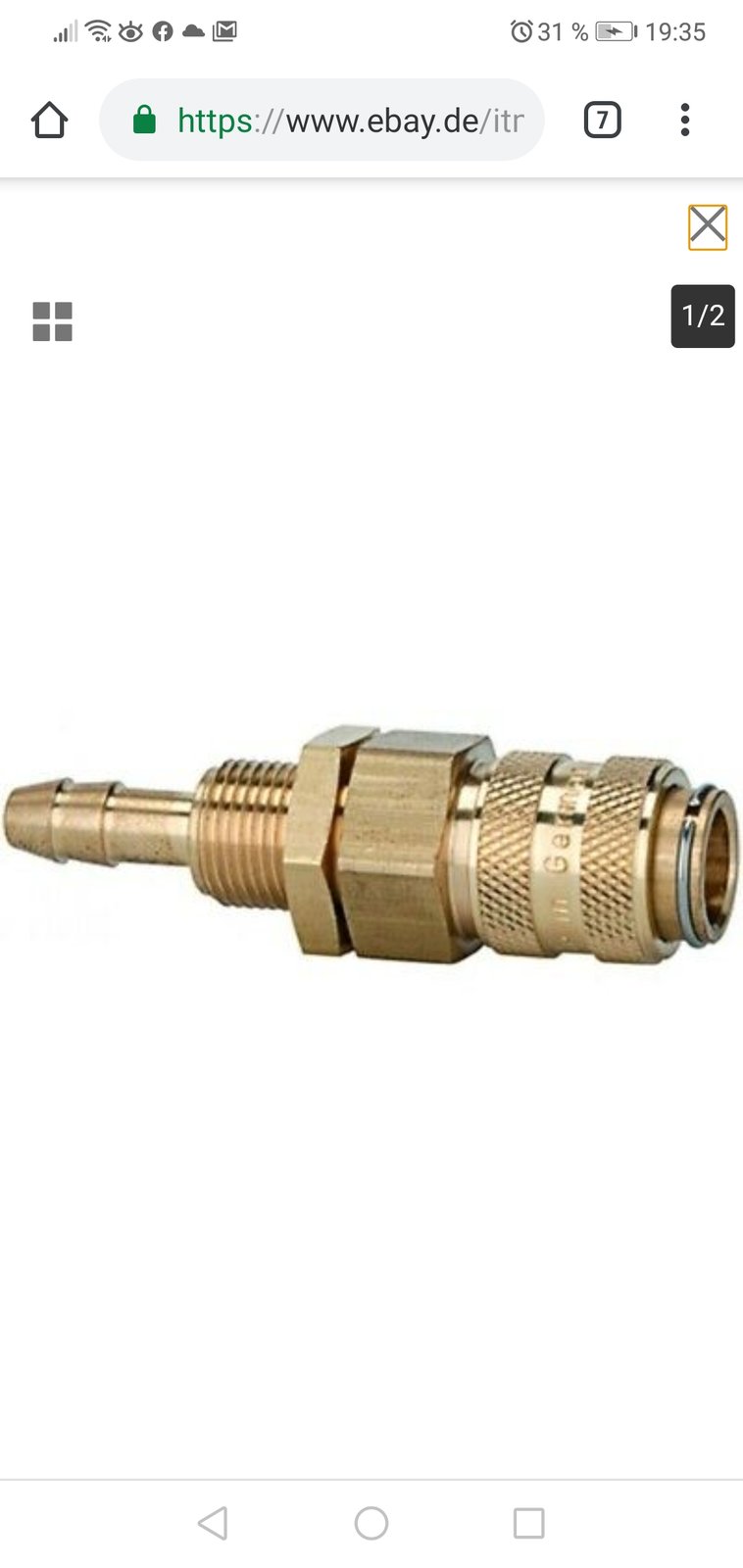

Don't suppose you can remember what the size of the gas tube was in the Sherman can you?
Aye but is it 6 or 8mm ? Would have a look myself but working away at the moment.I had a quick look when I first got mine to see how easy it would be to replace the M10 gas connector with a Rectus 21 type coupling in the front panel (as per the UK Jasic one).
From memory ( not the most reliable ;-) ), the tube was rigid nylon and the other side of the M10 bulkhead gas connector was of the push in pneumatic type.

Think you used a barbed fitting though? Pushfit pipe is sized on outside diameter.I have 6mm and had to cleverly heat it, it would be 4mm
More or less, I was going to go for one of these types.Think you used a barbed fitting though? Pushfit pipe is sized on outside diameter.
Guessing Mr Hood is after using something like this
https://www.ebay.co.uk/itm/153224568598
But in a bulkhead fitting flavour
Aye that is a bulkhead with a hose tail.I have this one, sorry i dont know the English word for it
Yes! This! Haha! I had spotted this myself and forgot to mention it. I had to swap out the plug (I got the 17 so it had a 10/25 plug). In fact, I note you did too - have you got a 35/50 plug too?I just got the torch out to have a look at it - branded Kennedy on the torch itself, but I looked at the dinse plug and it has ‘Sherman’ moulded into the rubber shroud - exactly the same lettering style as on the side of the welder.
