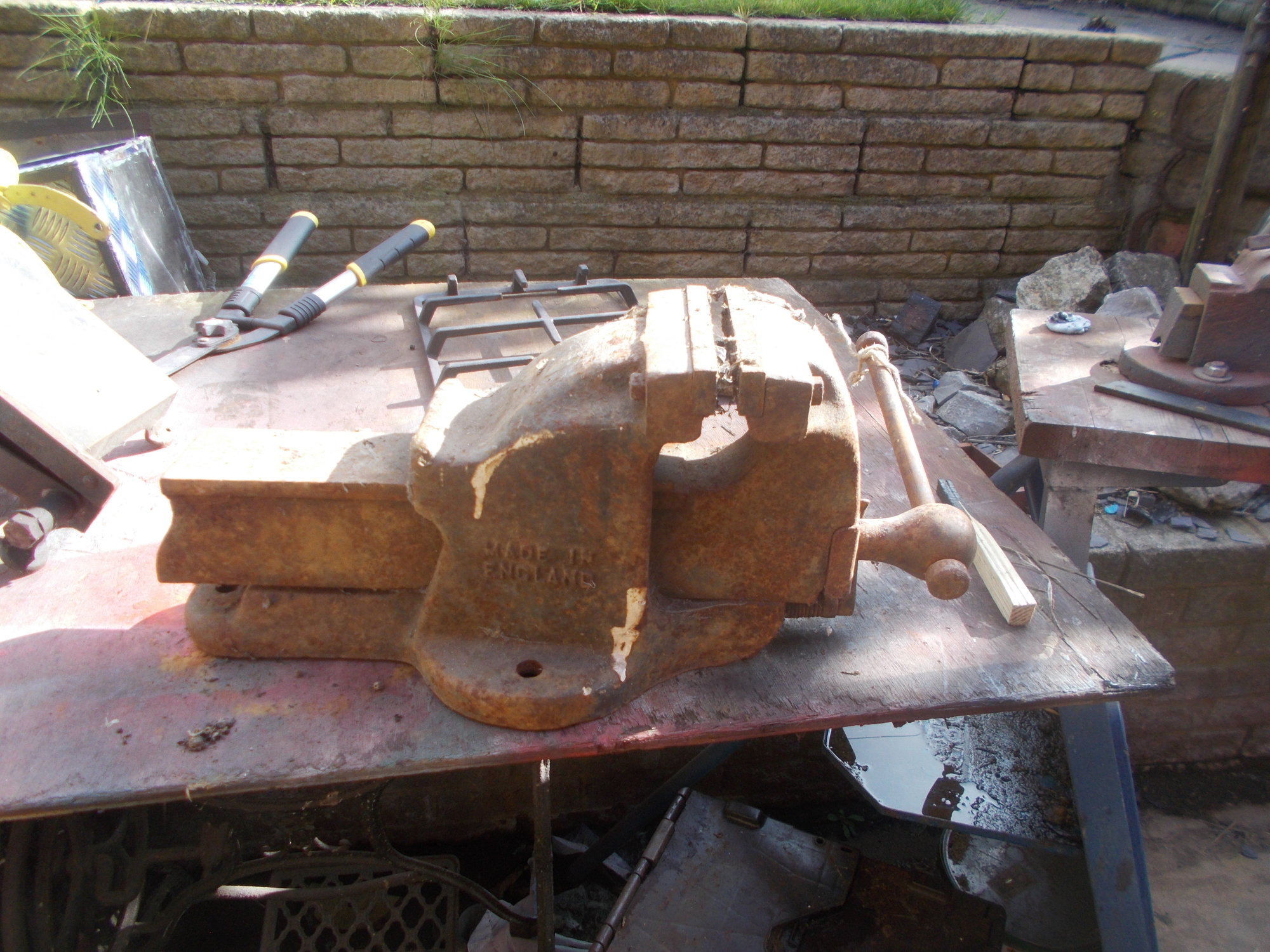

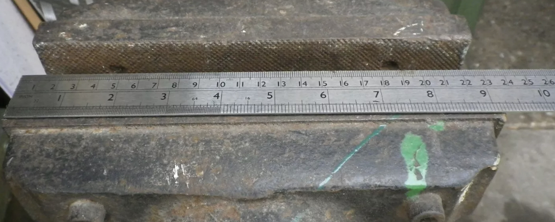

I know there were specialist floor standing vices etc from Woden and Record, but I'd guess that that might be the widest-jawed regular bench vice ever made in UK? Anyone know otherwise.
As it's Fortis it'll be steel, and those jaws look a bit stretched, so needn't be the heaviest but it's quite a vice.
And it's quick release - certainly the widest QR I've seen - did they have to beef up the QR for this weight of vice?
With the design and hex-head jaw screws it looks quite recent (casting also looks better than some Fortis/Herbert) - anyone suggest when made?

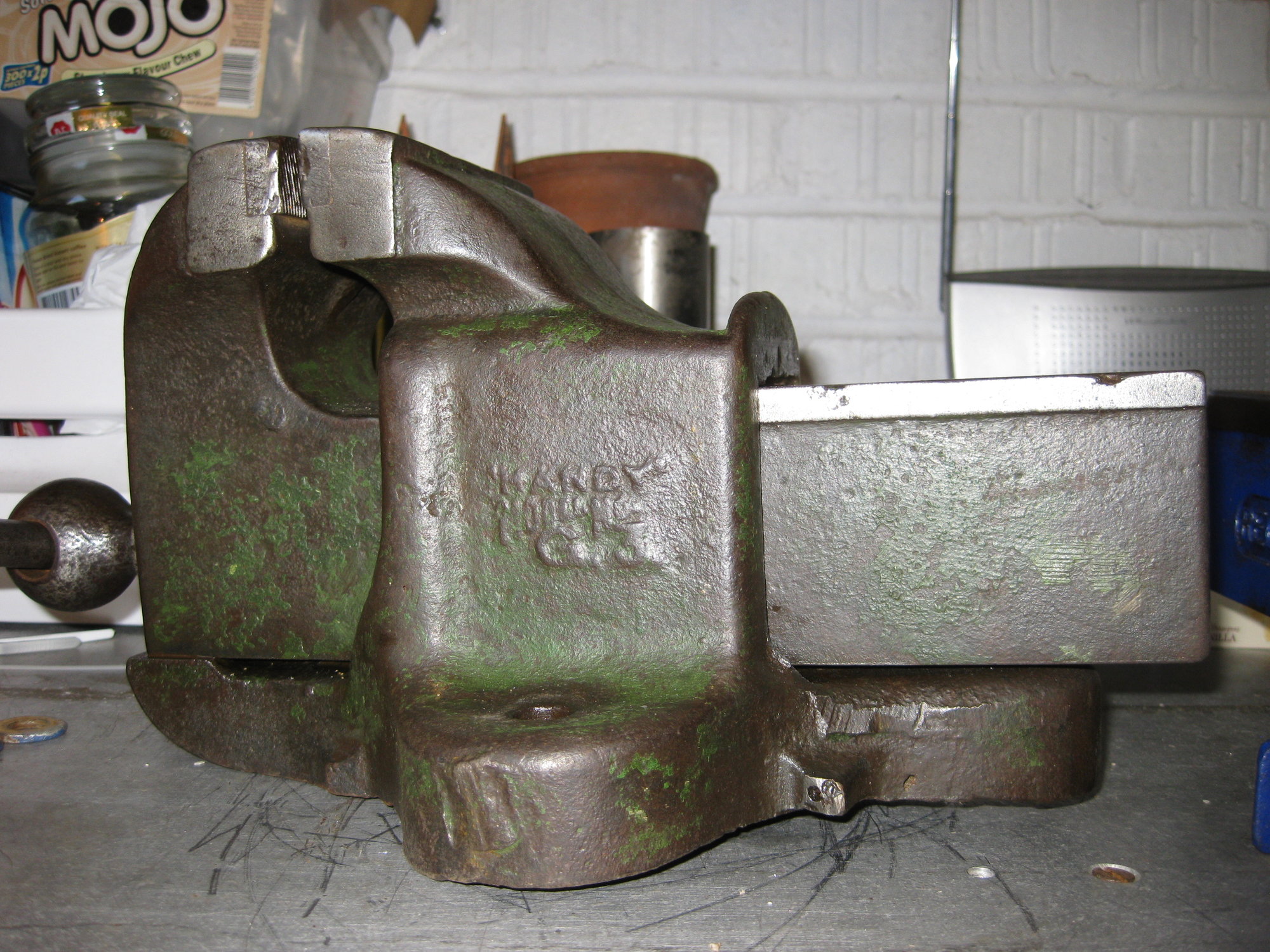

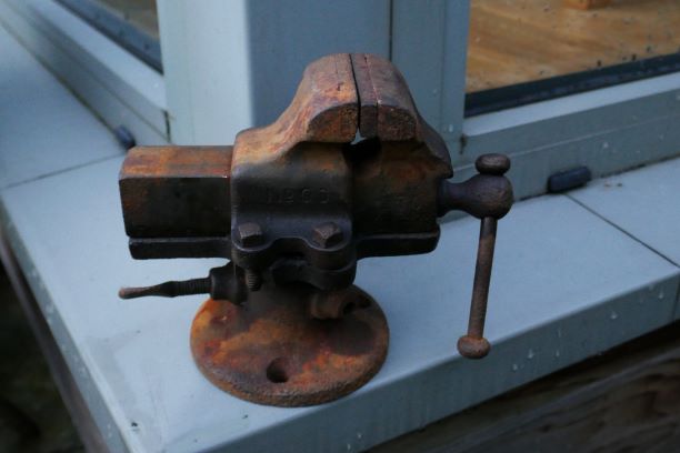

Here's what I think is the earliest of my Handys; 2 1/2in wide jaws, 2-casting rear/static section, bolted from the top into a threaded bottom casting, with square headed bolts/machine screws, just marked No 0, traces of what looks like original dull green paint (you can see I'm in the middle of making a replacement jaw).

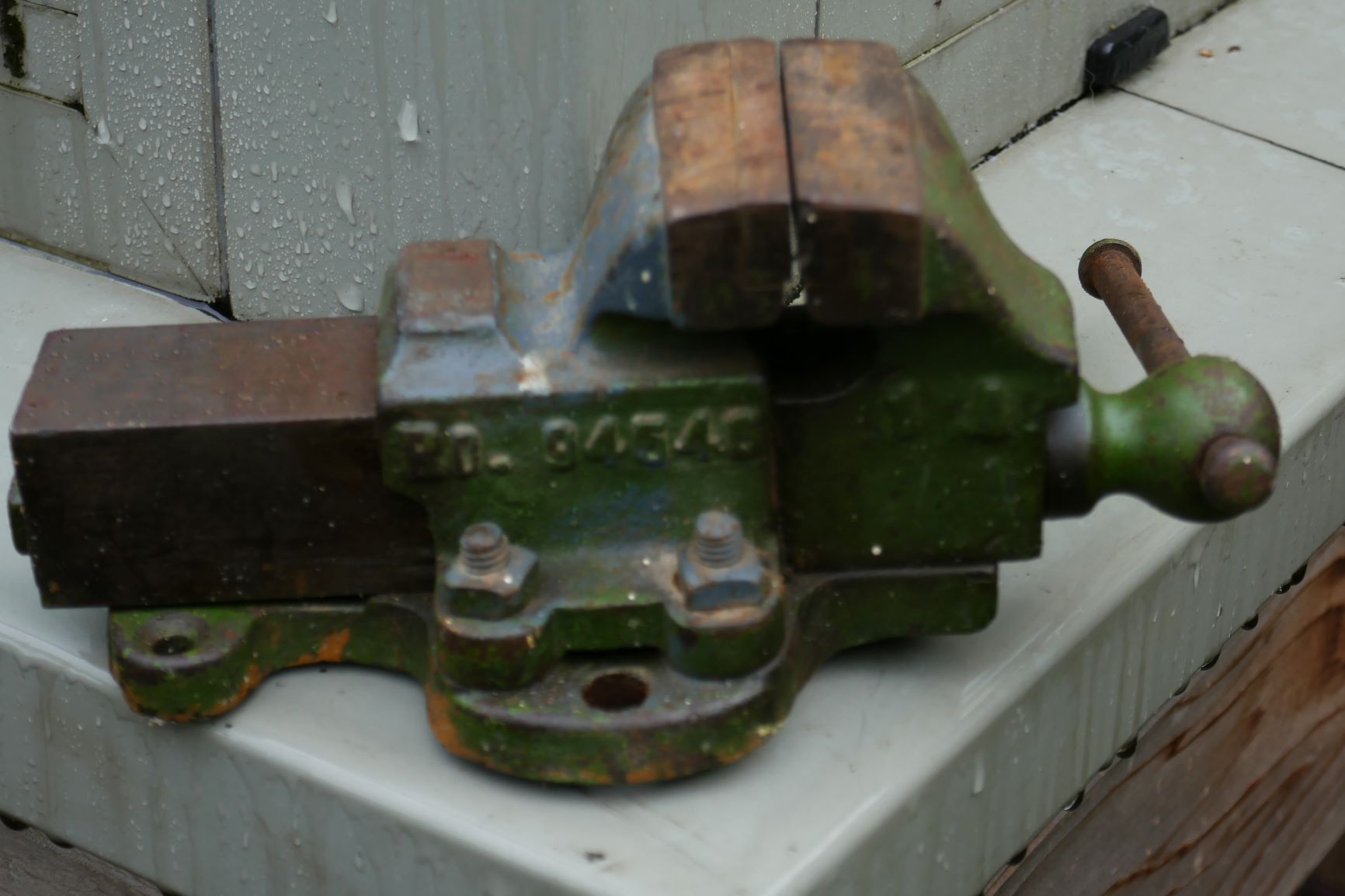

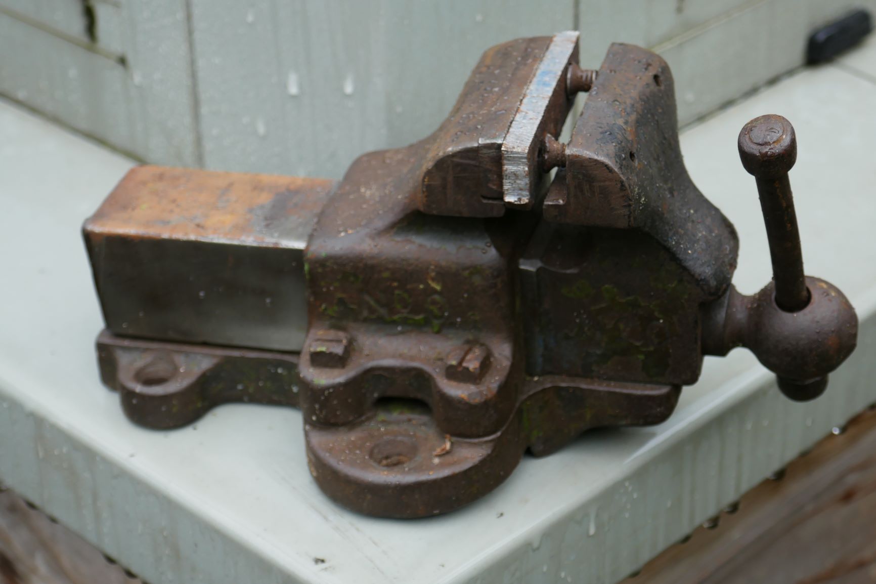

With anvil: 2 1/2in jaws - now the static is bolted from below, with a nut (square) atop and there is a registered design number RD 94546 cast in also the size 1A (which would be 0 at some stages of Parky mfgr also if Woden/Record).
Did this model have the name Handy? It's also related to the 'Eclipse' vice shown in the Marples cata (I don't think that's the Eclipse as used by James Neill later for hacksaws and blades). The green paint might be original?

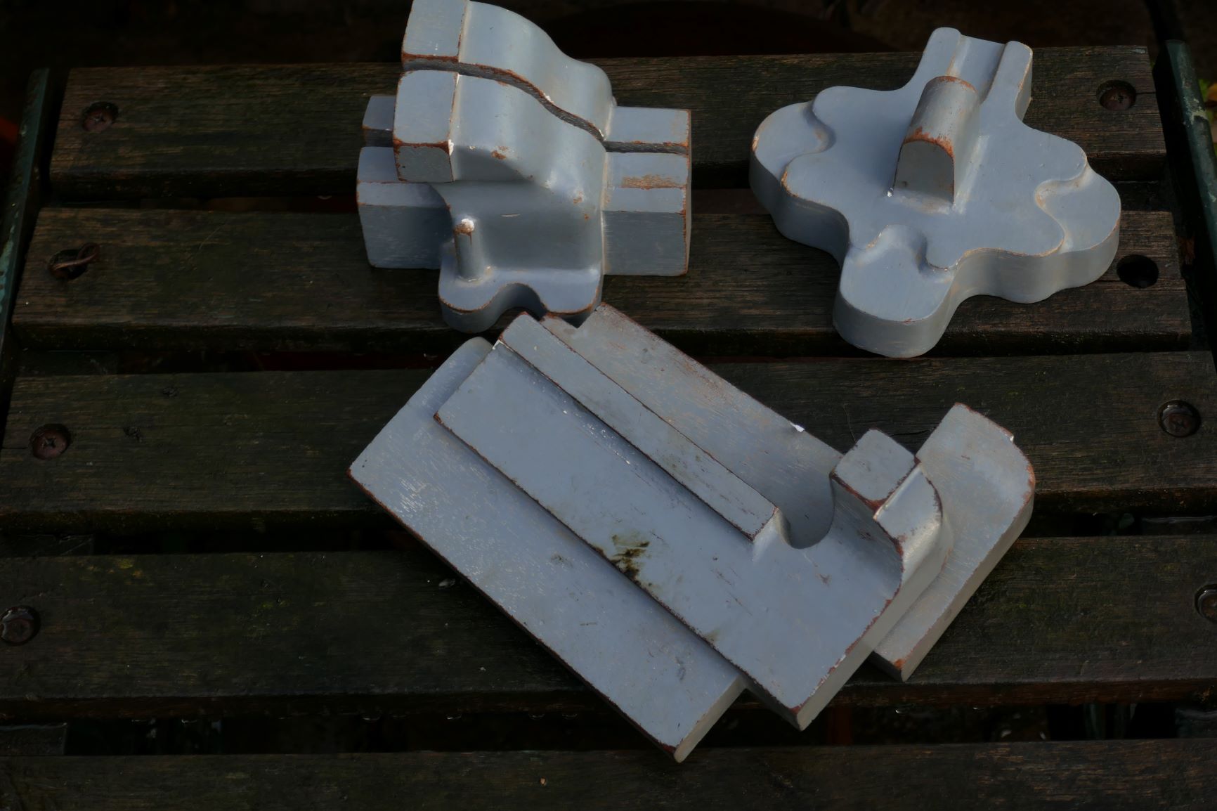

This is a very chance find and, although the dealer it came from deals in factory clearances, he couldn't tell me where this had come from - these are casting patterns for a Handy- type vice - made from a mahogany-type wood and painted - in good nick, but look used and pattern stores at a big foundry did tend to look after their patterns well. If you ask, the split parts are for the split mould box - they'd leave the casting in the centre of the mould-form and you can often see a central cast-split line if you look at any vice. They would make the Handy type of size 0 after shrinkage and machining but do have 'ears' for a slightly different bench mounting hole pattern (3 screws, not 4?).

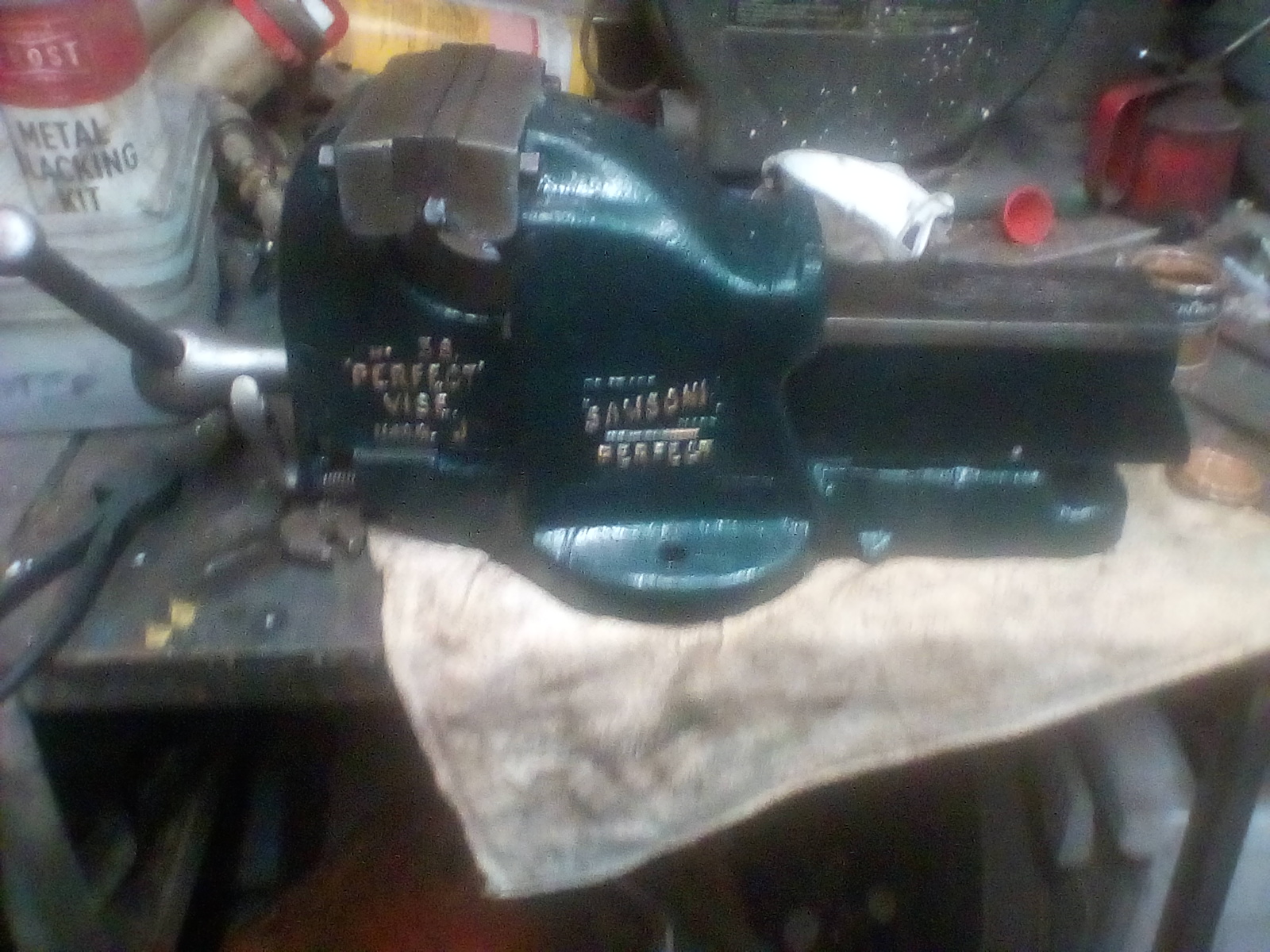

Hello, newbie here thought i'd post a pic of my Handy vice.

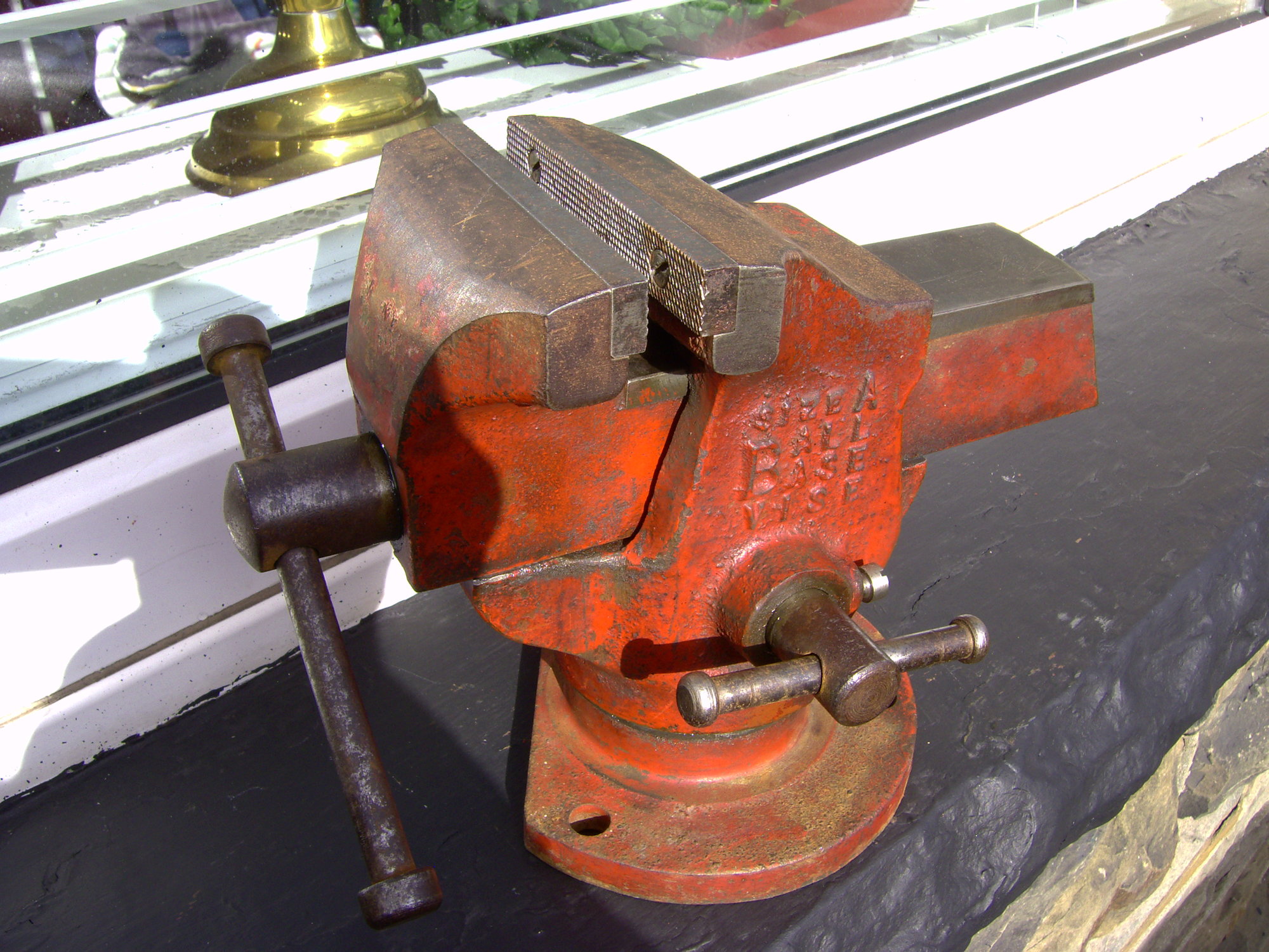

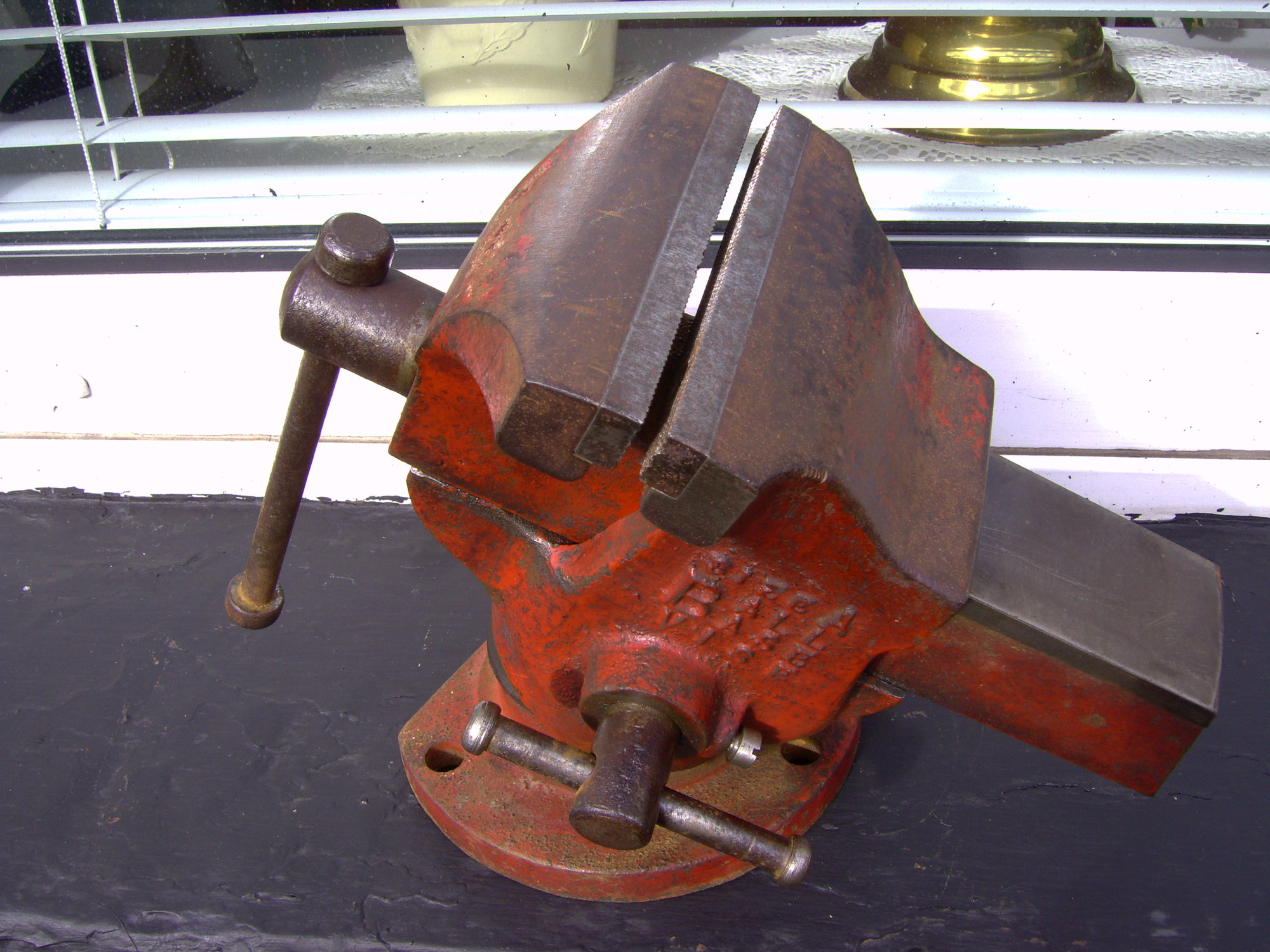

Sorry - this was the clincher - thought I'd posted it here above, but posted on ukworkshop - found for £5 on a local town market less than a week ago - what I believe is another Handy, with slightly different base casting and mounted on a swivel - some damage and a braze repair (well done) - yet another to tidy up, but I think the best of the lot. Size 00, again no makers name, 2 1/4in jaw, square head bolts down into thread in casting, can't tell what paint
