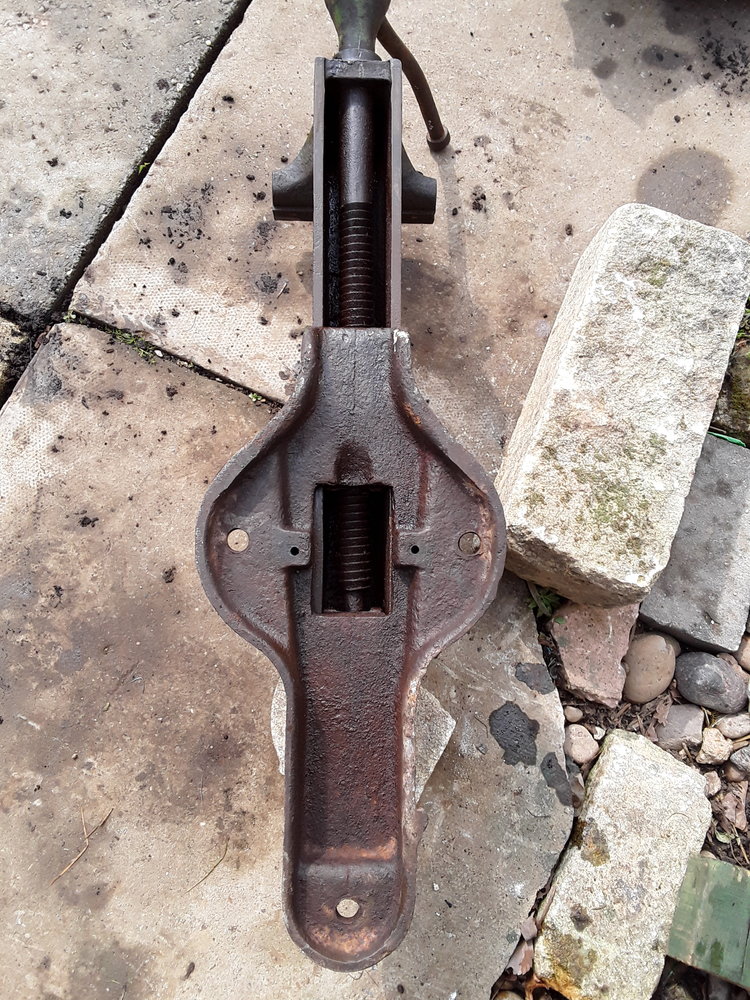

Disassemble it.

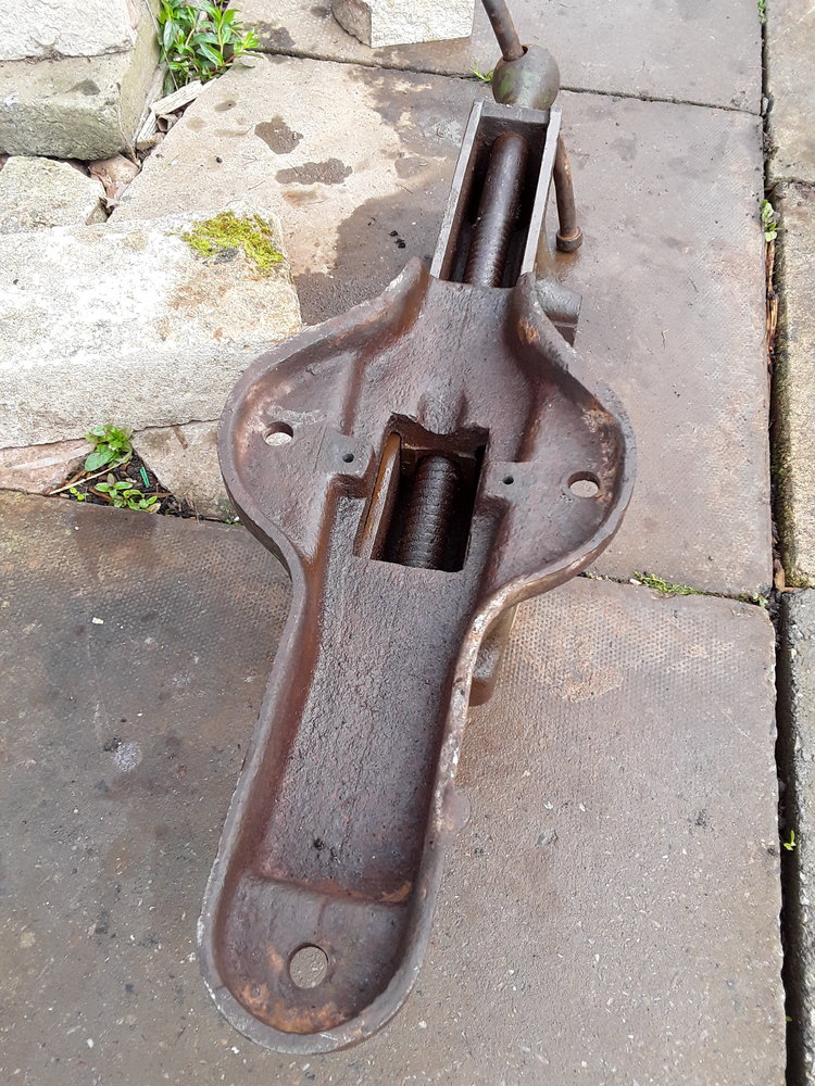

Pop some photos of the vice (especially the underneath showing the QR mechanism) on here and we'll probably be able to spot what is wrong and give advice on how to release it.I have managed to get vice jaws sliding but handle stuck solid,I presume q.r. is seized in open position which allows jaws to move. Will soaking whole thing in diesel for a week do the job.
I know. I have seen those videos.Apparently WD40 has instant effects, I've seen it on Youtube so it must be true. Soak in a bath of diesel for week or so should shift it, if not heat and soak again.

Great score for £20.ooYeah, you did real good ! It is a Parkinsons.
View attachment 279937 View attachment 279938
Thankyou, I,ve got the q.r. and front plate off and the flat bar and the mechanism from underneath, the screw is exposed but can,t pull the screw out or turn the screw, is any thing securing it or just rusted in. Everything else came out with the magical w.d.40. I,m getting the bug for old vices, i,ve just scrounged a record no. 4, just a bit rusty. I,ll post a photo later (got to find how to do it first)Pop some photos of the vice (especially the underneath showing the QR mechanism) on here and we'll probably be able to spot what is wrong and give advice on how to release it.

I have posted photo,s as asked for.If you've pulled the half nut out as well there should be nothing keeping the main screw in.
50% diesel 30% paraffin and 20% old engine oil works best.If i have something seized, i dunk it in a bucket of diesel.
That works pretty damn well.
Only if in a air tight container.50% atf and 50% acetone apparently, is the bees knees
Thanks for the help, I,ll try the diesel bath for a week.Only if in a air tight container.
