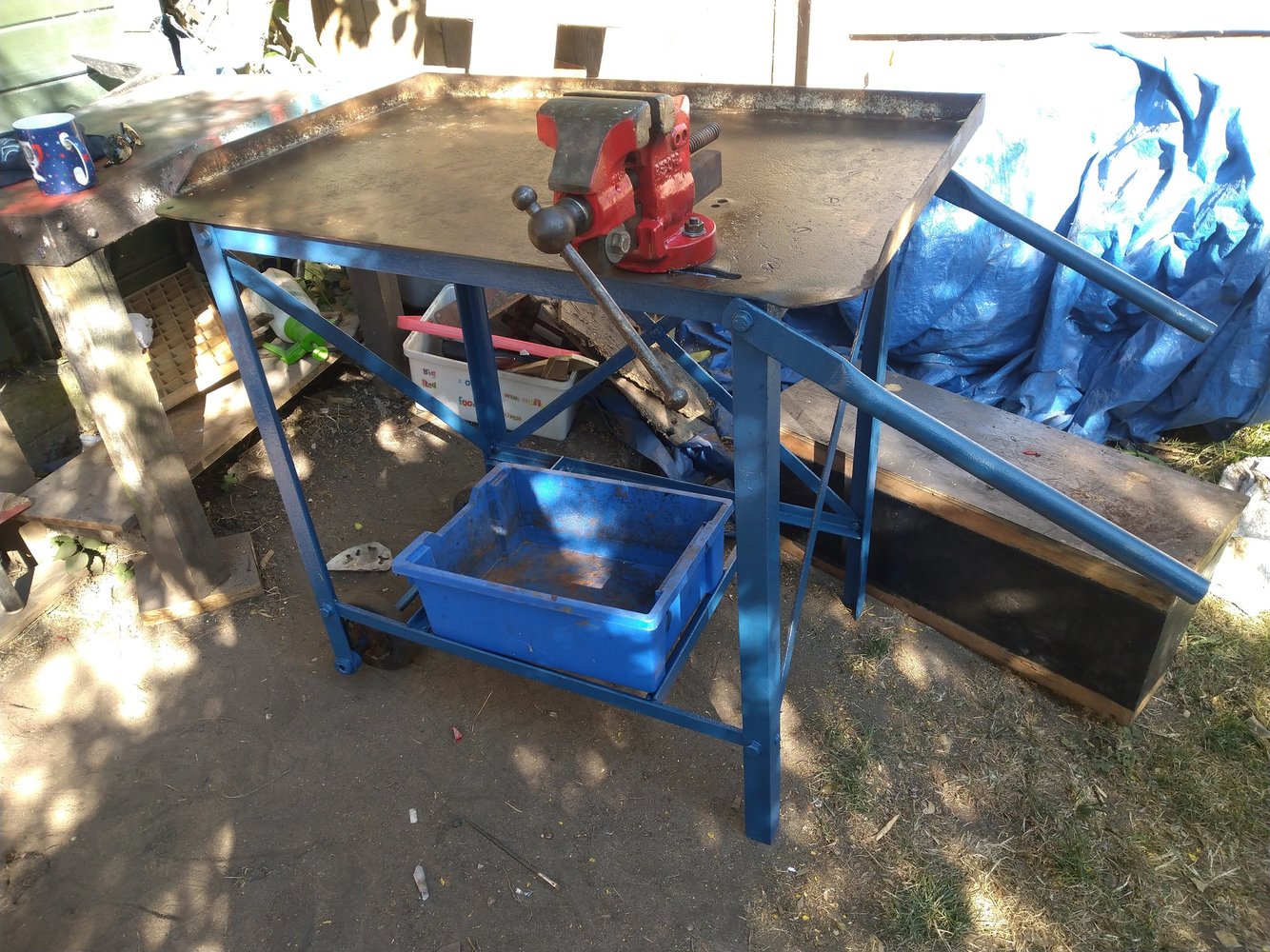

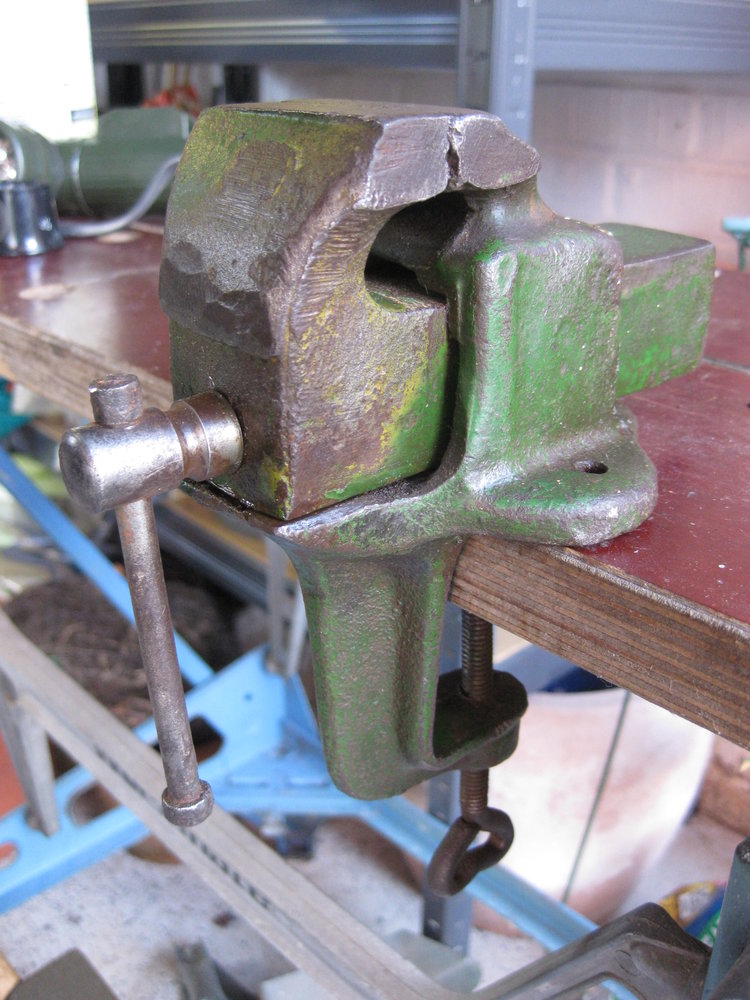

Were the bolts provided precision ground with minimal threads exposed through the bench, or of the general purpose type, with threads within the shear plane ?I've seen copper, brass or aluminium sleeves used to allow bolts smaller than the drilled hole to be used. Many years ago when on my tools and fitting out a workshop for the MoD, we had to drill holes in the bench to take vices and then ream the holes in the bench and vice to ensure a good fit.

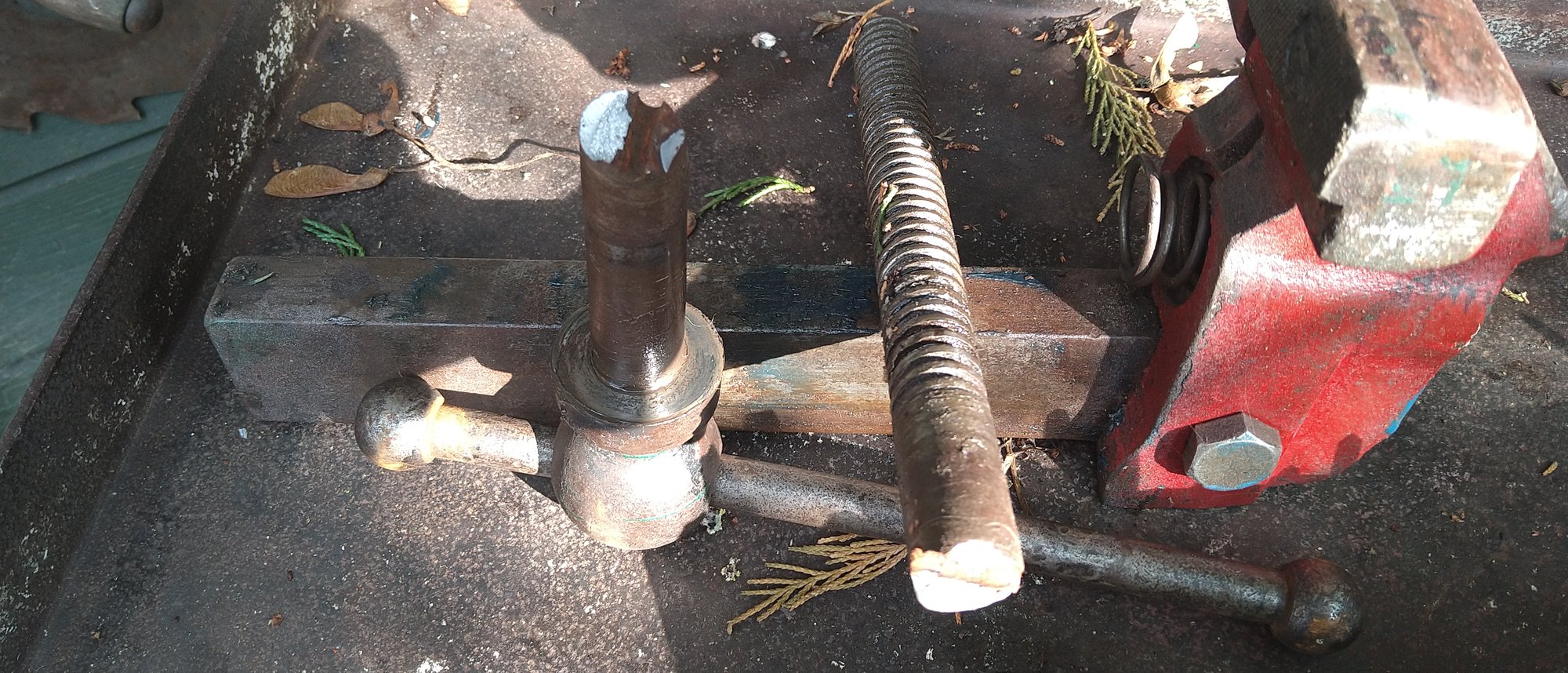

, I should've figured out what that hole in the slide was for !
