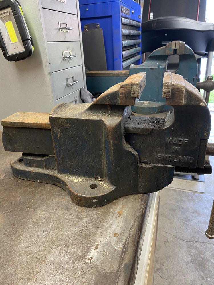

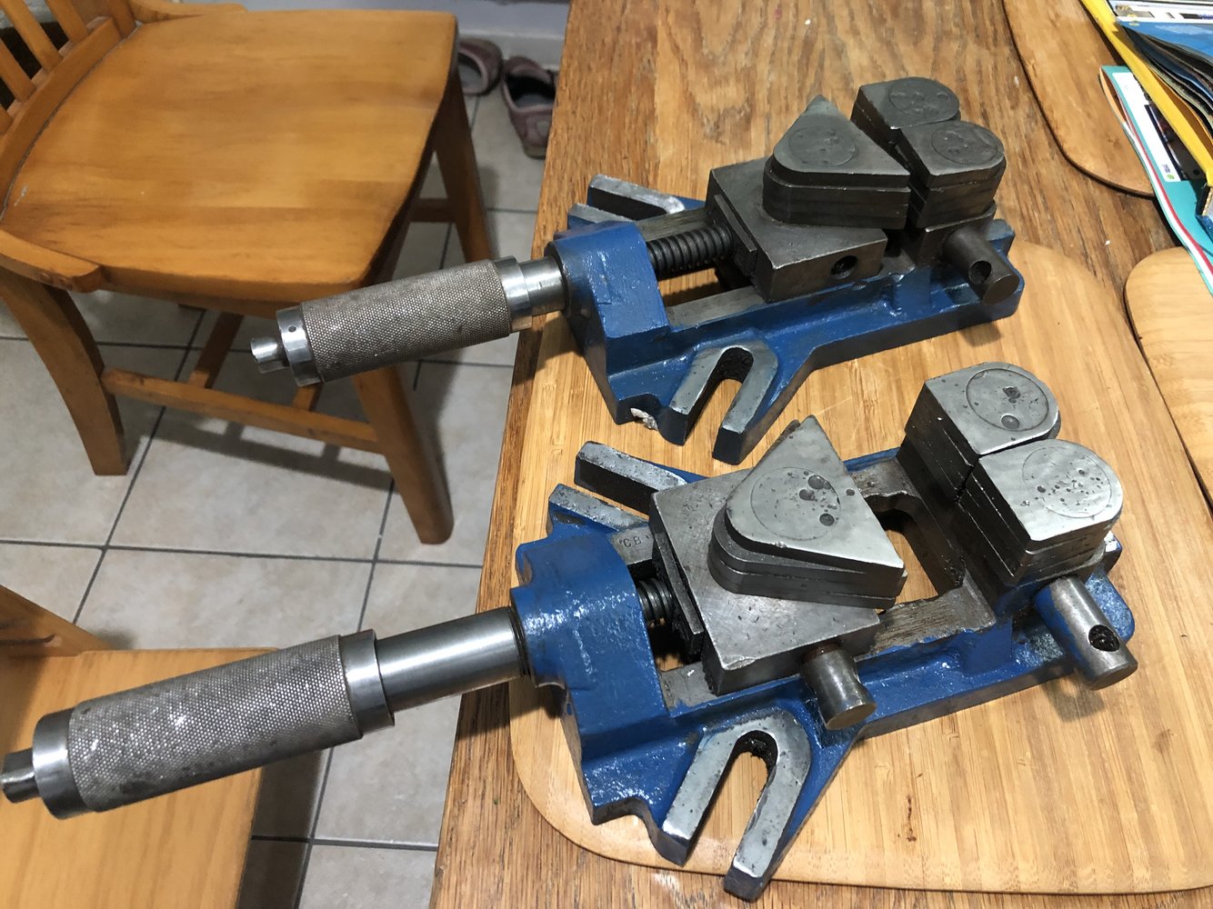

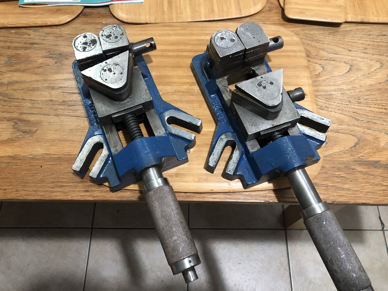

Good bits of kit I have one tooGot these today. One broken/lost locking pin on one vice and not the best paint job, but £100 the pair I’m happy.
View attachment 337628 View attachment 337629

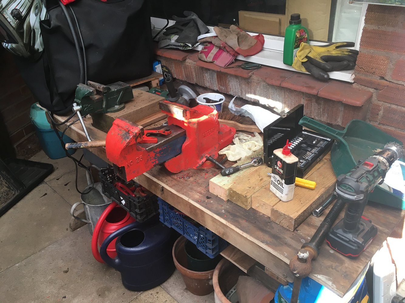

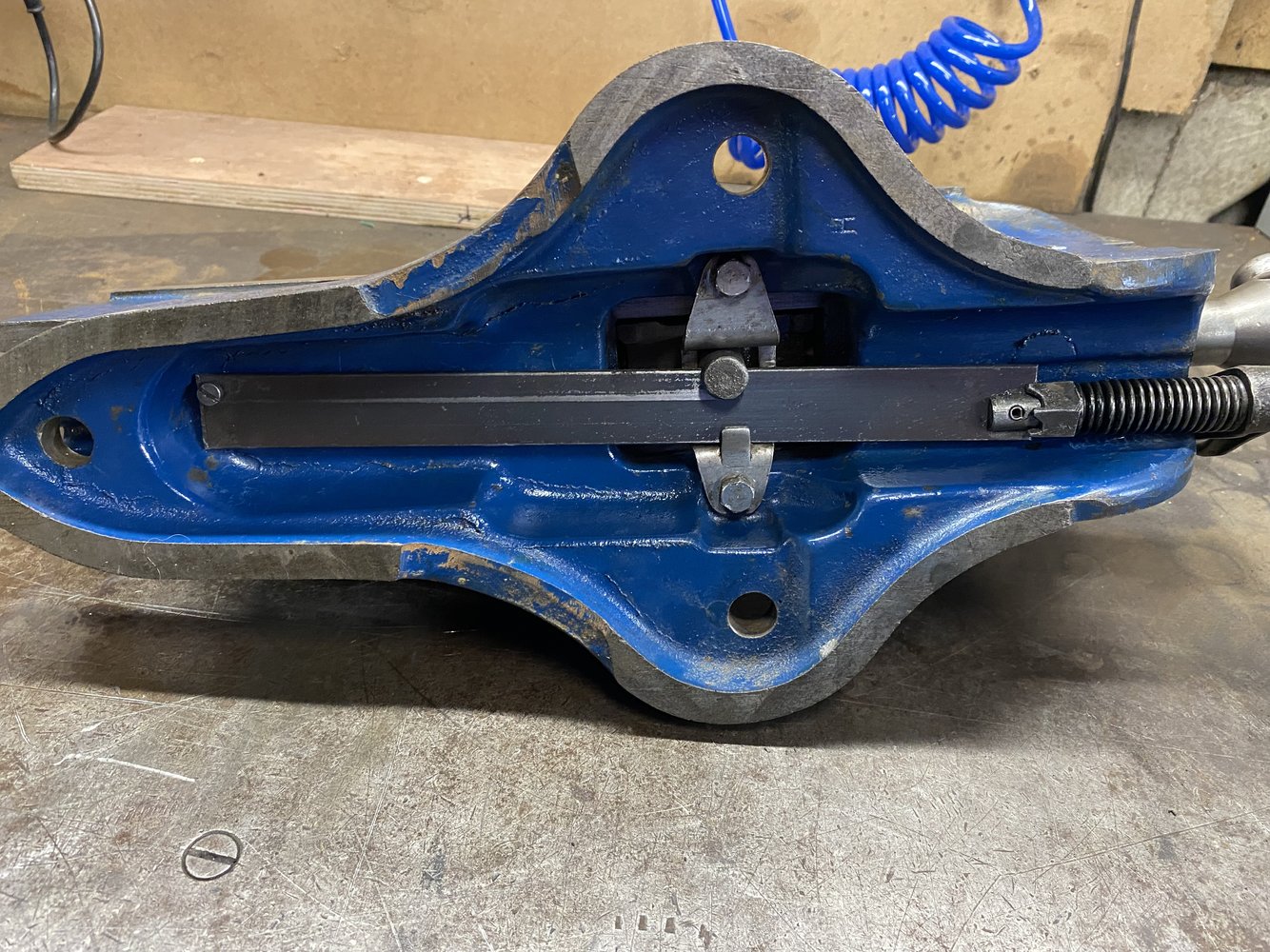

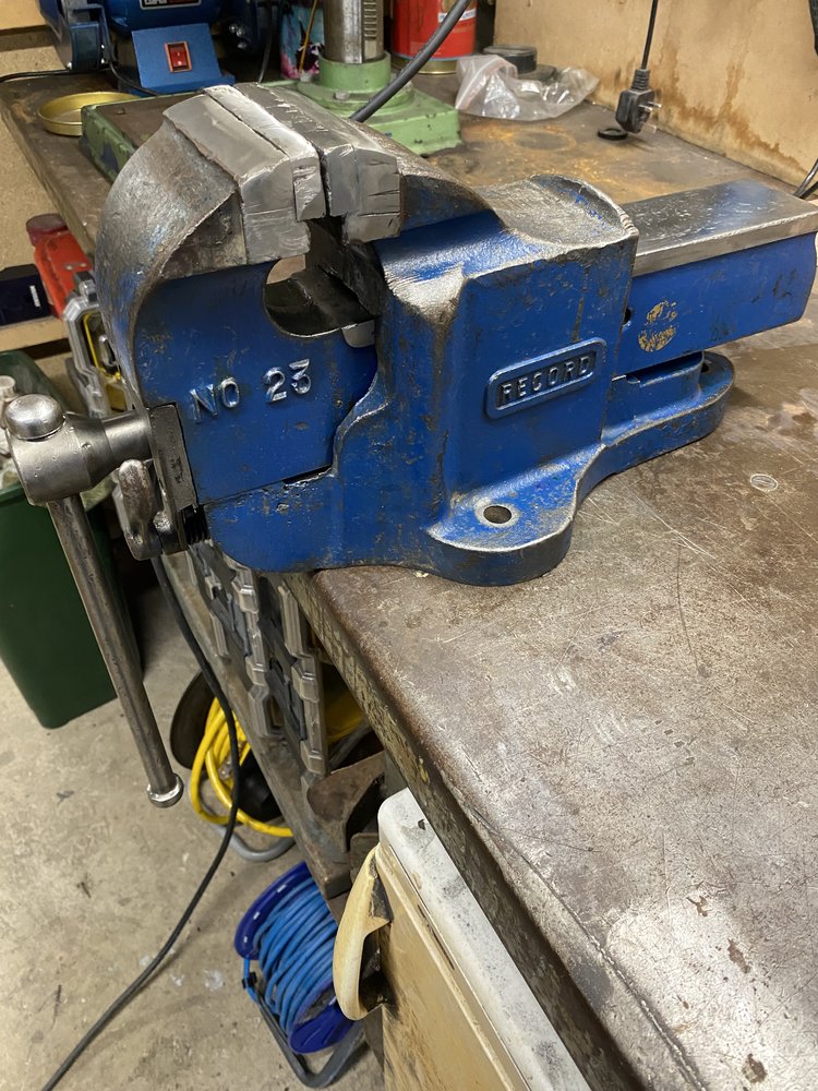

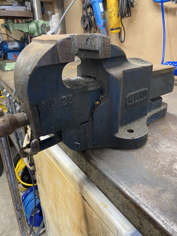

Great resto. I've got one of these rusting away in my garden, it was either that or gnomes.Picked up a Record No 23 fitter vice (post 1966). Didn't look too bad but wouldn't open fully and the QR was hit and miss.
Strip down was pretty straight forward, not even a seized screw to battle with.
QR problem was down the bracket for the lever that screws to the front was buckled. Apply some heat and straighten out was a simply fix. Also the spring was slack and the bracket that holds the bar in place over the screw block was upside down and the bar not hooked into it.
The opening problem was another matter. The screw was thick with a resin type substance. I can't even figure out why it was on the screw as it is mostly covered and can only think, for whatever reason, it was applied through the oiling hole. It was a pain to remove as various chemicals barely affected it so resorted to heat, although slower and messy it softened it enough to scrape out leaving a screw in perfect condition.
The body of the vice was mainly old grease but again some of the same resin stuff, especially underneath, but with brake cleaner it was able to be scraped off. It left the vice with the majority of the original paint still intact and rather than paint over it I left it in its original honest condition.
Reassemble was straight forward with cutting open the screw slots again. Jaws warn but serviceable were reused. The vice is now silky smooth with a full range of motion and working QR
View attachment 340429View attachment 340430
Nice job..love the original look of the 23.. well done.Picked up a Record No 23 fitter vice (post 1966). Didn't look too bad but wouldn't open fully and the QR was hit and miss.

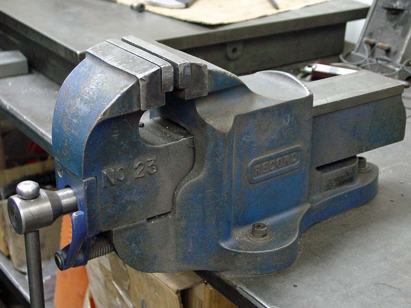

Can I ask how do you know it's post 1966 ?

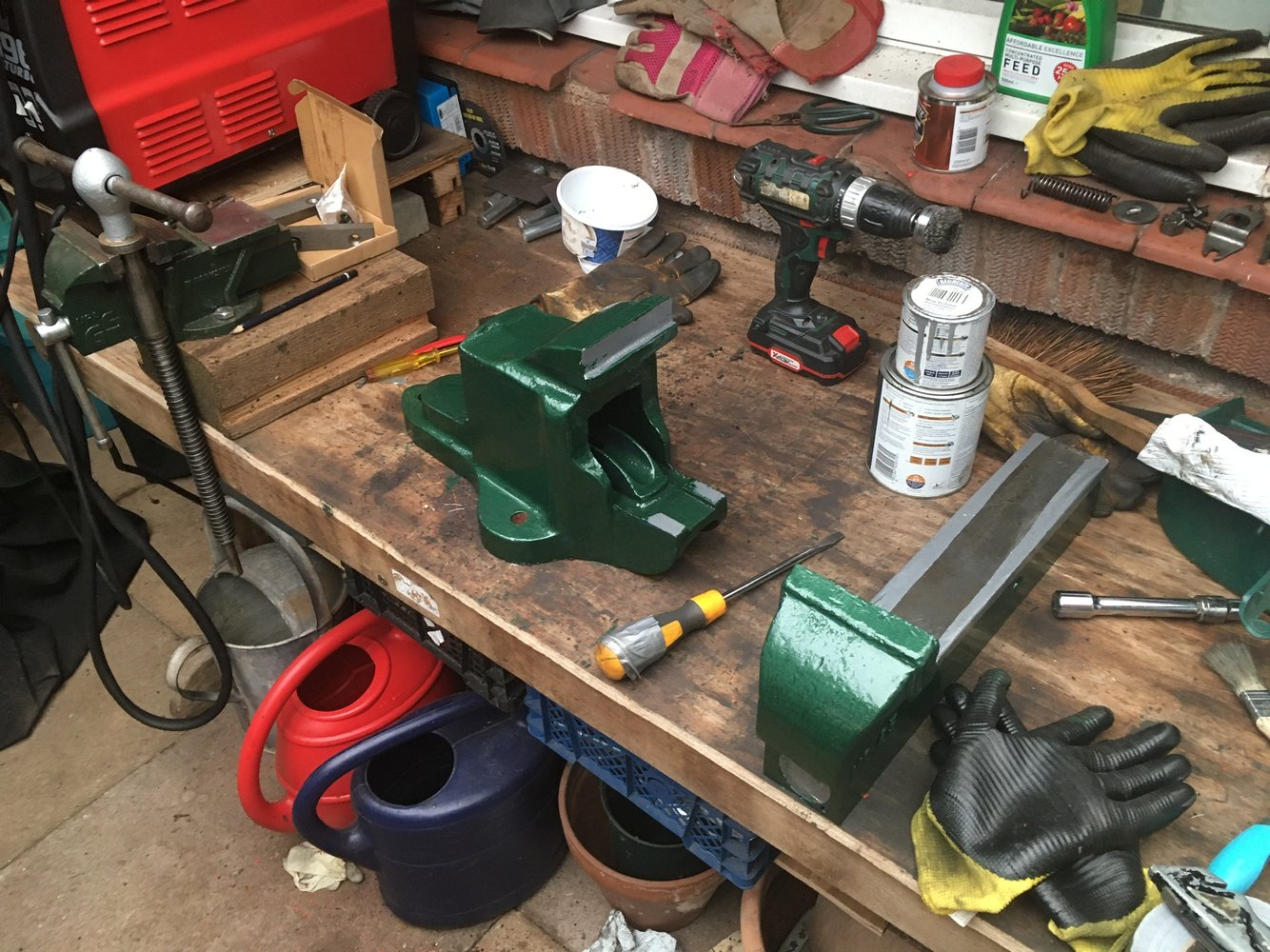

I recently got a Record 23, but painted mine green.![]()
I think it's the meatball - the spindle-hub changed around that time from - let's say - an olive form to a more sober design as we know it today.
Really great work to even guess what a nice paint was left under all the dirt and resist to go at it with something more radical and destroy all that forever. Well done
Carsten

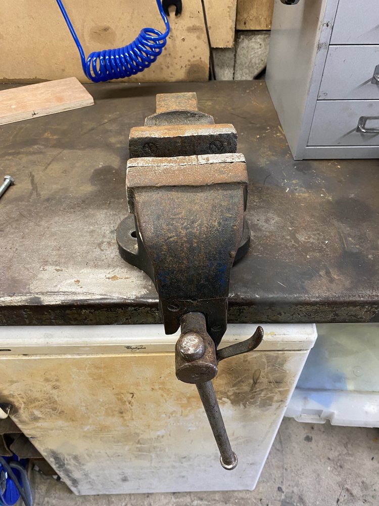

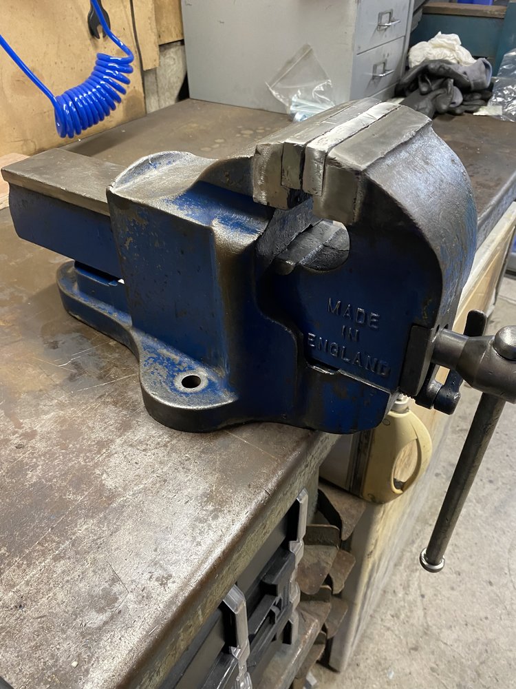

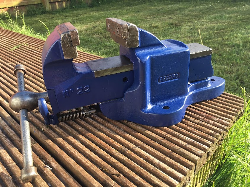

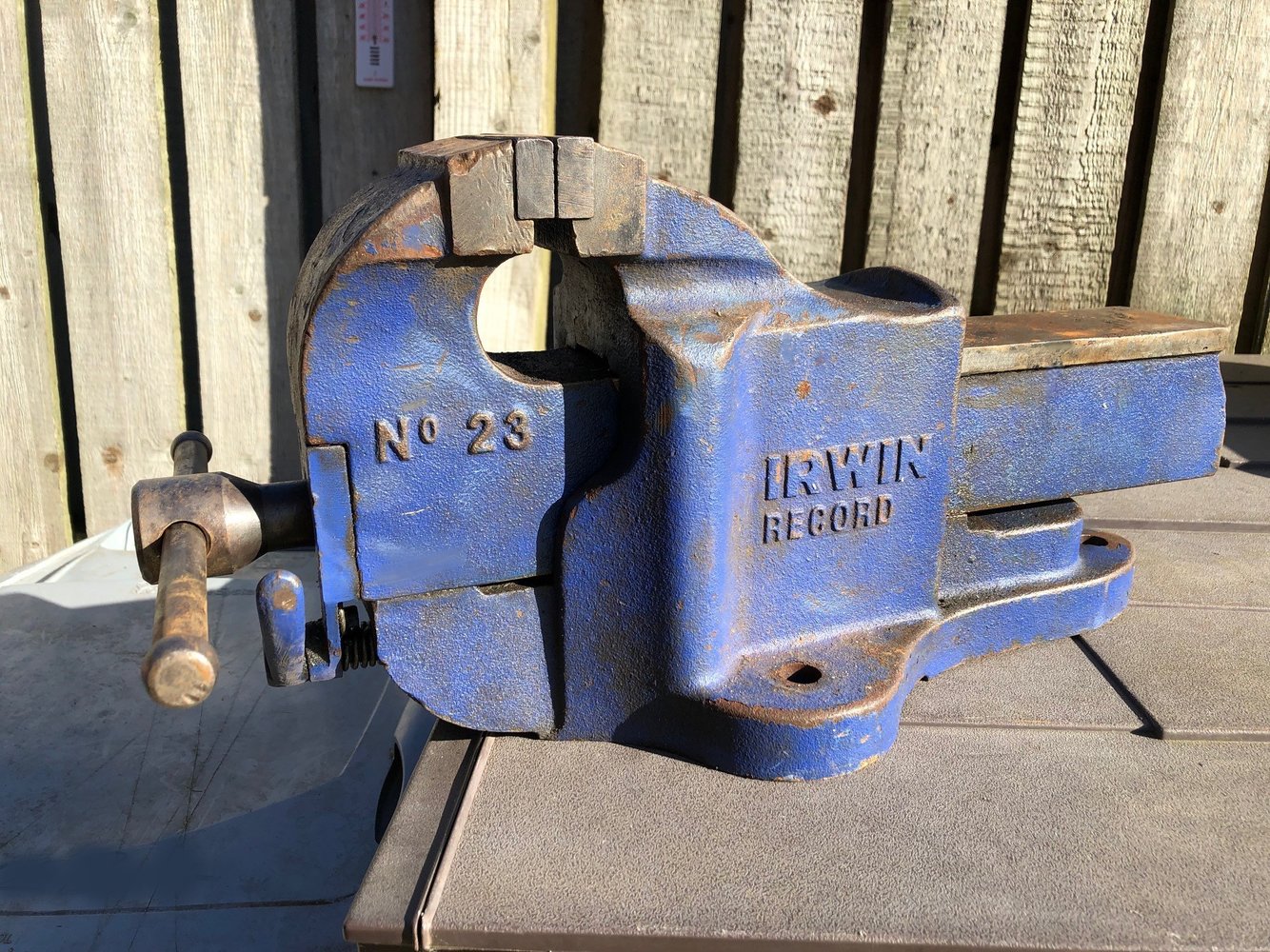

Not a like for like but the differences are evidentGreat job. I'm with Carsten that's exactly how I like to see them too, it wears it's age & use honestly.

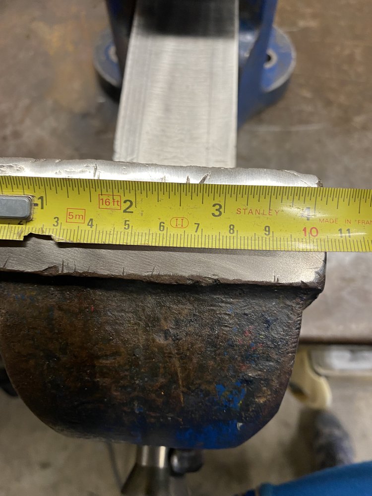

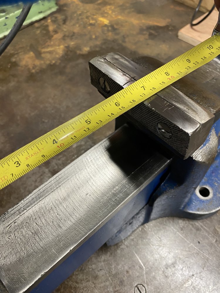

About 4” till the slide is flush with body. It’s only 3” jaws. Stout wee viceThat's cool.
How far does it open, the slide looks short ?
Rounded handle boss pre 1966 and flat on post 1966
Record is in-printed into the cast pre 1966 and stands proud post 1966
The oiling hole is accessed with the jaws open pre 1966 and closed post 1966. You see some pre 1966 with the hole at the rear, I’m not sure if these are Frankenstein rebuilds, both castings were available when manufacturing or even the dynamic jaw (usually the lower one that breaks) that has been replaced under warranty
Not 100% sure on this one but I think QR bar is fixed to the handle using a screw pre 1966 and a pin after that.
pre 1966 - No 22
post 1966 - No 23
