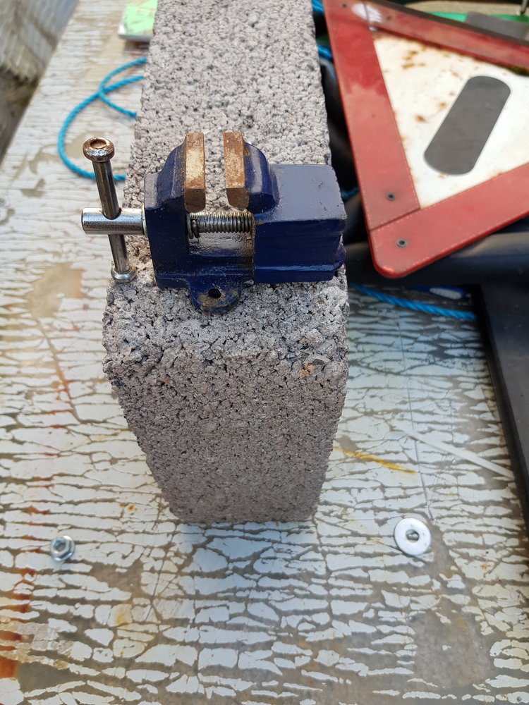

glue it to a breezeblock?

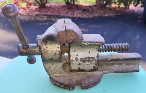

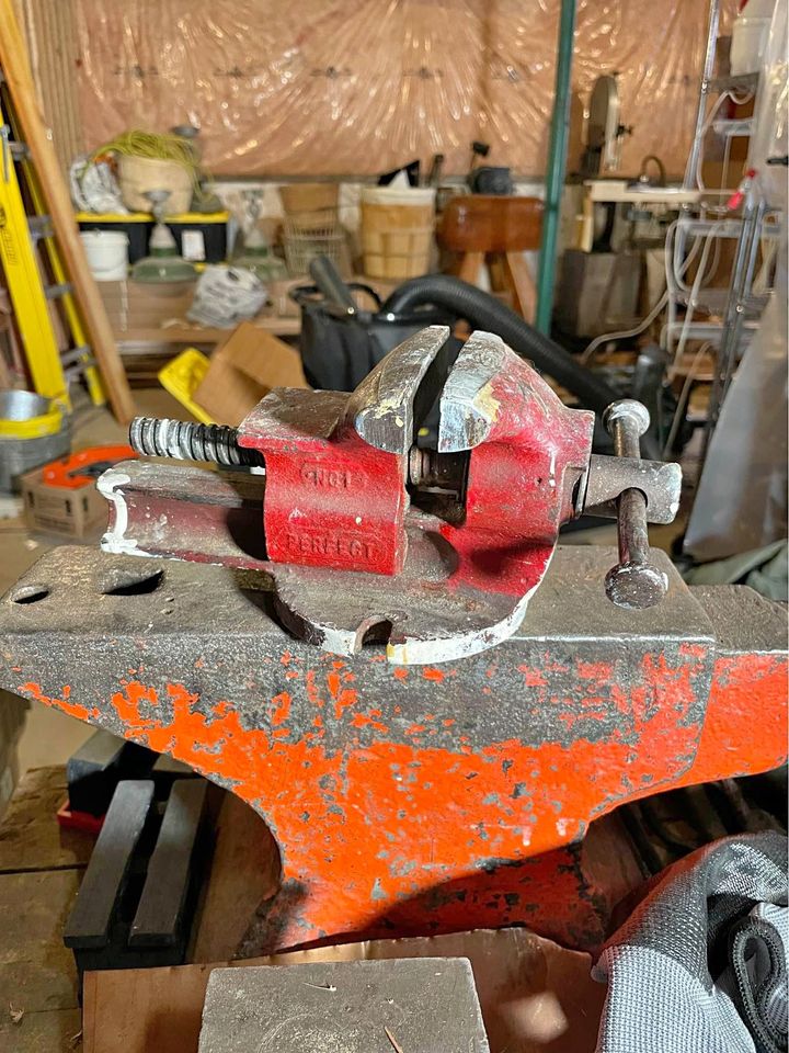

In this case: a Clark Machine Perfect No 1. Weight 6.5 lbs., 3-1/4" jaw width, 2-1/4" jaw opening, 7-3/4" length, 3-3/4" high, and 4" wide at the base. Clark used "Perfect" as a brand on larger bench vises as well as power hacksaws. No written reference to the No. 1 has turned up so far.
View attachment 453027 View attachment 453028
Clark Machine Perfect No1 with decal. The right side has no markings.

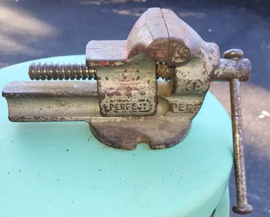

Apart from the decal, and missing the text "PERF" on the lower front left side, it seems to be a close match to what sellers are calling a Parkinson's Perfect No. 1. I've seen pictures of three examples in Canada, but haven't found the model in any Parkinson's catalog on this site or elsewhere.

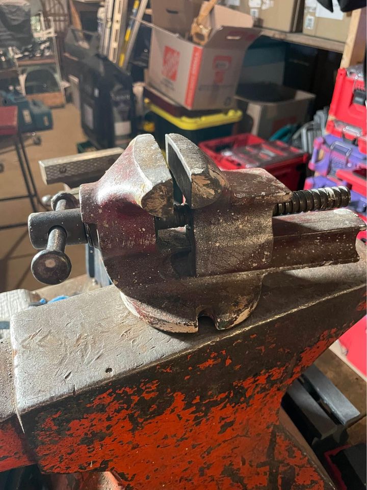

View attachment 453029 View attachment 453030
One example of the claimed Parkinson's Perfect No. 1. Notice the groove the dynamic jaw slides in does not extend as far forward as on the Clark, leaving room for the "Perf" text.

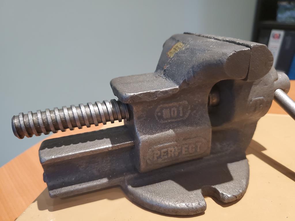

Another variation was made in Japan, according to the seller, but nothing in the photos indicated that.
View attachment 453031 View attachment 453032
The groove for the sliding jaw again stops sooner than on the Clark model, but the "PERF" text is absent.
It seems possible that people assume Parkinson made the middle version because its "Perfect" line of vises is much better known than Clark's.
Is there any evidence that Parkinson's ever made a vise like this?
Yes - Woden seems to have tried out several variants of this (which they patented) but each time reverted to the Parky type QRthat free slide is like a woden vice, never seen a premier before? nice find

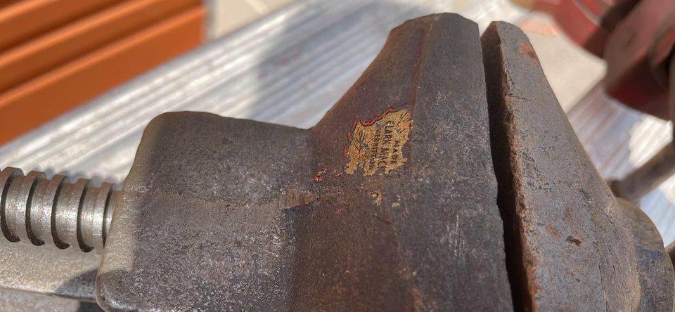

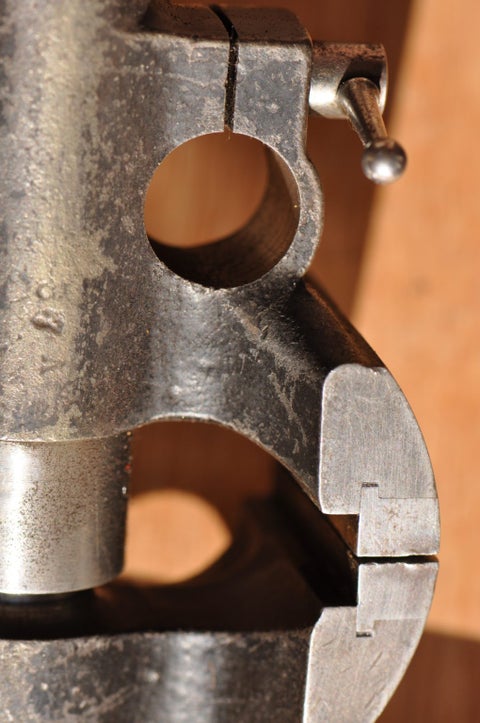

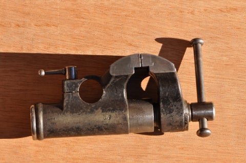

Interesting thing! Clamps onto a pipe so perhaps that's a clue
The closest I have seen was in the late 70's when they built a housing estate.
i have several of their anti clockwise release, very easy to use!!Yes - Woden seems to have tried out several variants of this (which they patented) but each time reverted to the Parky type QR

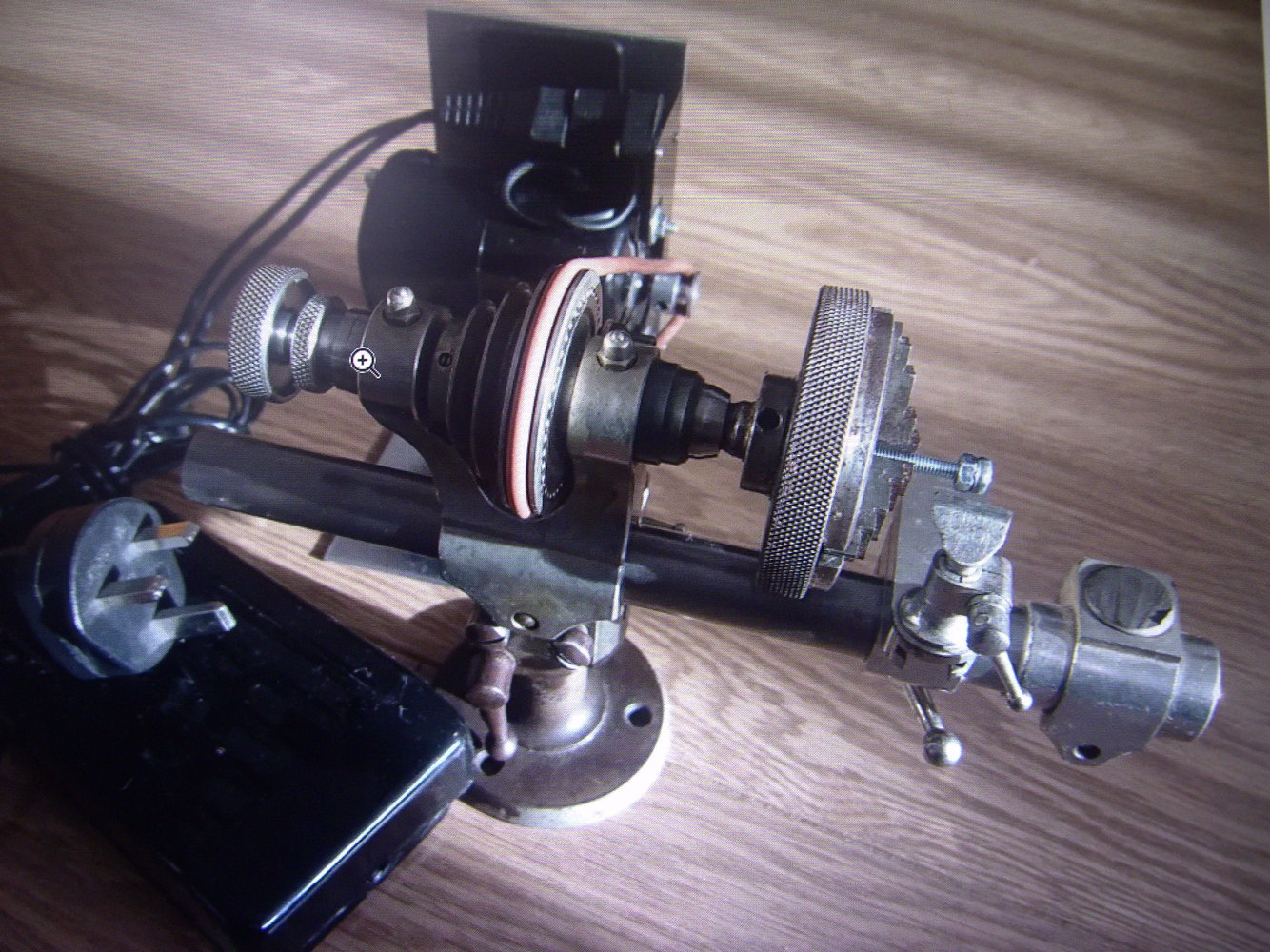

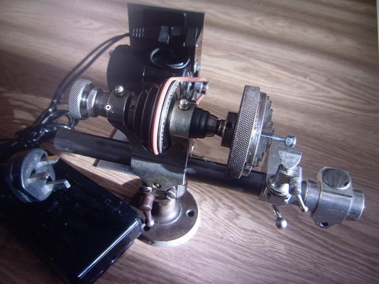

Especially as it's only 6 inches long, the hole looks to be less than an inch in diameter. It looks to be a well made vice, note the jaw facings are keyed into the jaw, seems unusual for a two inch jaw width.all i can think of is a jewelers vice mounted in series to a steel horizontal pipe so can be titled vertically in a production line, but really there were other products out there?
Reasonable assumption, but might the vice be a little heavy for such a small lathe?Could it be a convenience accessory that can be attached on an older type of single arm watch makers lathe ?
Although needing a coin or something next to it in the photo for scale, the shape and ball end of the clamp lever appears the same as on the watch makers lathes that I've seen. In the photo above, I noticed there appears to be a part number on the side of the vice, " 87A ", which may give a clue in tracking it down ? I wouldn't think weight would be an issue for an apparently tiny vice, or the potential size of the workpiece it would hold ? Its definitely an interesting vice.Reasonable assumption, but might the vice be a little heavy for such a small lathe?
