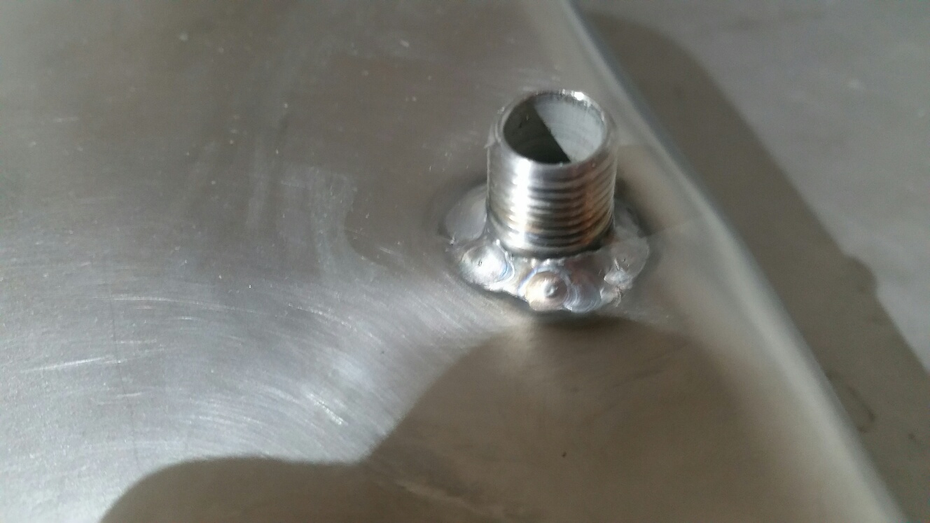

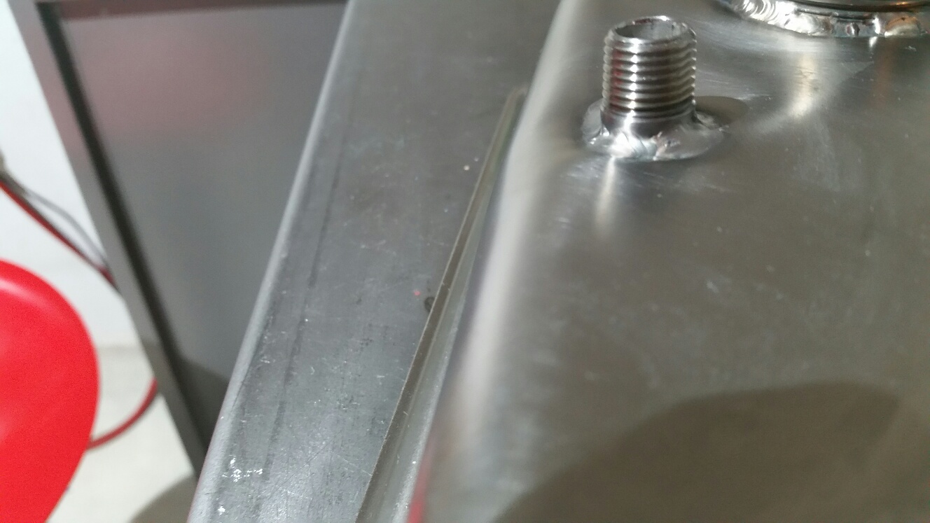

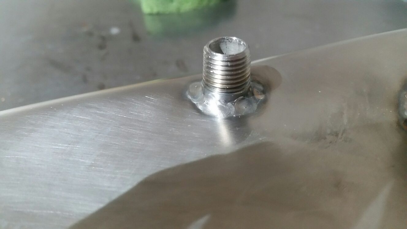

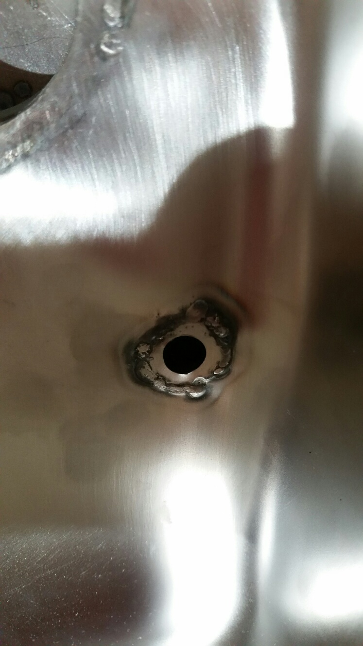

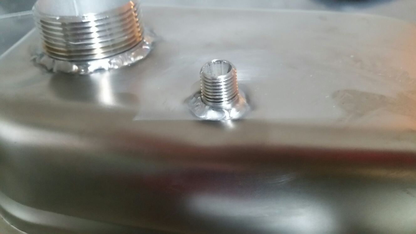

Too cold.
You said they were 3mm.
I said up it to 90 for the tack and 75-80 for the run.
Go over it again without filler and blend it all in. Use a dab of the filler if you need to. Keep the current up and travel quick so you don't distort it any more.
If it goes badly it's not my fault. I'm just passing advice based on the pic. It looks like it's not gonna be water tight.
The large filler neck was 3mm these are 2mm.
