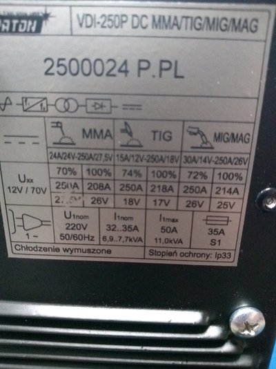

Power source only mate... They do make one with an integrated feeder but as I already had my suitcase feeder going unloved since my ranger died, I figured go for the power source only.Sorry Hugh I’m a bit lost is that a 250A power source only or has it got a wire feed built in?

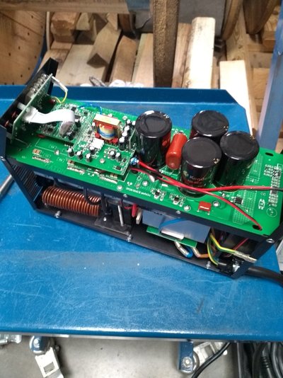

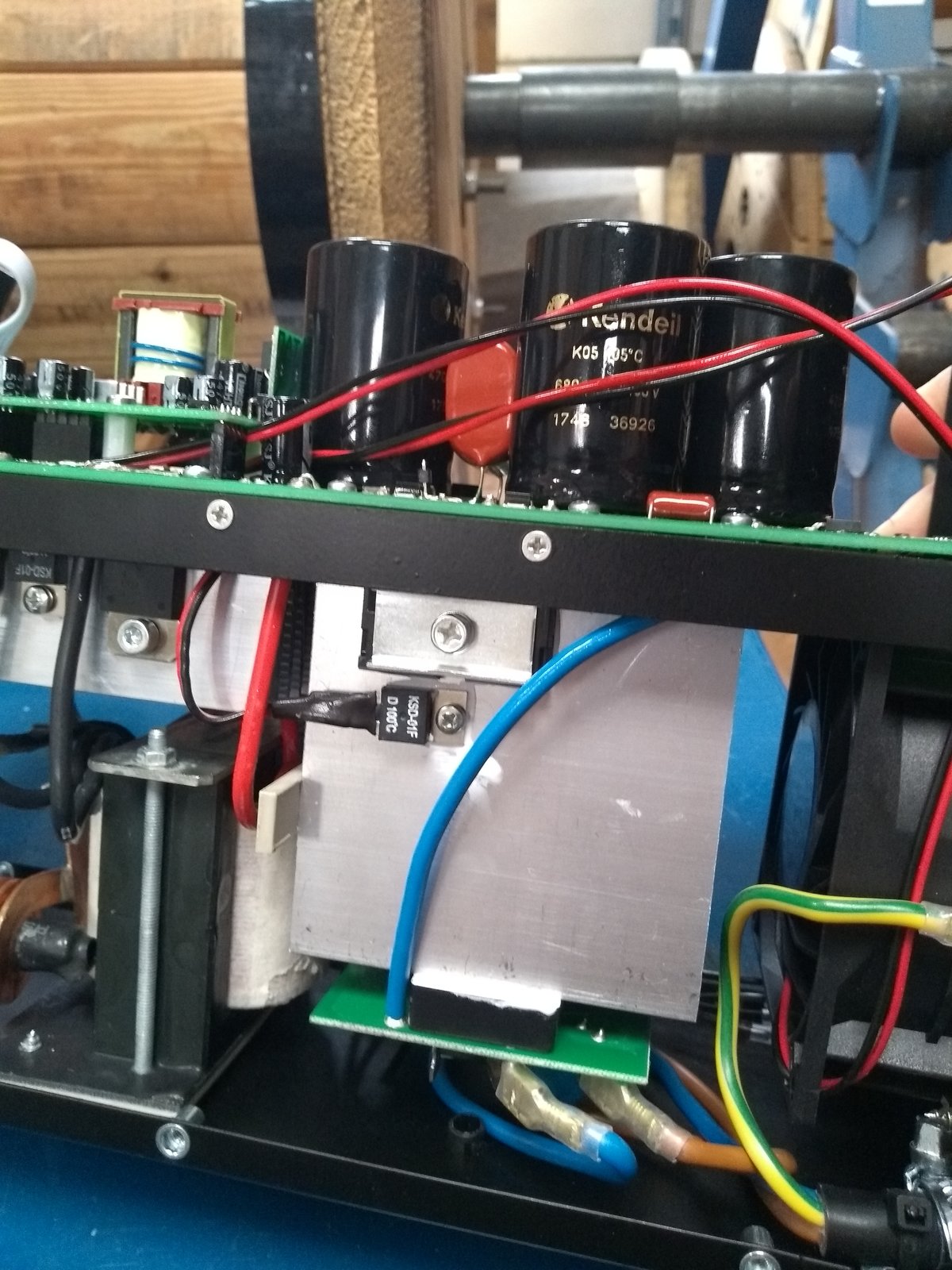

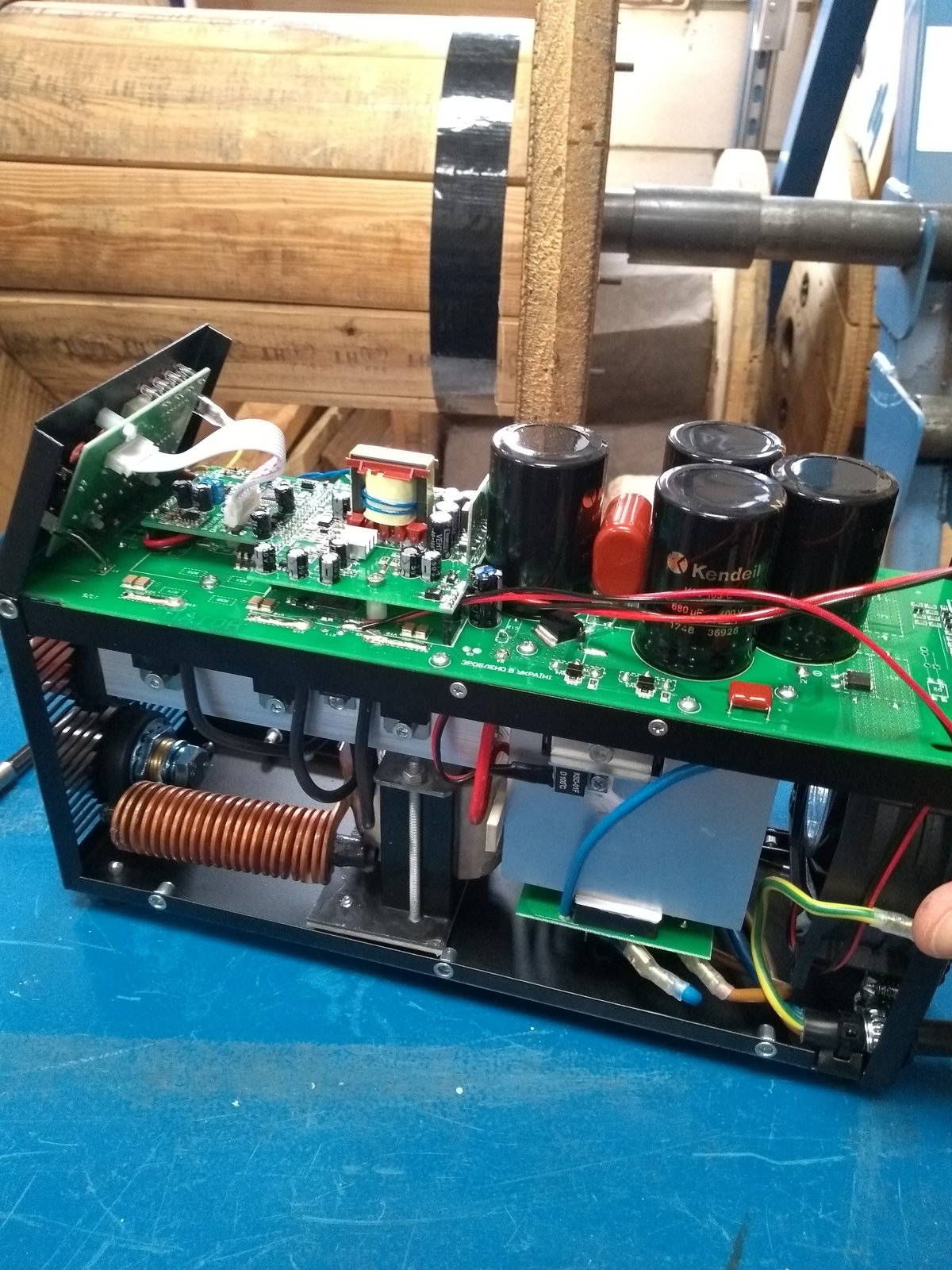

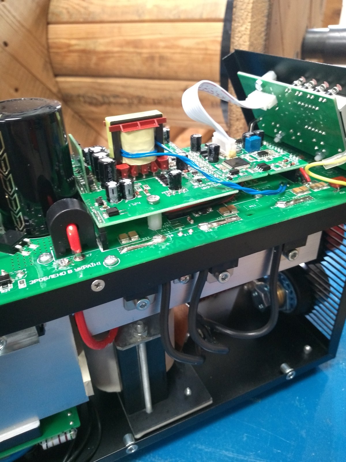

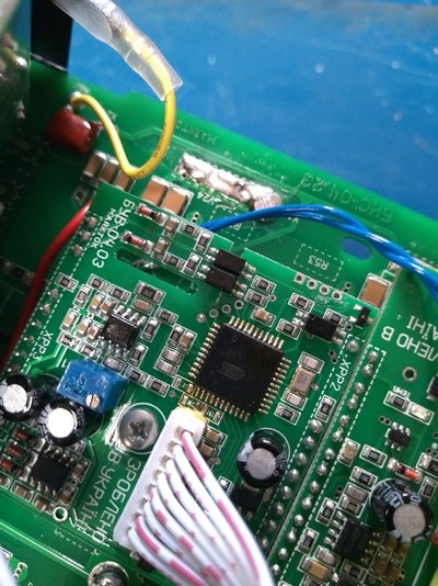

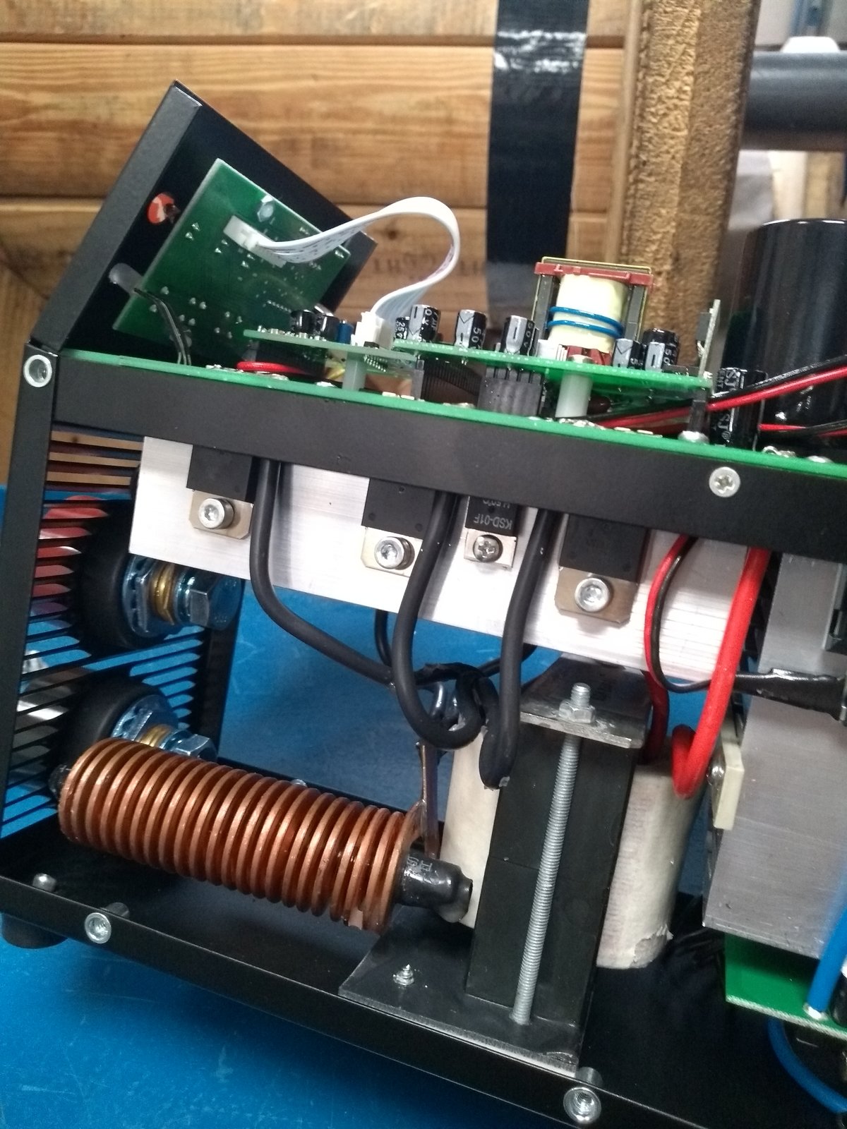

Could you put up some pics of the inside hugh?I would have to check that with a scope and a shunt to confirm...

It's nice to pay Chinese money for better than Chinese build qualityThat looks very well constructed for the price
