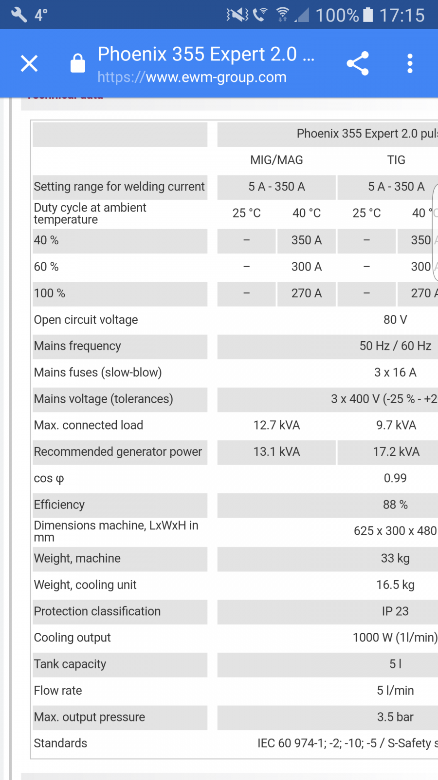

what is the input amps of the machineI can get get a bigger supply from my main fuse board . I just didn't know what and if I could get enough to power the machine
This is the data sheet of machinewhat is the input amps of the machine

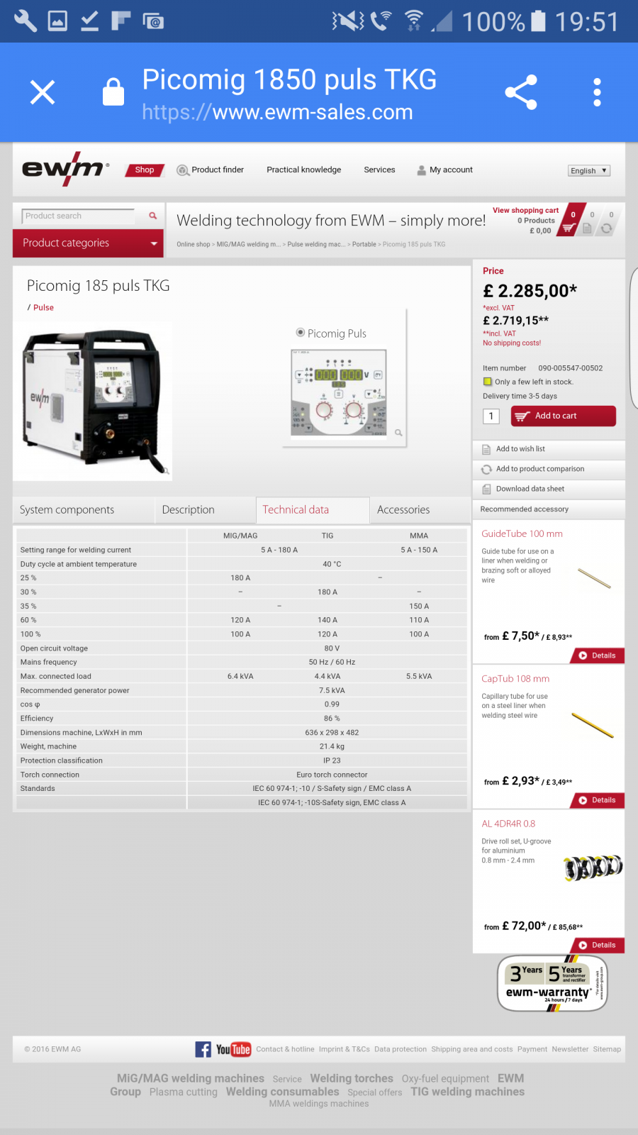

Will have a look..that's a 3phase one what's the biggest single phase they do and its input current draw
That's a 185 machinethat's a 3phase one what's the biggest single phase they do and its input current draw
It's mainly because the stuff I make and have jobs to do will require more bigger machine. I have a lot of lorry stuff to make including tow bars ect. Some materials are 12 and 15 mm thick.What are you welding in your shed that you need something that big ? Unless you have a lot of spare cash you want to burn I would stick with something you can run from your standard supply.

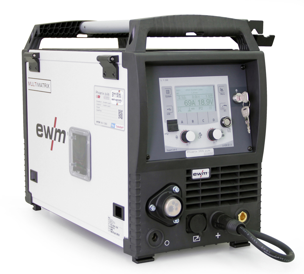

I was looking at a ewm phoenix 355 mig welder.View attachment 100326 View attachment 100327
you CAN get it--- but you won't run it !!
not off 13A anyway you might get the ON light to work ----maybe.
A lot of mine are lost on you lot, also
Yer I hear you Richard....thanks for the help and information everyone it's very appreciated.Spencer your never gonna be able to get 350 amps out of that welder unless you fit a 3ph 32 amp supply as a minimum.
The 185 won't weld 10-15mm plate either.
I'd get a multiprocess machine 230v use the mig for the 1-6mm and MMA for the thick stuff. Sorted![]()
that runs on a 32amp supply so would do fineFew options

Unfortunately all the ewm machines are 3 phase...except the 185 but thatstill to small. Looked at lorch machines to...ewm have 5 year warranty to.
