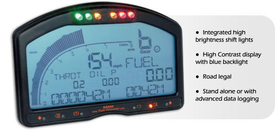

the 4 push buttons to control the digital dash will be mounted up in the right hand side air vent blanking panel.. (i think they scroll through the display screens and control the lap timing functions of the dash)
