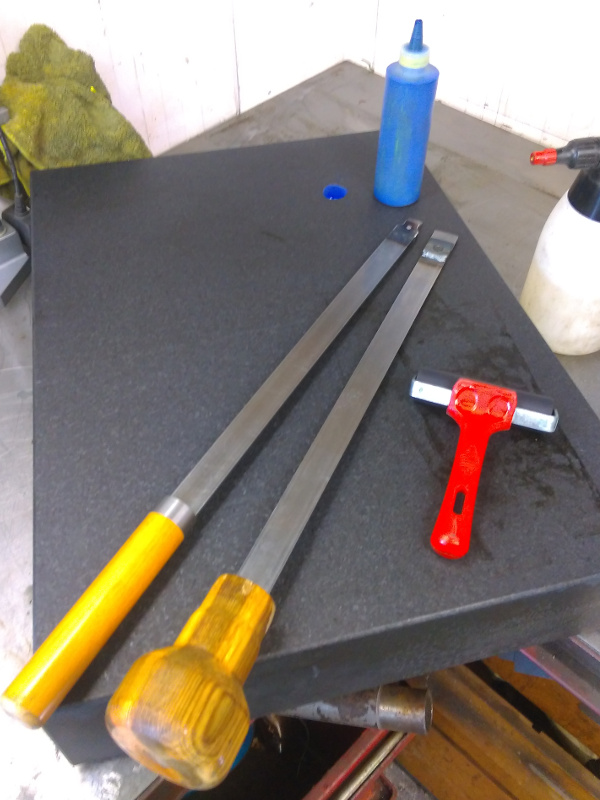

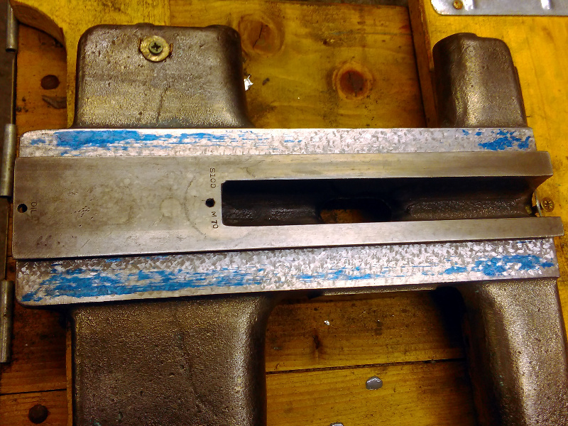

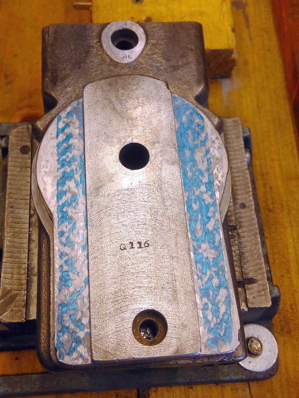

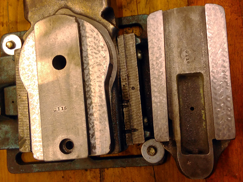

Here are the basic tools I use for scraping. Two hand scrapers, an ink roller, canode blue, a surface plate and a pot of brake cleaner. I've got loads of other including a biax power scraper but these are all you need to get going, plus a couple of medium grit stones.
