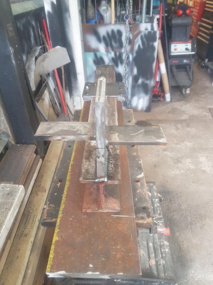

We found that having the wedge on the ram end is great till it hits a knot then kicks and bends the ram. As you’re having followers it may be alright for you - followers weren’t so great on vertical ones as they jammed.
aint that one in the video horizontal also? or am I confused over my plains
My friend built a vertical with the cutter on the ram pushing down onto a table and it works off a JCB hydraulic power pack, It has follower on the splitting wedge to hold it to the beam and is a good home made tool. If it wasn't anchored at the wedge end the ram would lift under pressure. I filmed a bit on my phone of a piece he passed on to me that his wouldn't tackle. It was just a try out and it has been used to tackle bits that are more knot than anything else and we have not found anything it will not cope with yet, green or seasoned. It has a 4 way add on as well for bigger rounds in the vertical position. It came with one table but I made another for the other side just for convenience.
i see now i thought I was going mad! do you make these to sell then?It's horizontal at the moment but it can tip into vertical to do big stuff. Promo video shows it but we only tilt mine for bigger stuff to save lifting.

It will be able to be used at any angle also
