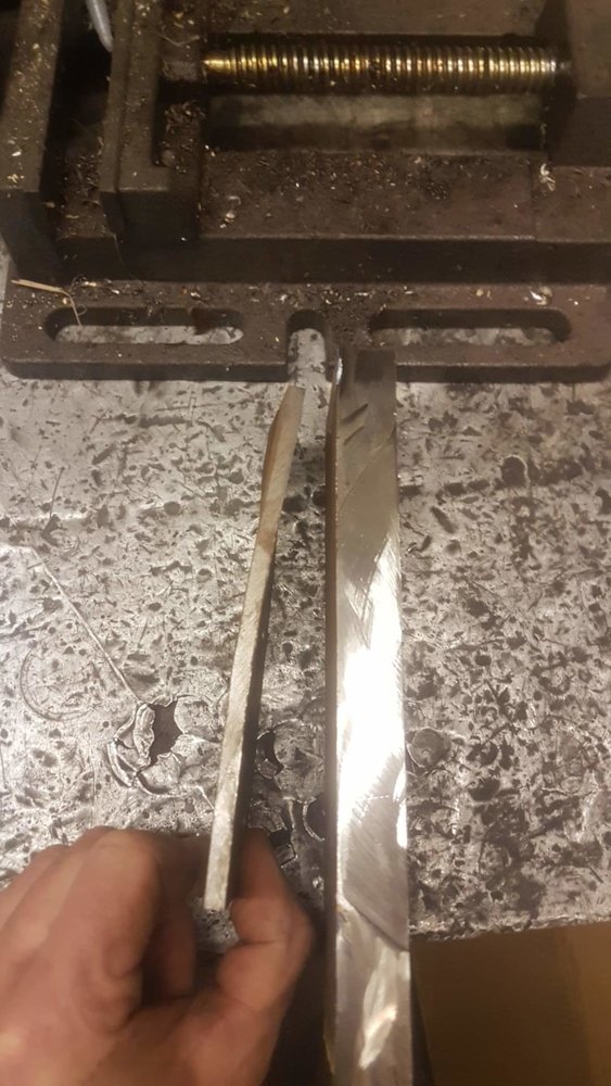

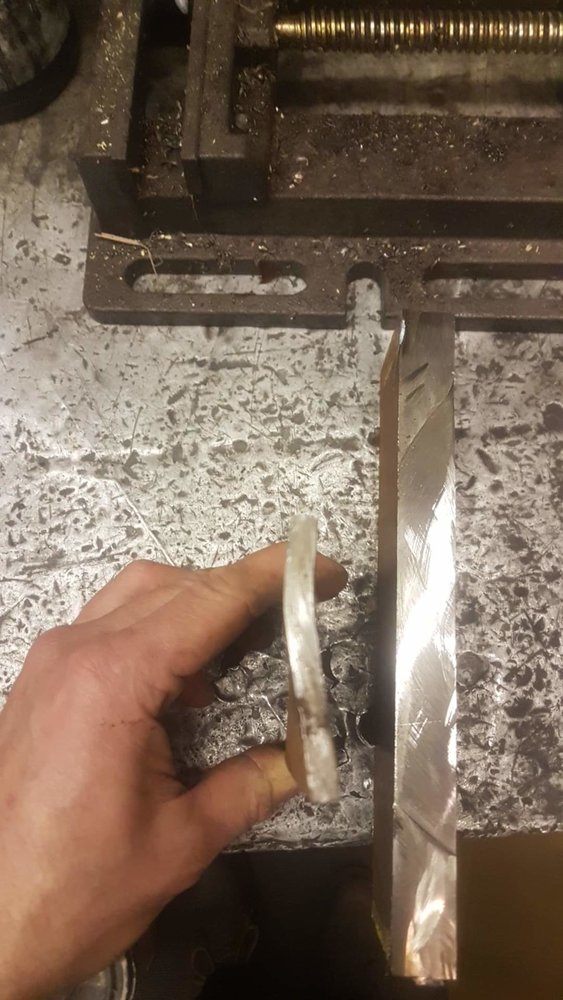

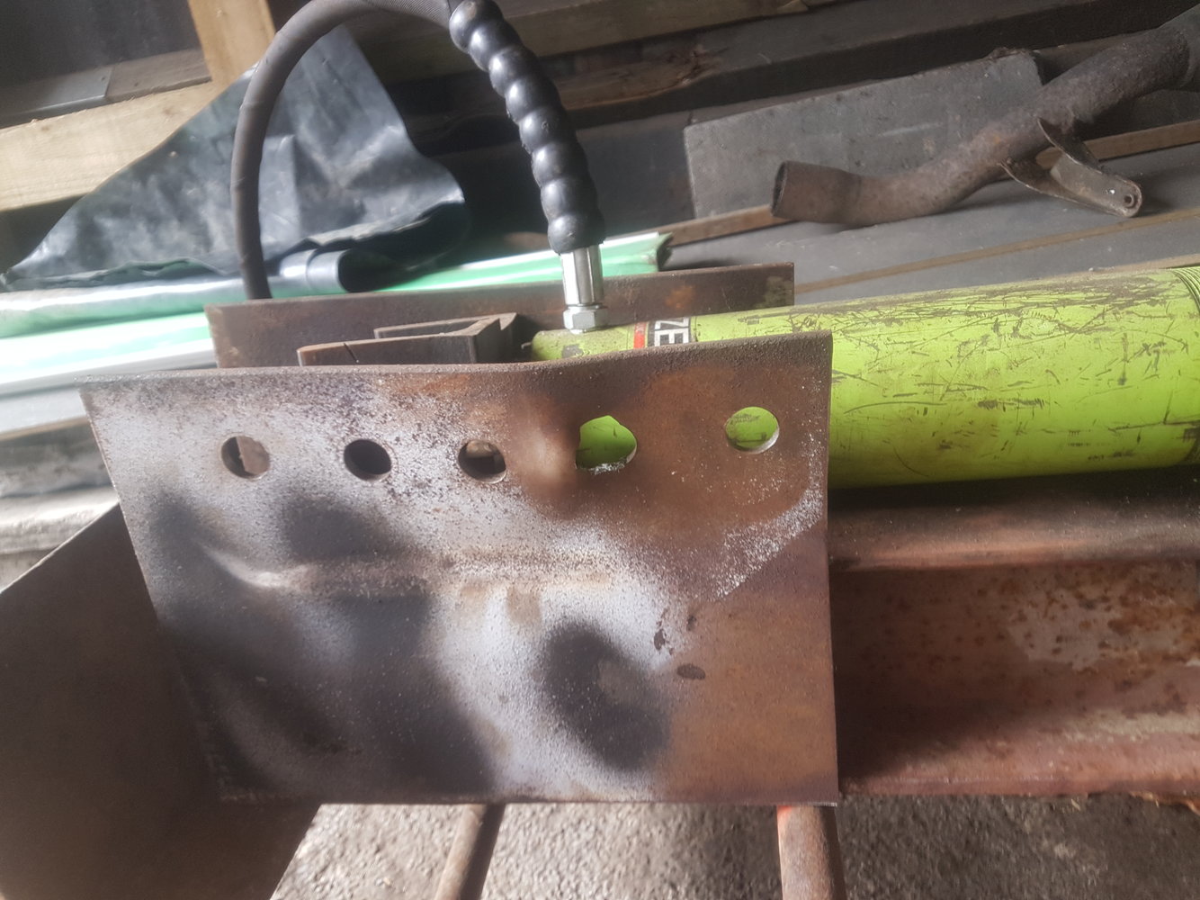

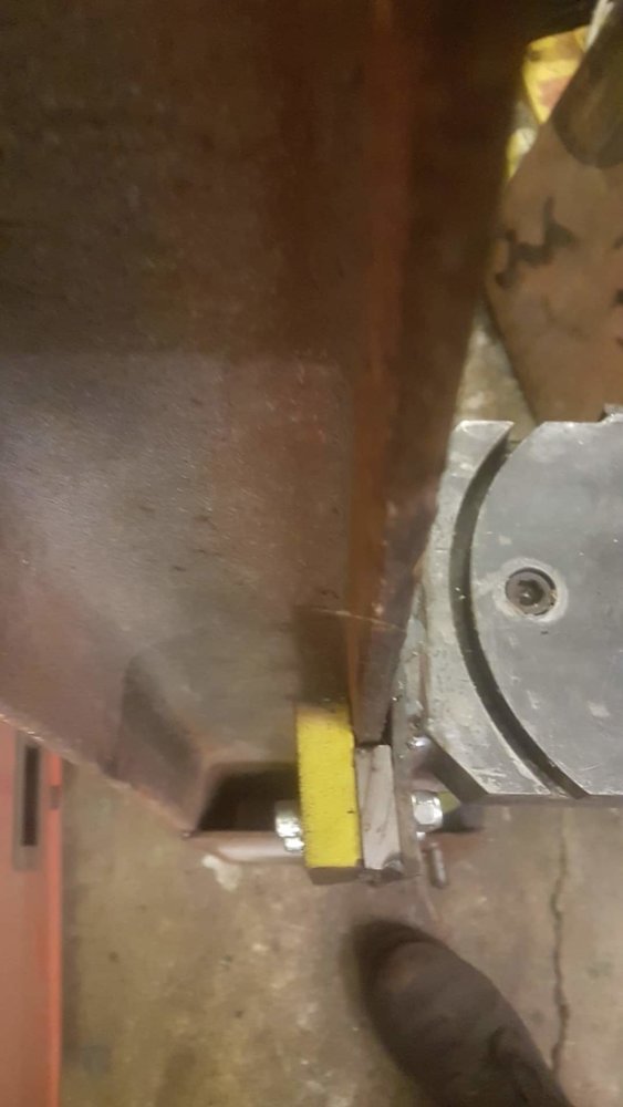

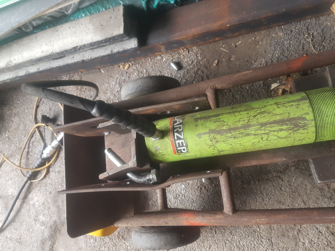

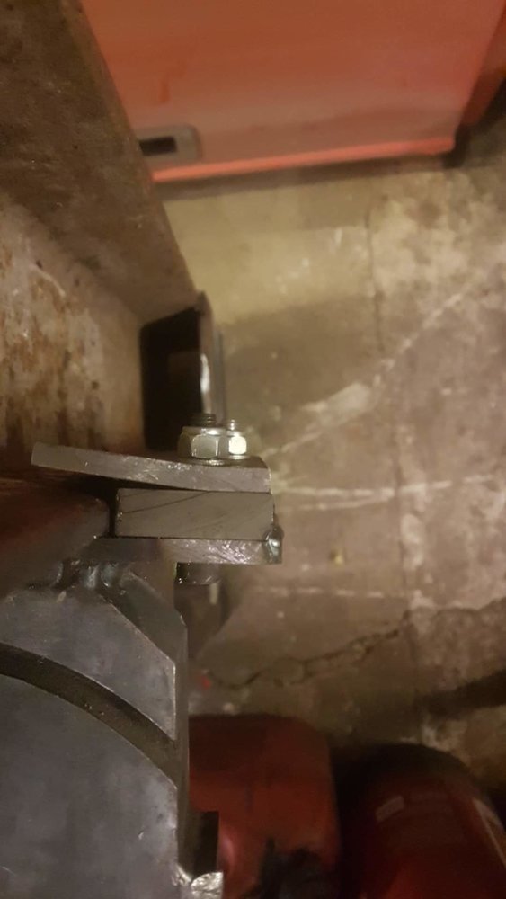

that's not as bad as I expected when you said it was broken :-o

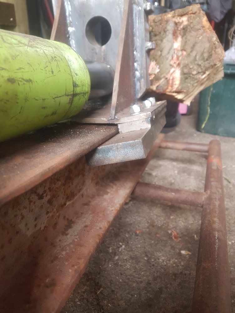

up it to 20mm and make it wider so it sticks out to the sides more so it's not just pivoting/bending around the bolts and it'll be rock solid :-)
behind the ram I'm wondering if you weld a piece to the back of the two pieces to hold them together so they can't bend/pivot if that'll fix your problem... it would mean the bolt would have to shear off instead of bend?
I'd say a bigger pin instead of the bolt too.... but I'm guessing you'd be on forever drilling the holes out?
