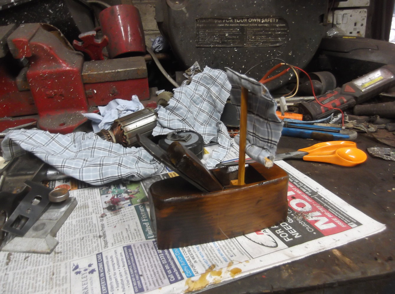

It might be by tonight.But yours is not a plane sailing plane.
I may put wings on one later.It might be by tonight.![]()
But it is wood.I might just put it in a bucket of water. Flood plane.![]()
Cover it in a milled grain.Put it on the side of a hill and make an inclined plane...

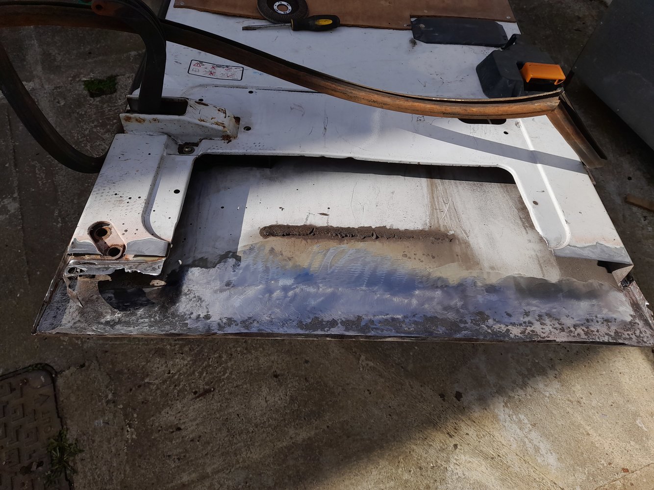

It is very satisfying repairing rear doors,I've removed and started repairing one of the rear doors on my LDV Convoy today.
Bottom of the inner frame has rotted out, and the door skin is pulling away, s the bottom partof the door flaps about.
I've cut away the corroded part of the bottom door inner and ground the door skin back to clean metal.
I've plug welded the remaining frame and door skin back together, and plug-weld plated the bottom of the door skin with new plates with folded edges to strengthen the bottom of the door skin.
I just need to make and weld in a new bottom frame section to complete the metalwork repairs tomorrow.
Very happy with the performance of my Oxford MigMaker 180 today - its really been great to use & helped my inexperienced efforts no end - it's helping me improve.
I've also used my recently aquired air reciprocating saw - and that's proving to be a useful bit of kit too.
It's a 21yo LDV Convoy... so aesthetic qualities are arguably moot . Even new few people considered the Convoy a handsome vehicle... and the years mean the body on mine is looking a bit... tired.It is very satisfying repairing rear doors,
It makes so much difference to the look, from the rear
They look better,
They work better,
Job done![]()
