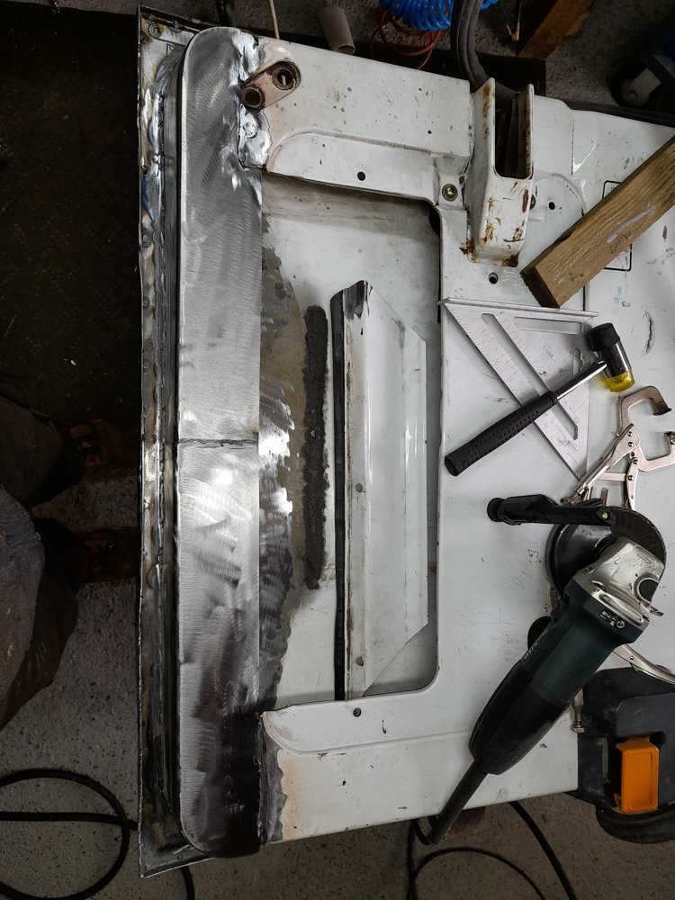

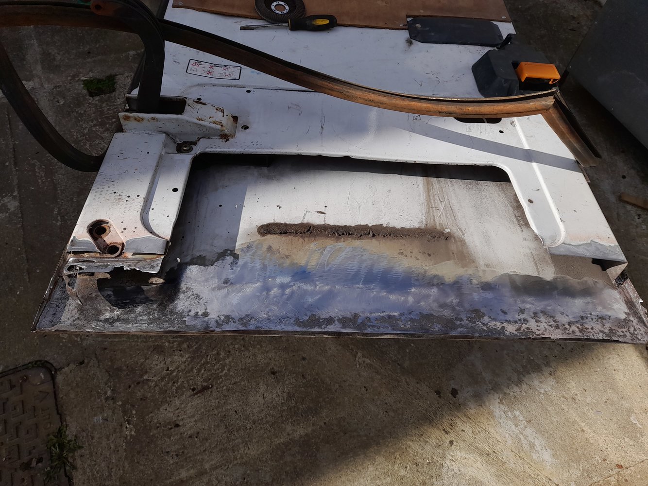

It is very satisfying repairing rear doors,I've removed and started repairing one of the rear doors on my LDV Convoy today.
Bottom of the inner frame has rotted out, and the door skin is pulling away, s the bottom partof the door flaps about.
I've cut away the corroded part of the bottom door inner and ground the door skin back to clean metal.
I've plug welded the remaining frame and door skin back together, and plug-weld plated the bottom of the door skin with new plates with folded edges to strengthen the bottom of the door skin.
I just need to make and weld in a new bottom frame section to complete the metalwork repairs tomorrow.
Very happy with the performance of my Oxford MigMaker 180 today - its really been great to use & helped my inexperienced efforts no end - it's helping me improve.
I've also used my recently aquired air reciprocating saw - and that's proving to be a useful bit of kit too.

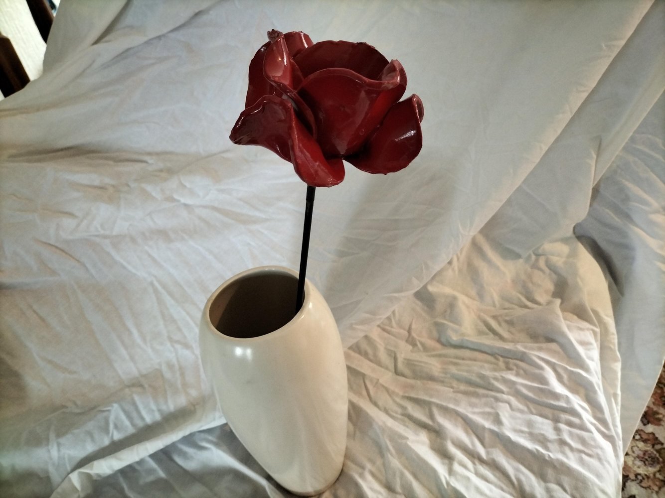

We bought one but not seen it since the move 6 years ago, must hunt it down again!Not welding I'm afraid. In 2018. There was an art installation at the tower of London with lots of ceramic poppies in it. They were sold afterwards. I volunteer at a repair café. Two of them appeared both broken. One had all the pieces so I just glued that back together. The other one had bits missing. I had to rebuild them with Milliput. The photos are before I painted it. I had to colour match the red. It's close enough. I'll post the finished job when the paint is dry.View attachment 336457View attachment 336457View attachment 336458
