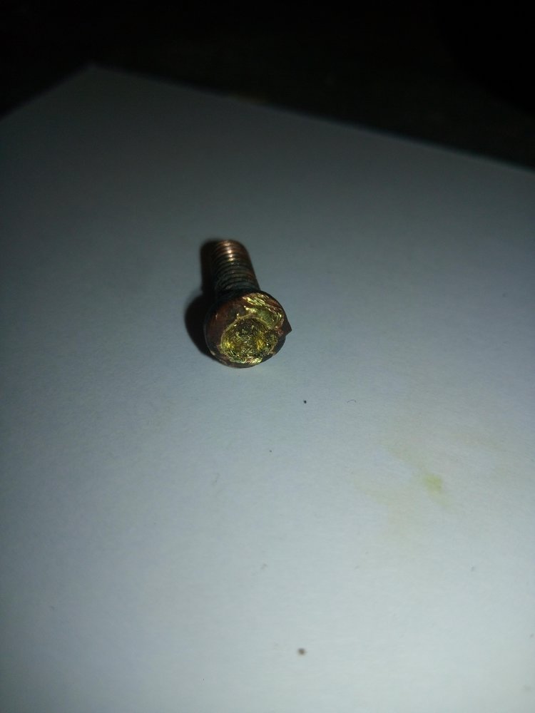

At least it wasn't countersunkSo, I was asked to go change an impellor, on a small marine diesel engine in a sailing boat this morning.
Not really interesting, normally a ten minute job.
However sailing boats are really irritating to access the engines.
Down the steps, pull the steps out, access to the front of the engine, six hex bolts on the face plate, pop out impellor, replace impellor, replace gasket and faceplate... Take the money, plus time going there and back and runaway...
Oh no, not this morning.
Down steps, open lid on bottom step, 6" square hole.
Marine cooling pump visible with a torch.
Horror.
Cross head brass screws, painted over... Argghh.
Five out of six came out with only mild swearing.
No. 6 had been overtightened, and the cross head had been rounded out.
40 minutes later, two options :
Rip it off, and hope whatever's left can be tweaked out, with mini mole grips.
Or engine out.
Tried unscrewing it with my knipex adjustables, and after 45 minutes, victory.
Here's the little fellow.
Then they took me to lunch, yay !

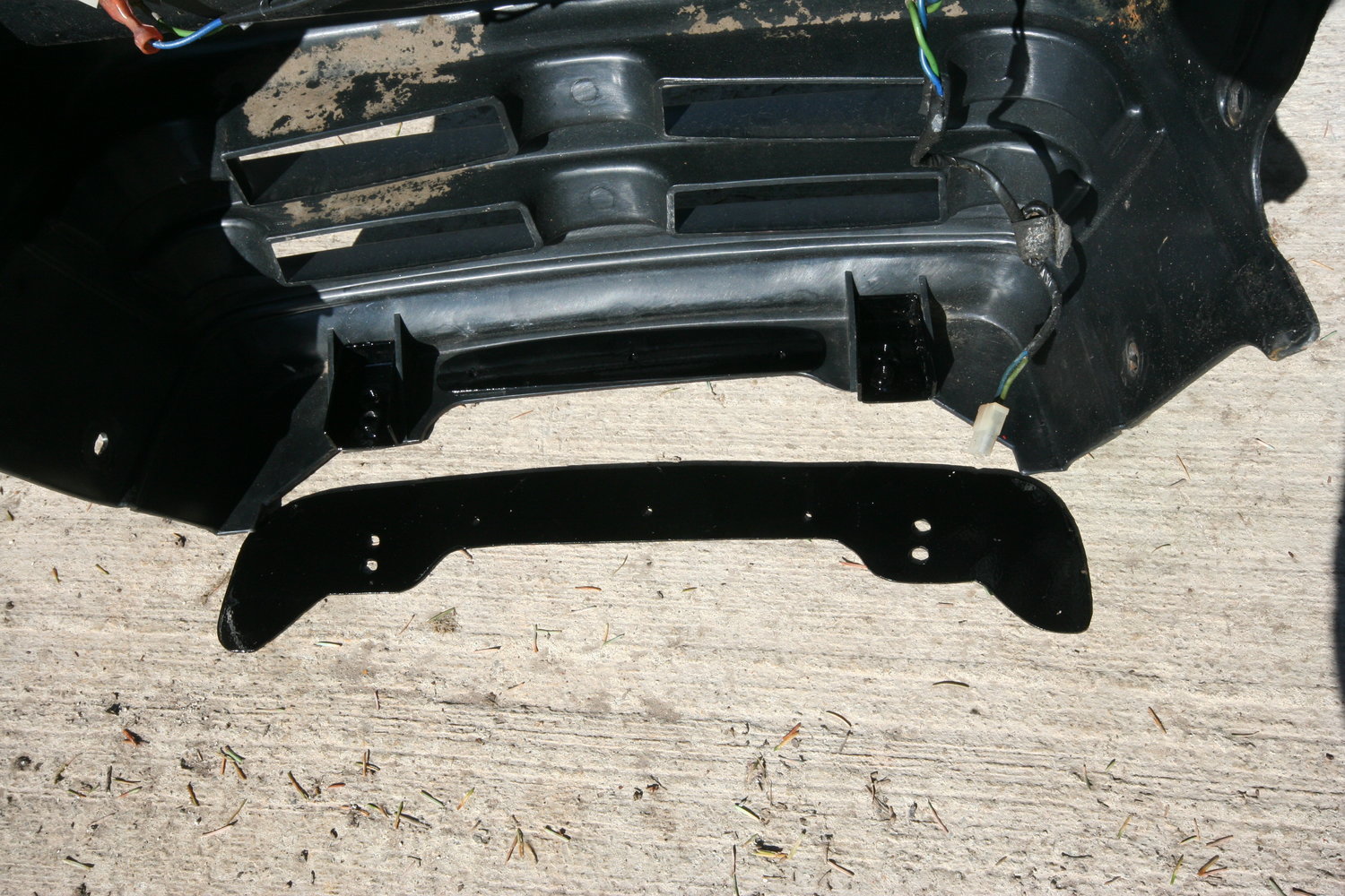

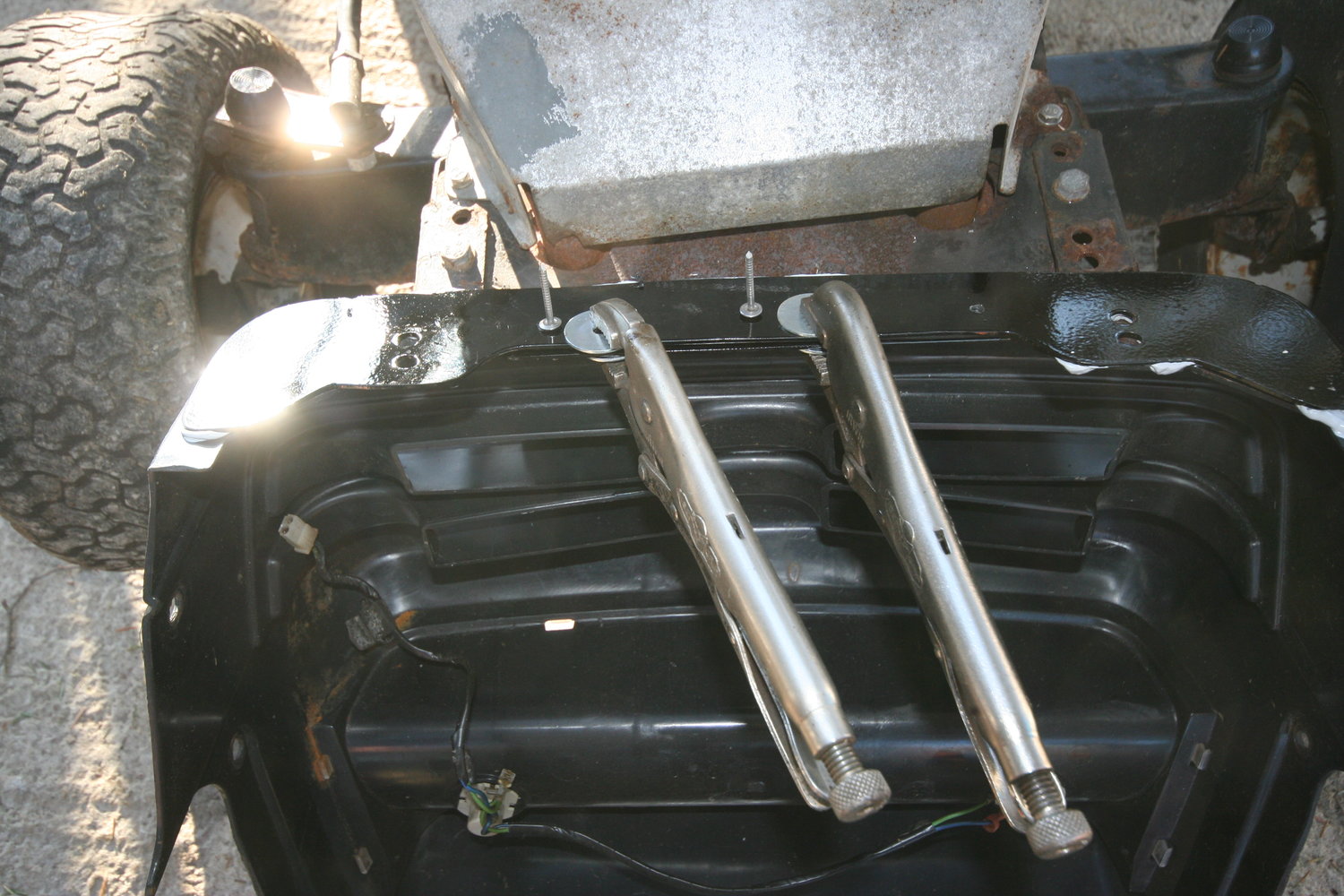

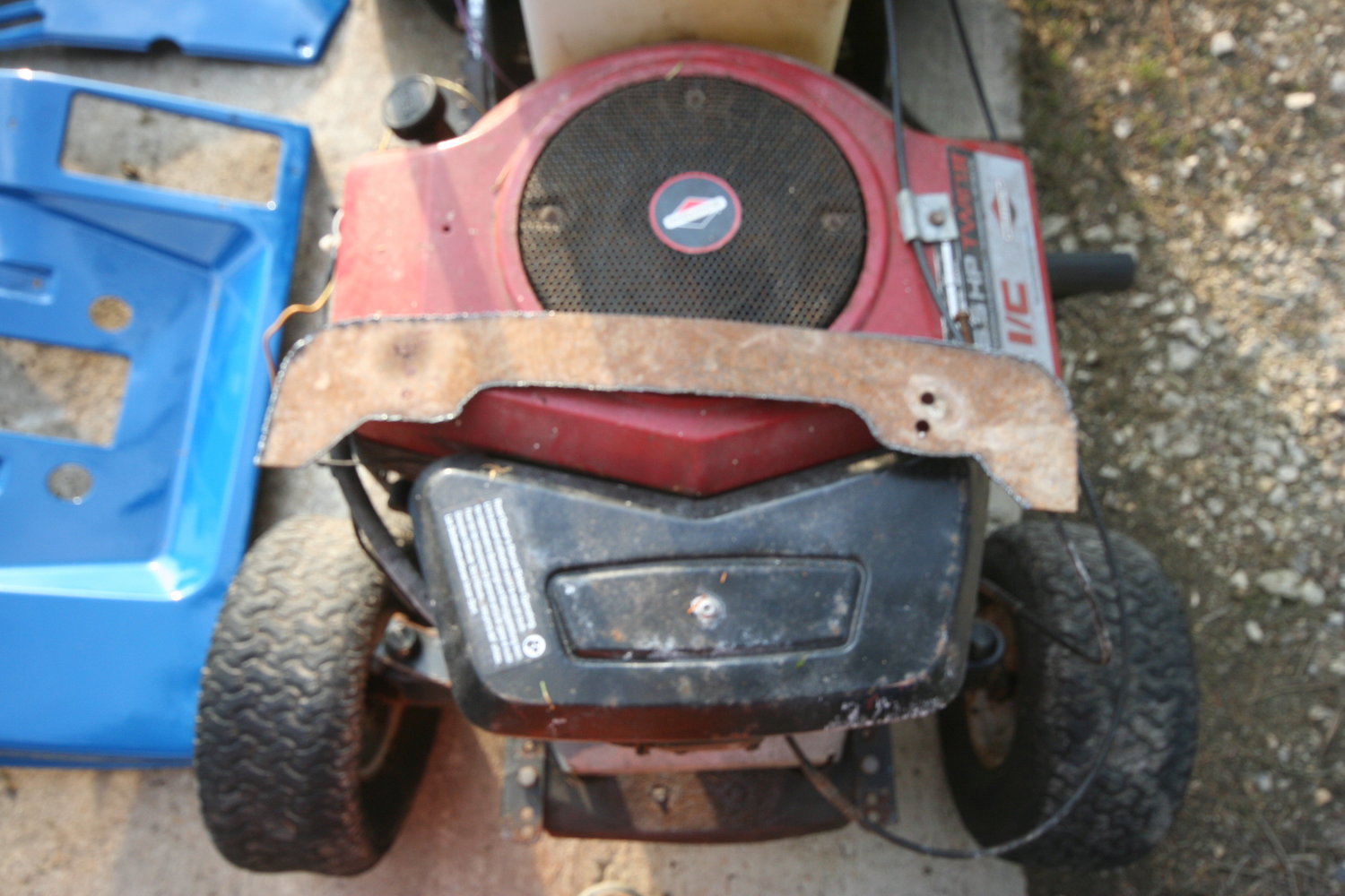

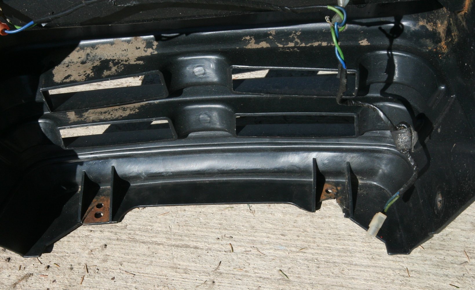

Don't bother with sikaflex in future, all modern PU gloops are as good and cheaper.Not today, I lost a data card and it's just turned up, but a couple of weeks ago I did a few more repairs on my late 80s MTD ride on.
The plastic nose section has always been loose and I botched it with mud guard washers which lasted fine for about 10 years.
As I had it apart for painting, I thought I'd I fix it properly because it would make it easier to take on and off (which you have to do if you want to work on the carb etc.)
On the bottom of the nose cone the mounting bolts holes had cracked or broken off.
I made up a couple of boxes out of 2mm plate and welded a couple of nuts to each.
Then cut out 2mm plate to strengthen the bottom of the nose cone.
I even gave them a blast and a lick of epoxy primer and 2K top coat.
Then stuck them on with sikaflex and a few stainless pop rivets.
These rivets are normally a pig to set but the air rivetter I got on here made short work of them, brilliant tool.
Then just bolted the nose cone on and let the polyurethane cure.
Should be good for another 10 or so years.

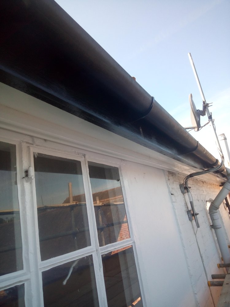

I see capillary action of water in cables quite often, once had someone's TV aerial cable dumping water in their lounge from the roof!A temporary fix, at least

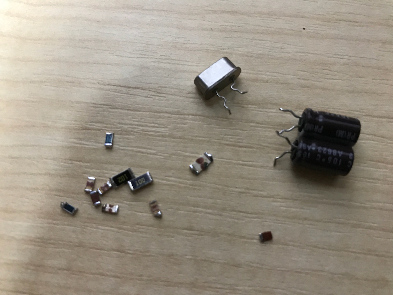

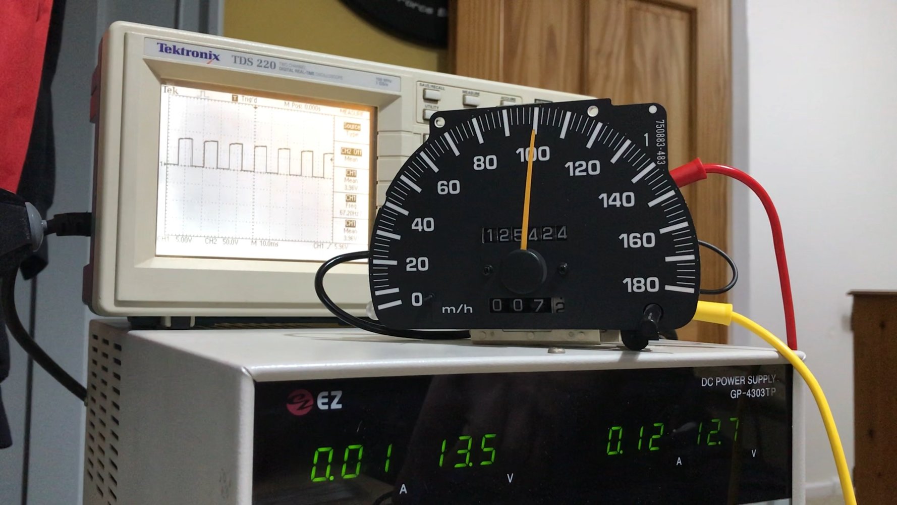

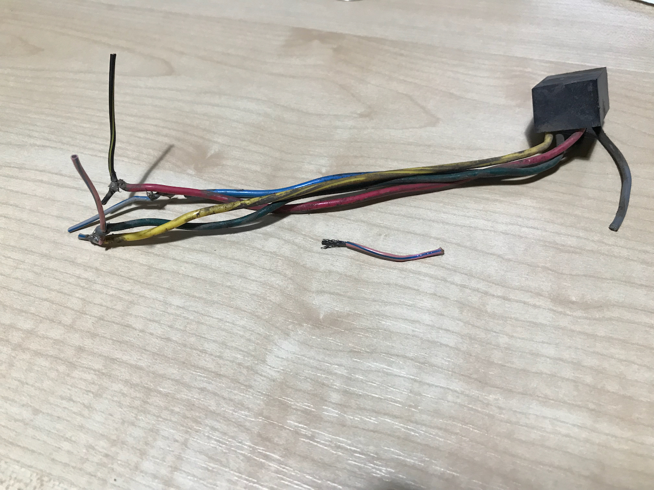

The speedo on the Surf died, and judging from Surf forums, it's quite a common complaint. It's a doddle to remove the instrument cluster, so did that and extracted the speedo. I'd expected the electrolytic caps to be leaky, but they looked fine. Anyway, I had a good portion of the components knocking around, so replaced them anyway.
The dark spots on the bottom of the surface mount resistors are glue, don't often see that used in SMD assembly. I did find that one of the 1206 decoupling caps was cracked in two, so that won't have helped things.
Hooked it up to a pulse generator and cycled it up and down, all working nicely
Whacked it back in the truck, jacked up the rear axle, gave it a test – and it was now only intermittently dead
With it being an import, I'd expected to find a km/h to m/h pulse converter behind the dash, especially as there was a black sticker covering the 'k' of km/h on the speedo dial. Did a few more tests and confirmed that when the speedo 'died', it was due to a lack of pulses from the sensor on the transfer box.
Crawled underneath, started to trace back from the sensor, and found the pulse converter taped up with the wiring! Who in their right mind thought that was a suitable place?! They'd soldered the connections to the loom, but just stuck a tiny bit of insulation tape over each connection. Decided to cut out the converter, and restore the loom back to how it was originally, just so that the speedo would work (albeit in km/h, for now). Snipped through the cables, started to strip them back, and saw the copper strands were all corroded – wonderful! Water must've wicked along the wires.
Ended up removing the plug from the sensor, de-pinned it, and soldered some new wires to the crimp terminals. One of the terminals had started to corrode inside the plug, as well. Also noticed that the locking tab was non-existent on the speed sensor socket! So now I have the plug with short lengths of wire attached, back under the truck to hook it up. After cutting back the wires of the loom a couple of times, they're all still corroded. No chance of soldering, so ended up using crimped splices, covered with adhesive lined heatshrink. Used a few cable ties to make sure the plug can't come off – the missing locking tab worried me.
A quick test drive, and thankfully, everything is working again, just in km/h.
Time to order a new sensor and plug, then I'll replace this whole section of loom properly. Just wish the original importer had done a proper job, not a bodge!

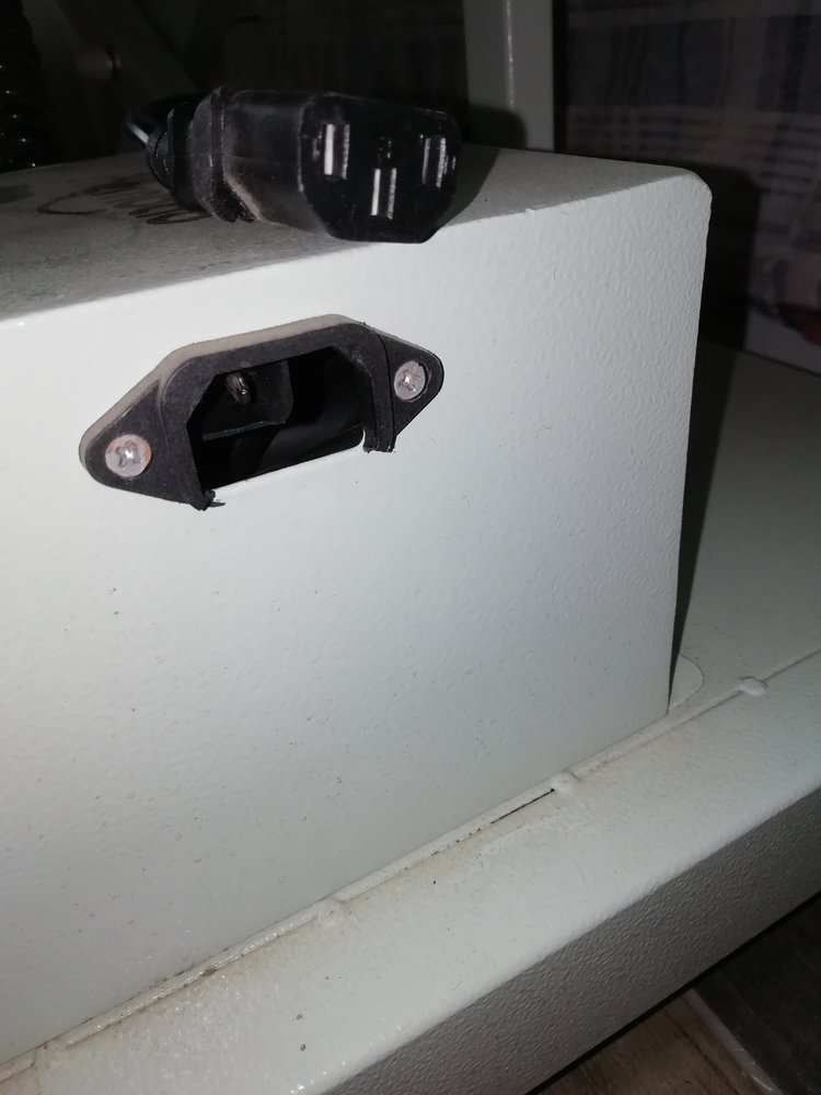

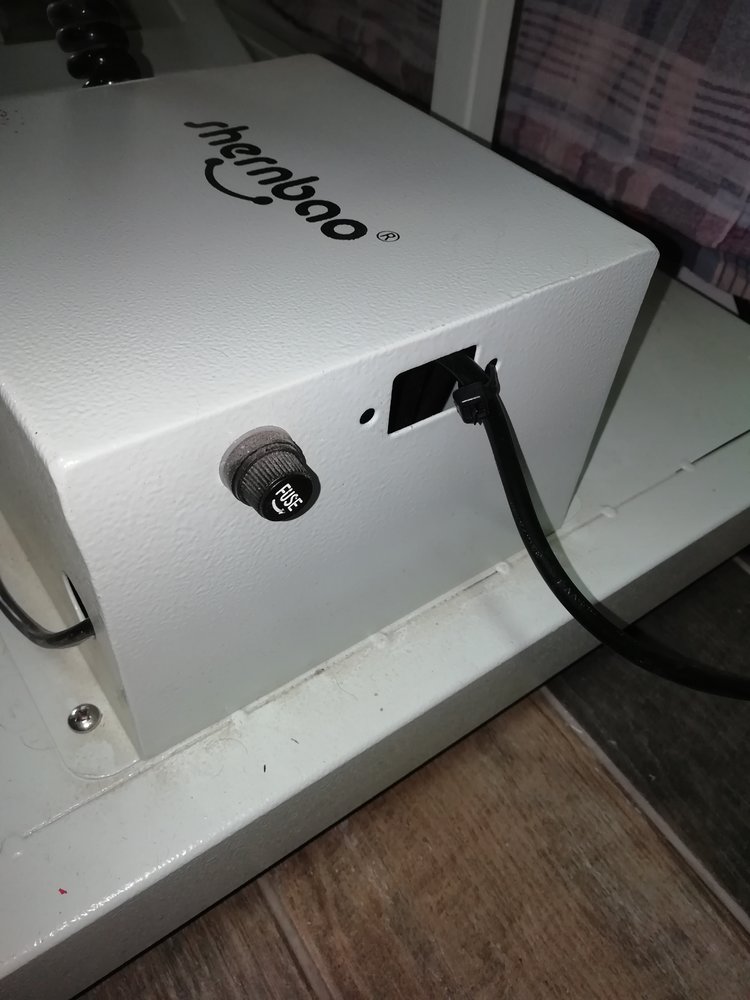

Got a box full of em here.So it starts with "can I bring a screwdriver in" which doesnt really narrow the job down, turns out the IEC socket on the side of the grooming table has been mysteriously smashed off! not much chance of getting one on a bank holiday weekend but luckily it was only the flange broken off so I cable tied the plug and remains of the socket together and poked it all back in the hole with a cable tie for strain relief until I can order another
