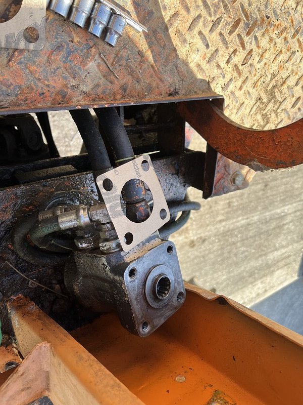

So today stripped out the unit from it's mountings, made a few measurements, I fired up autocad, draw up a flange gasket, ported the DXF to my laser cutter, cut a gasket, dragged out an old tube of Blue Hylomar and stuck it all back together.
Early days but so far no leak - I'll wait for the oil to come out of the top of the steering column but I don't think the leak is on the pressure side so it should only fill up to the level in the hydraulic reservoir !
