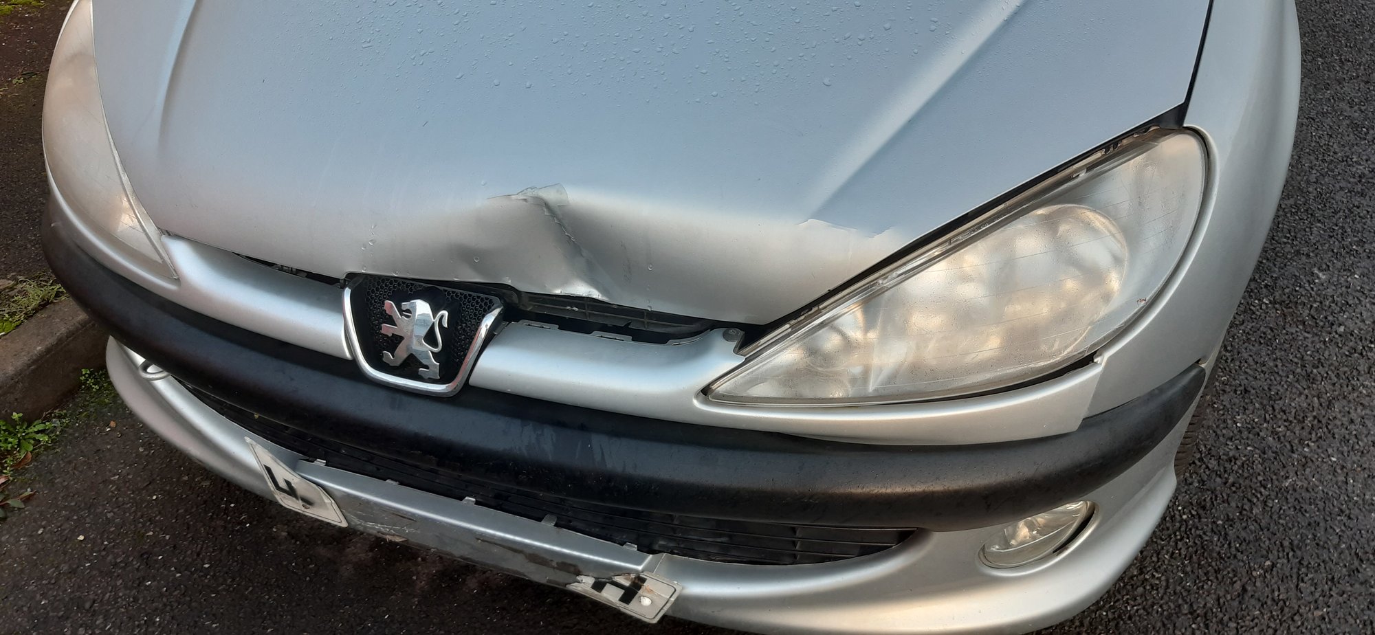

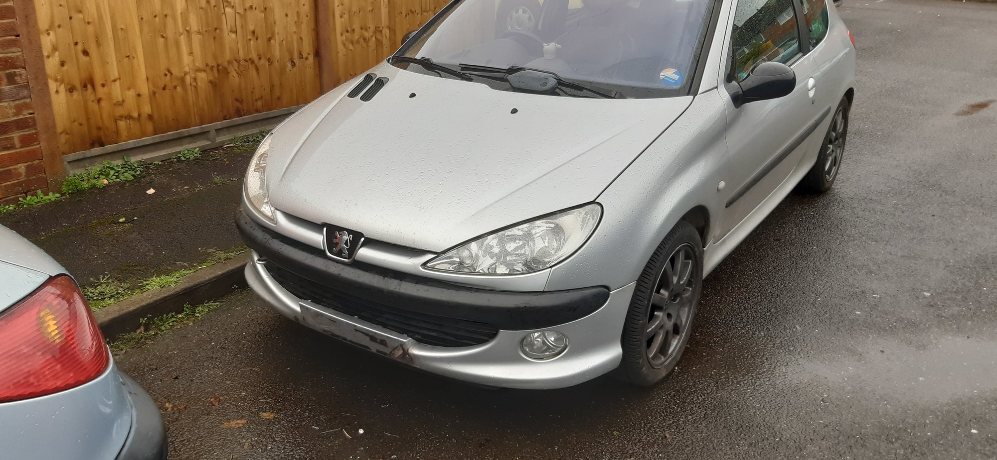

Did you get bonus bambi in the freezer?!Mrs DanZac had a close encounter and lucky escape with a deer earlier in the week on the way to work.
A slog round the local (and not so local) scrappies yesterday provided a bonnet, front grill and trim panel, and a radiator fan assembly, handily all in the right colour.
And a couple of hours in the drizzle this morning and it's good as new. £100 all in, got to be happy with that.
I did ask her that, I thought it would make a good Christmas dinner, but she didn't seem best pleased.Did you get bonus bambi in the freezer?!
Just don't let her venture out sans reg plate, or Mr Plod (or ANPR)'ll have her.

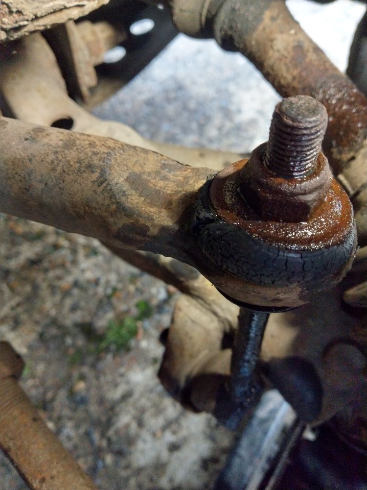

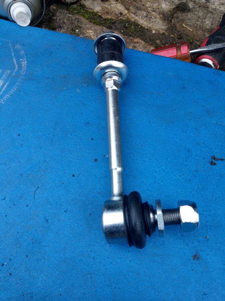

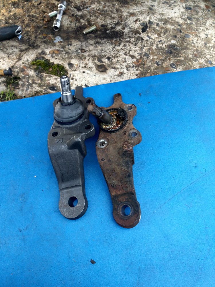

Have you not perfected the hammer/twin hammer technique of splitting ball joints and tack rod ends?I did some fixing on the Surf today, I had a few advisories on the MOT so ...
New bottom ball joints,.
New drop links.
Check & clean the front brakes as I have a fair bit of judder when I brake.
The old ball joints were covered in grease but I couldn't see any splits in the gaters They were split by the time I got them off though! I had to modify a brand new Lazer ball joint splitter as it wasn't quite wide enough to fit over the shaft, a bit of angle grinder and file action sorted that and it was very good at popping both the ball joints and the tie rods off! Well happy with that.
The drop links were easy.
I measured the disc run out and the nearside is at about 0.03mm the offside is about 0.1mm, the limit I'd 0.07mm so new discs and pads to come. They are nowhere near worn out though!
Mmm not sure weather to go for genuine Toyota ones at £170 a set or EBC at about £125?
The brakes have never been great on this truck.
Then I helped a neighbour put up the Christmas lights.

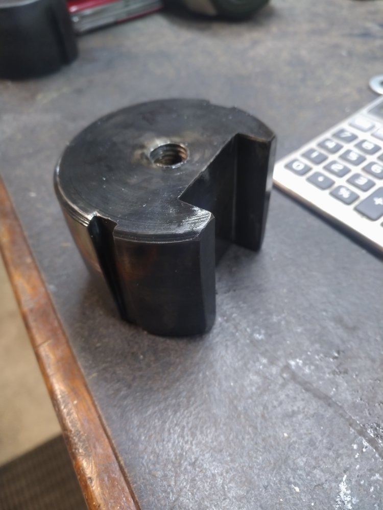

That’s how I split them, shown how to do it many years ago. I have also made a hammer end to one of the chisels of my air chisel set. I welded a nut on the end, filled in the end & rounded it off, this I did thinking it would be an easy way to split joints. I’ve used it for various thing now, but never used it for a taper joint as I haven’t needed to take one apart since.Have you not perfected the hammer/twin hammer technique of splitting ball joints and tack rod ends?
Crack the side of the housing where the taper goes through, both sides at the same time if you are good, one side if you aren't (me) and assuming you've removed the securing nut first, the shock will release the taper, without damage to the boot (unless you hit it with the hammer) - my pickle fork and screw-type splitter have not been used on a ball joint for 30 years since I learnt that technique from someone.
