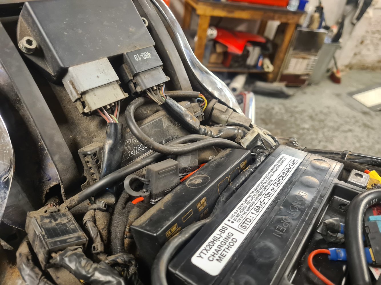

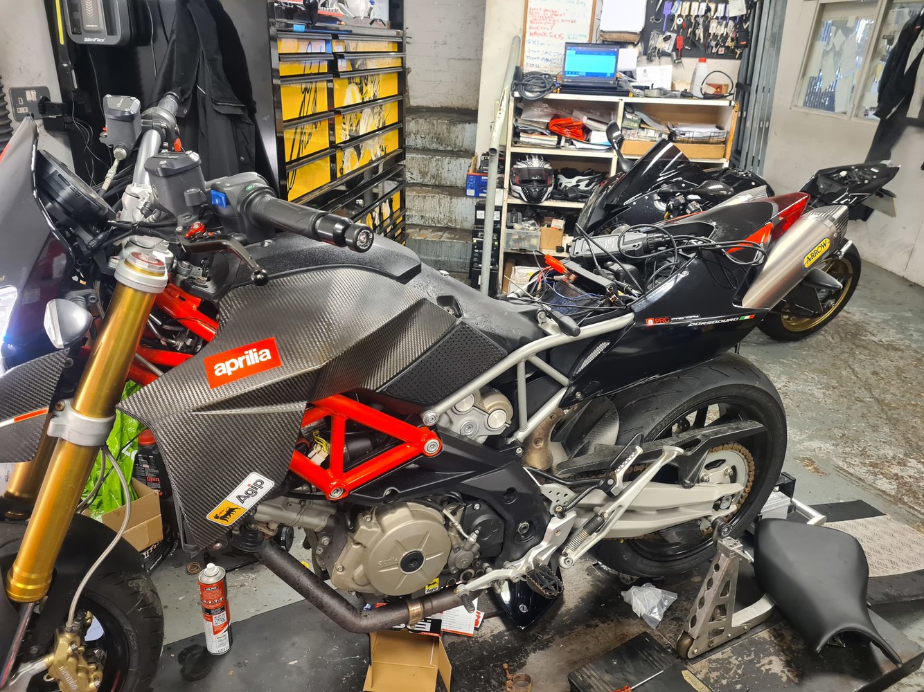

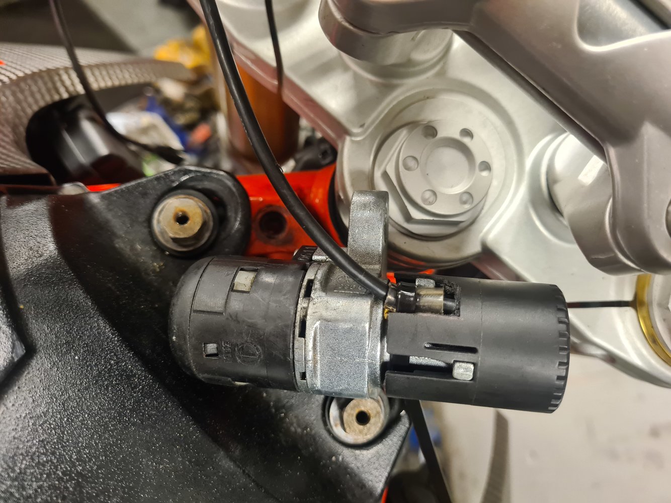

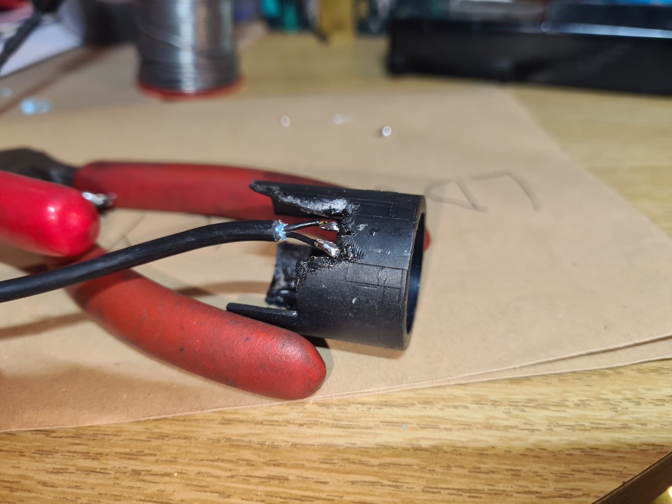

Had a Dorsoduro in last days before we broke up.
Lad had had it "serviced" somewhere else and instead of removing ignition to remove petrol tank they ripped his immobiliser antenna off (pure laziness imho).
Gave him a none running bike back and an apology, unbelievable really).
Can't buy the antenna seperate from a full lockset
, which in itself is stupid really. £350+vat and no availability.
Managed to repair it for him, classed it as temporary repair but will probably see the bike out now.
Just can't believe how he was treated by the last place personally!
