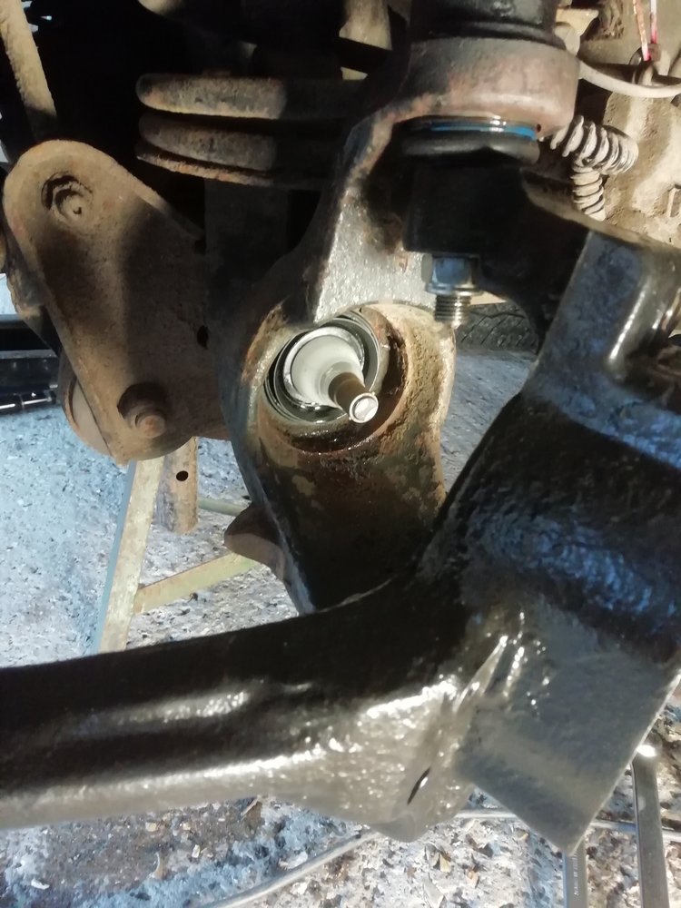

It’s like the mechanic version of those A&E horror storiesWell how about that, a 25W SBC candle lamp is the perfect size to stop the oil leaking out of the drive shaft seal on a Discovery 2, PM me for prices on this very special tool that you wont find in the Snappoff catalogue!!
That is genius mate
I am thinking of a modified version with lampholder and flex to aid recovery if it slips inside!It’s like the mechanic version of those A&E horror stories
I was using a lightbulb to seal up a drive shaft and slipped…….
And using it as a work light as well, dual purposeI am thinking of a modified version with lampholder and flex to aid recovery if it slips inside!

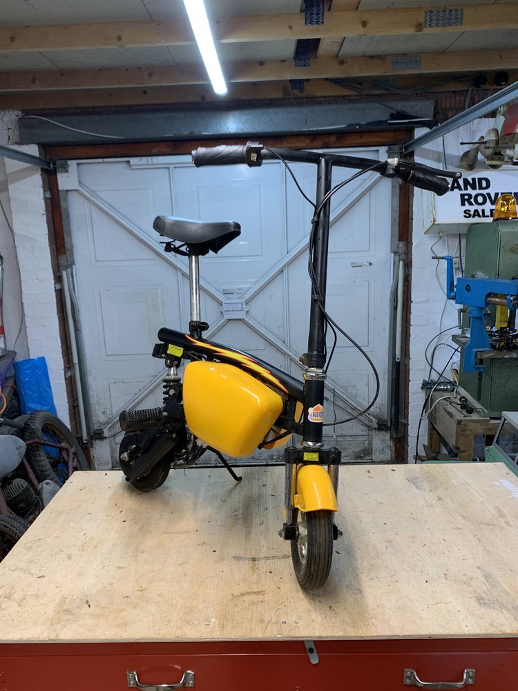

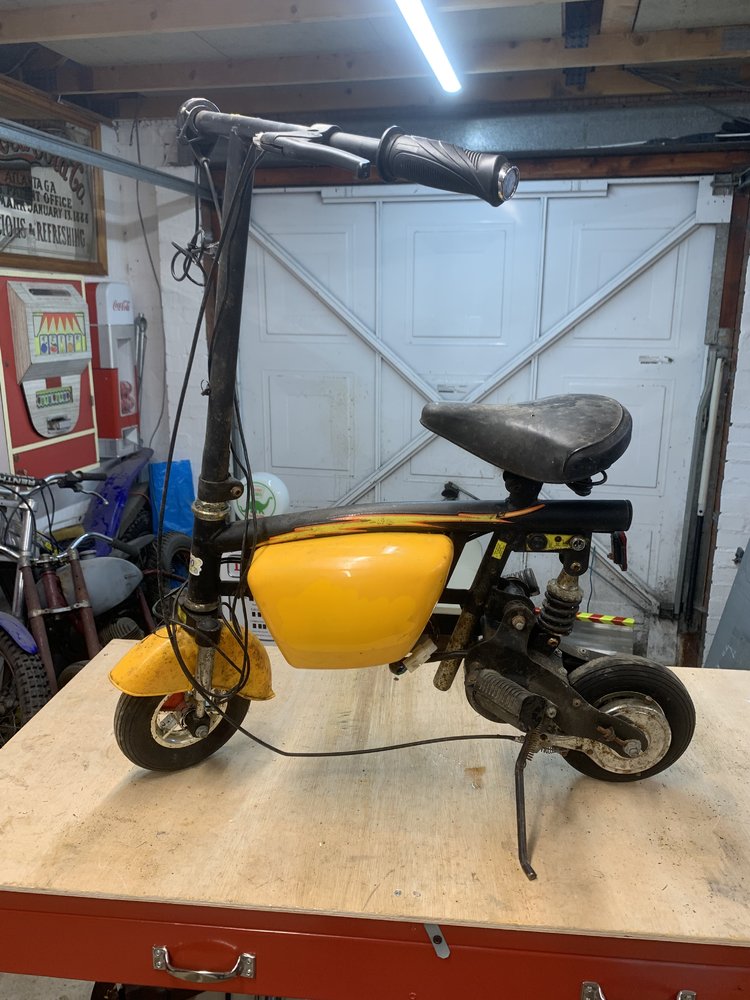

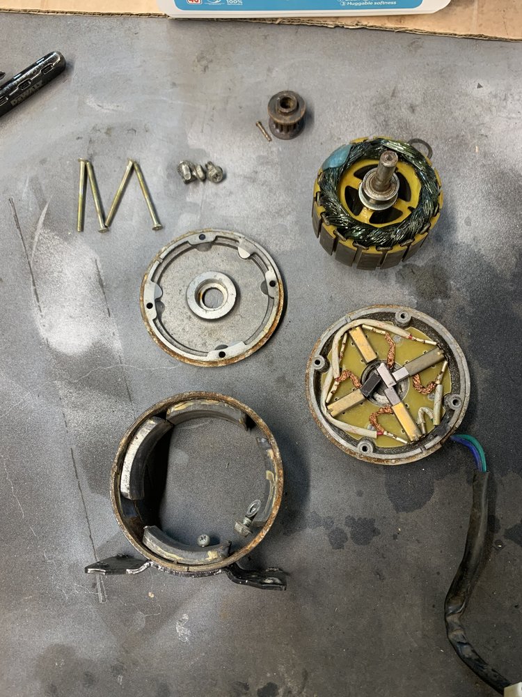

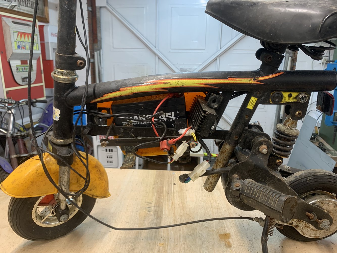

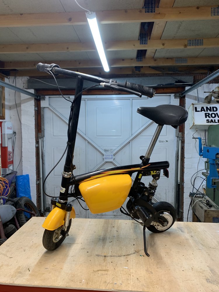

Your pictures don't seem to have loaded successfully.Bought this at a motorbike jumble in Lanark a couple of weeks ago as a non runner for £20. Needed batteries and a charger, apparently, but came with a new throttle. If it wasn’t salvageable it would be hung on the wall or scavenged for components..
Ordered a pair of new batteries, and after a bit of intermittent hesitation it worked, and would trundle me along at a reasonable rate. The motor was a bit grumbly, so I assumed the bearings were on their way out.
My sisters kids wanted a shot, but the bike had other ideas. When switched it on, it would instantly supply full throttle to the motor and take off.. Glad it didn’t lock on whilst they were riding it…
We looked over the connectors, which were all good, but were unable to assess the motor controller’s PCB as that was sealed and encased.
We moved onto the motor, thinking that perhaps the ‘grumblyness’ had caused a build up of resistance in the motor, causing a surge through the PCB (pure speculation on my part, I’m not very clued up on circuits..) so as an educational exercise for them we took the motor apart.

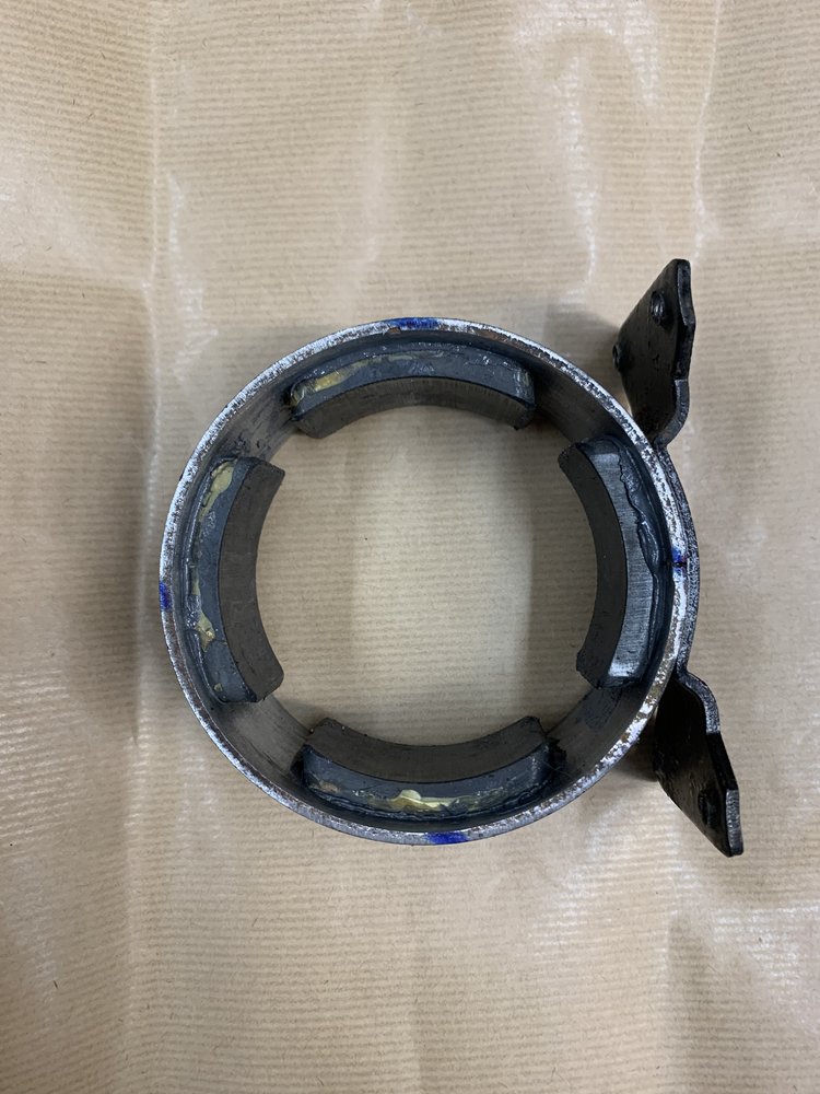

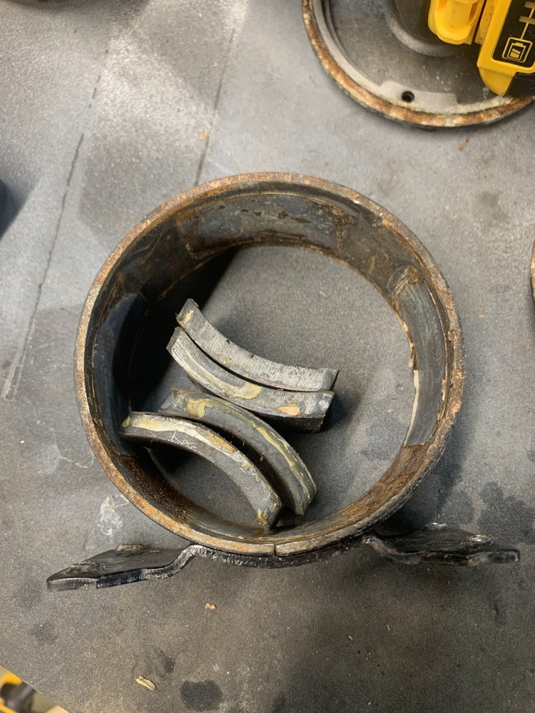

Turns out the bearings were fine, but the field magnets had separated from the outer casing, and when spun with the rotor, was causing the noise. We were faced with the decision, buy a new motor (at which point I’d want to then paint the bike..) or try glueing the magnets back on to see if we can fix the issue. The kids opted for the latter (perhaps driven by schools now educating on sustainability?), and disappeared off home leaving me with the mess.
I ground the old glue off the casing, and bonded the magnets on with some JB Weld. The motor was reassembled, tested in isolation with a battery, and replaced in the bike.
The original motor controller was found to be inoperative, so I ordered a comparable unit from eBay and made it work, less the charger.
The bike now operates as it should, has been given a good clean and polish, and a sign of approval from the kids. Even their old mum had a shot!

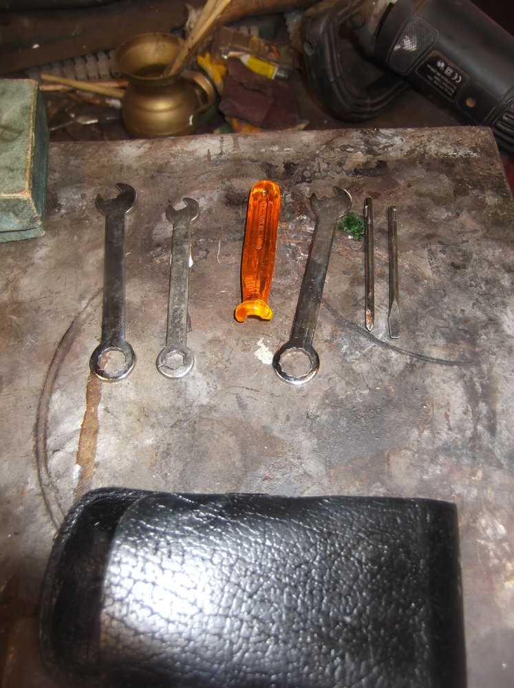

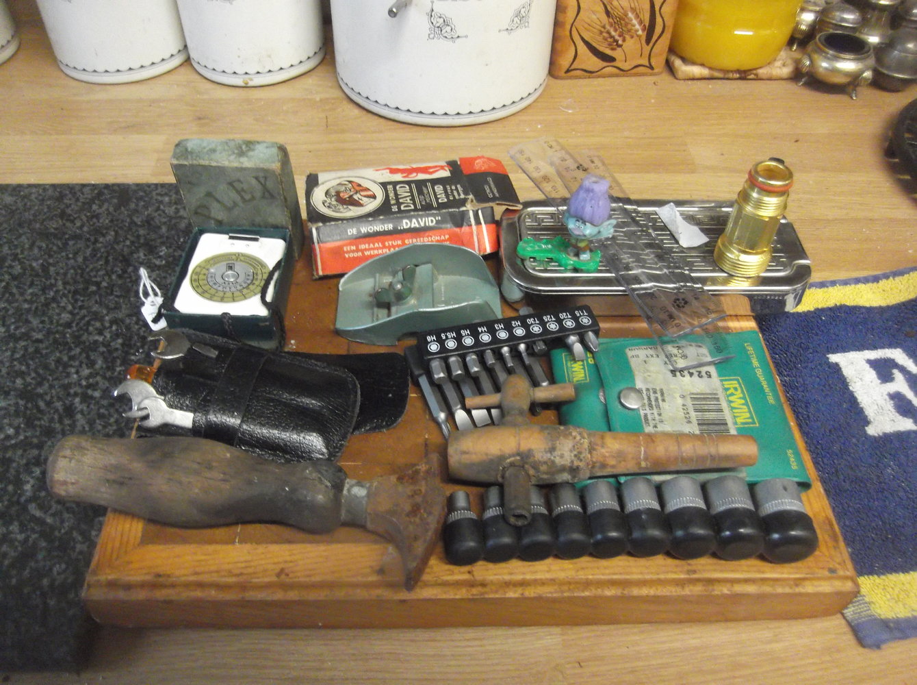

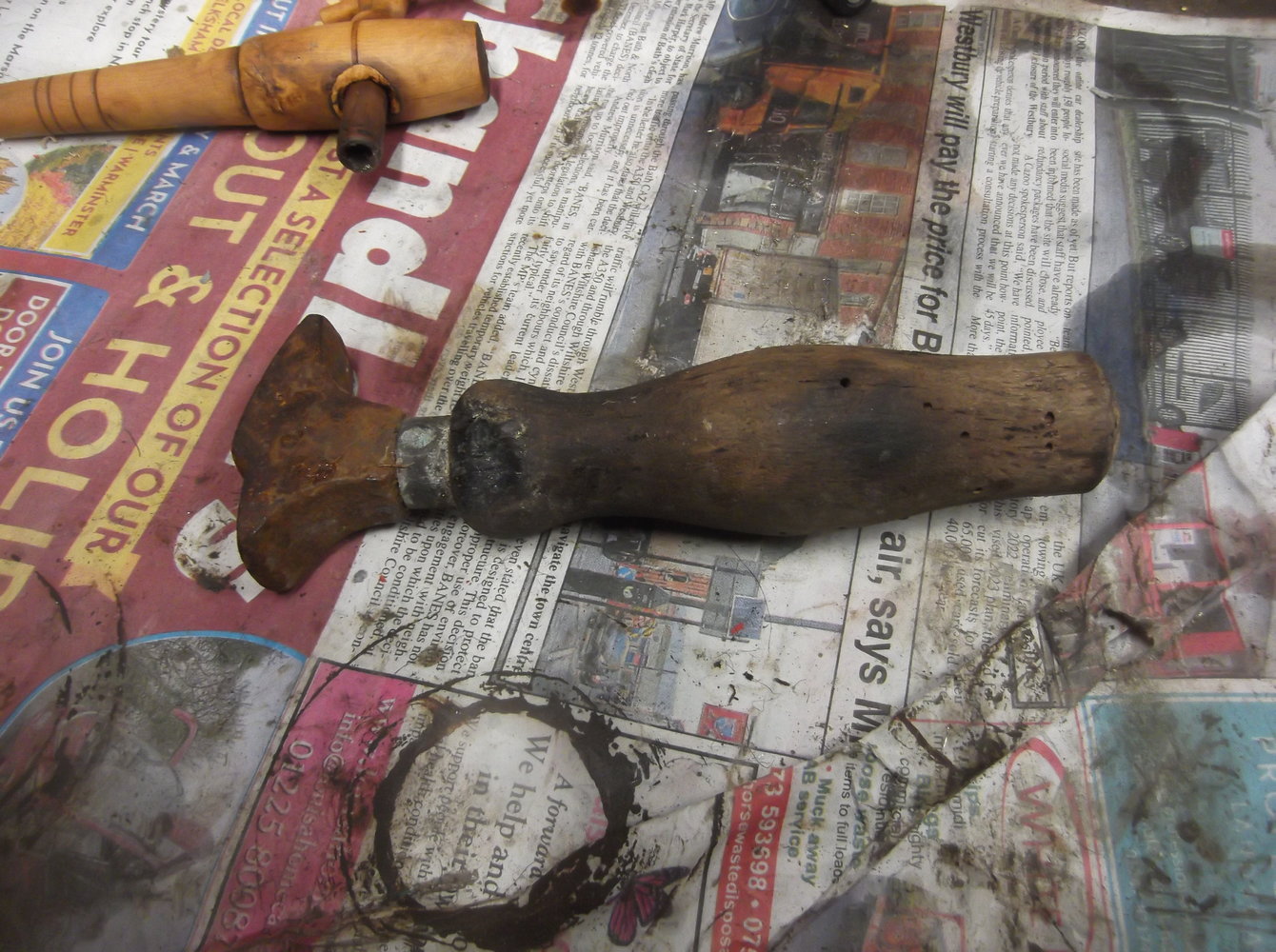

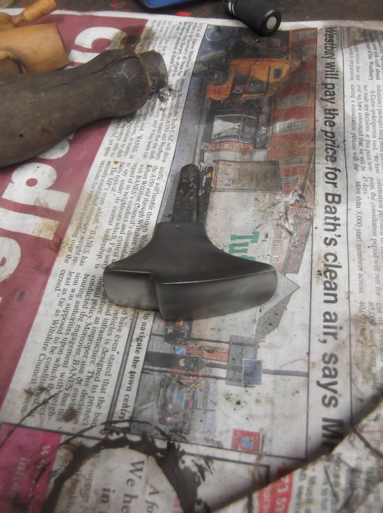

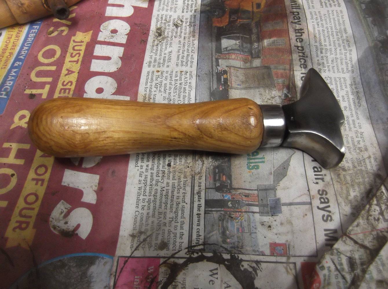

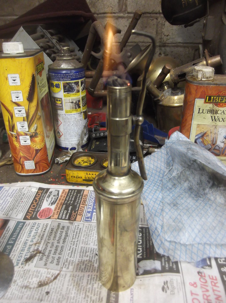

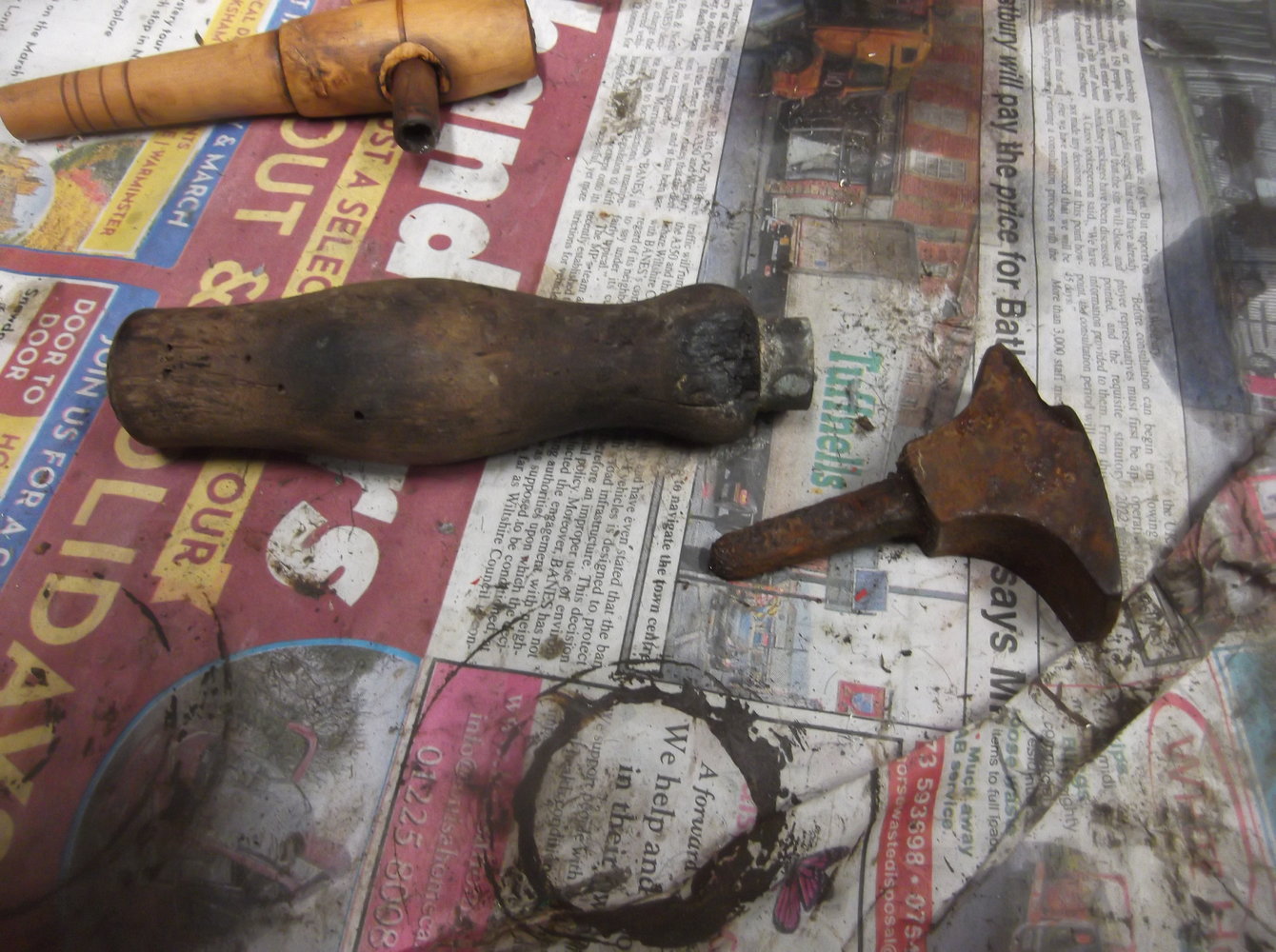

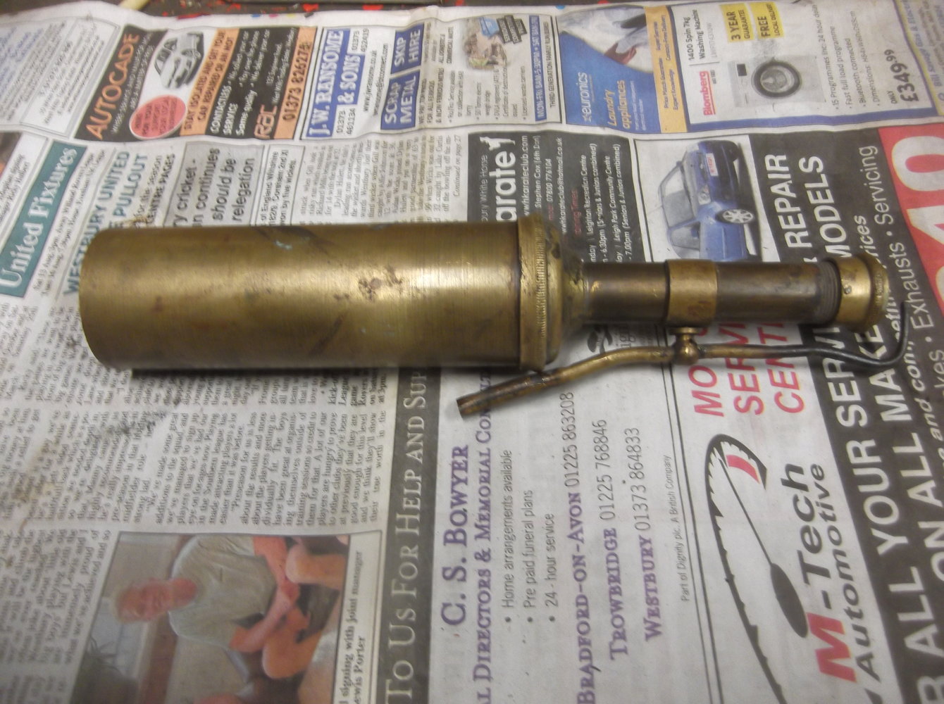

Glazing iron, for leaded windows ?Part 2.

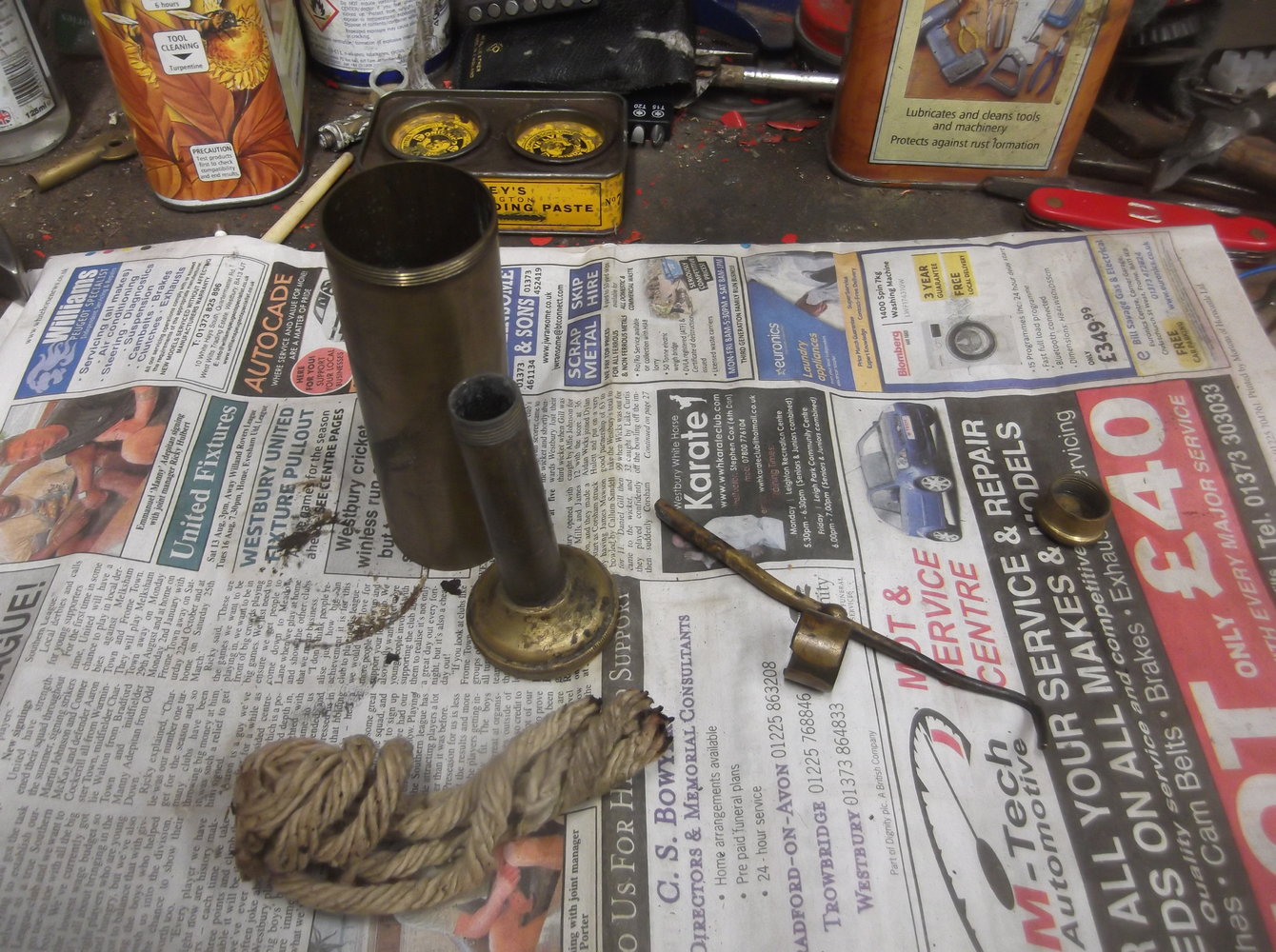

This glazing iron was terrible. But we used it as another example of how a tool thrown away as being to bad to save can be.

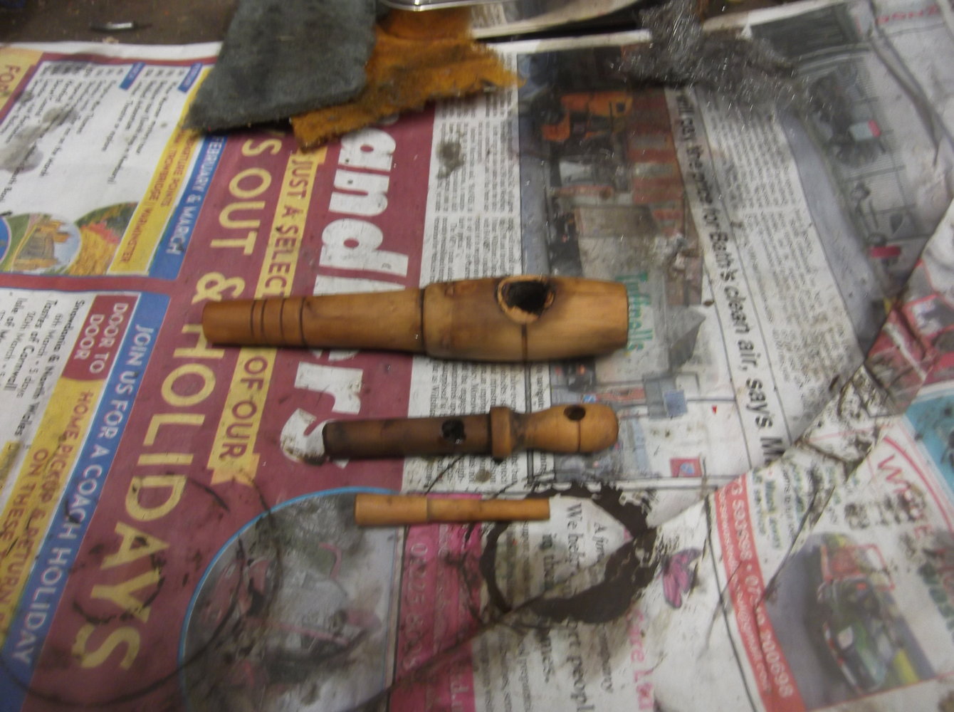

It fell apart.
A good clean.
A handle from the spares box, fitted with 2 pack glue.

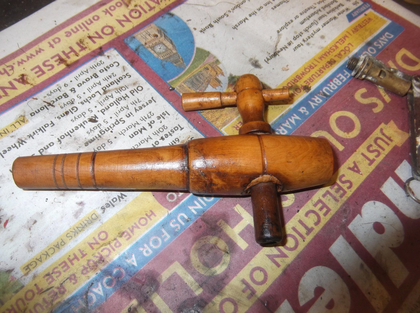

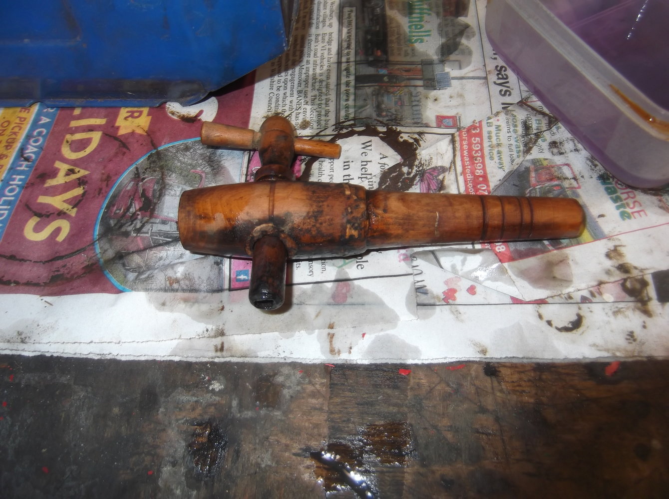

A Keg Tap.
In bits. There is a cork bearing in the body, but it was worn out.
Ok, The new cork is not 100%. But as a first time of trying to fix a cork bearing. it is not bad and it works.
