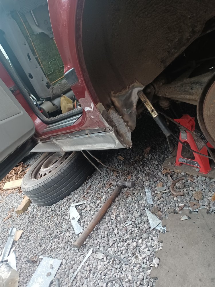

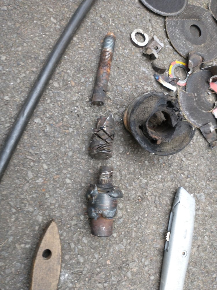

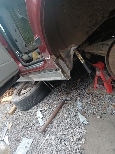

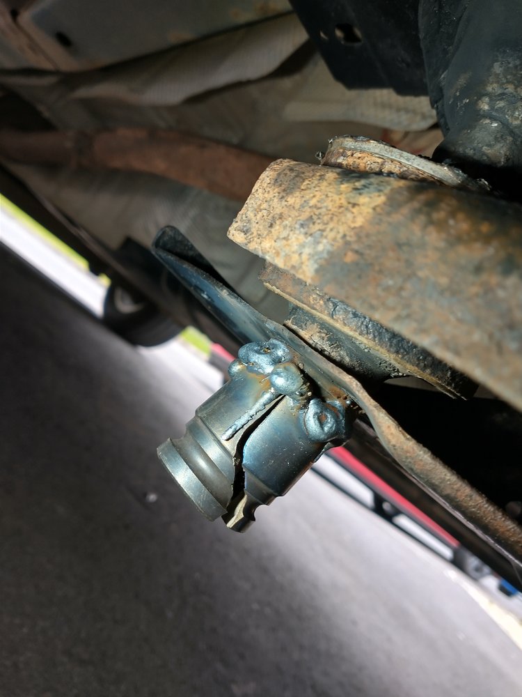

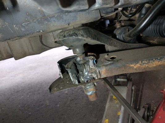

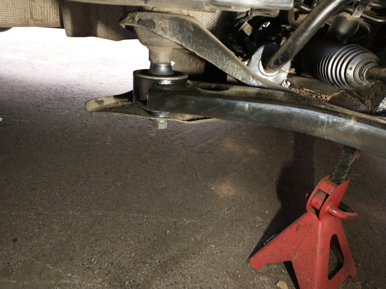

You mean cut a hole in the chassis so neatly it looks like it came from the factory like that! Older transits were the same luckily I only had to do it once, welded it up after myself but have seen one for MOT that had been cut open, folded shut and seam sealed, mk1 mondeos were the same.I've read the subframe sometimes has to come off if the bolt snaps or strips the threads...

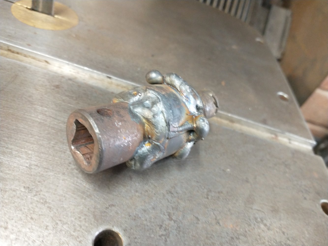

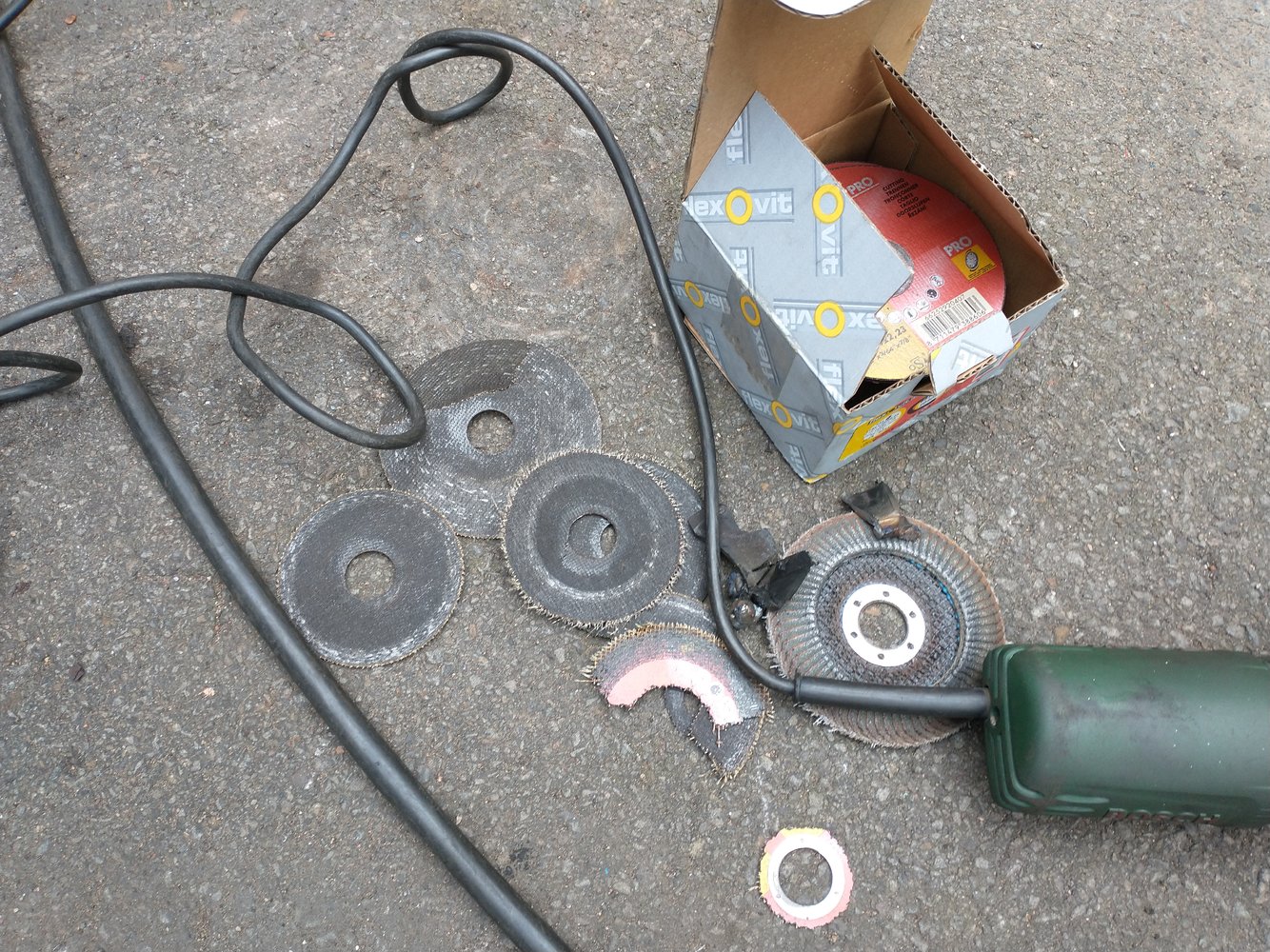

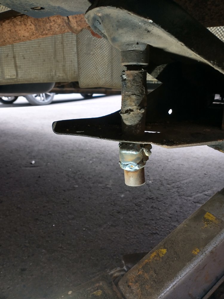

....if someone offers you a transit custom which needs the arms replacing..run away as fast as you can .....I've read the subframe sometimes has to come off if the bolt snaps or strips the threads.... luckily I just got away with 4 hrs sweat and swearing......3 sockets died...but not in vain
View attachment 387638View attachment 387639View attachment 387640View attachment 387641View attachment 387642View attachment 387643View attachment 387644
New transits the bolts go all the way through the chassis leg, so if the nut does spin, you can get a spanner on.You mean cut a hole in the chassis so neatly it looks like it came from the factory like that! Older transits were the same luckily I only had to do it once, welded it up after myself but have seen one for MOT that had been cut open, folded shut and seam sealed, mk1 mondeos were the same.
The bolt was not going anywhere...it was rusted solid to Insert in the rubber bush and in turn was rusted solid into the chassis.... couldn't get it passed the subframe....it came after a few more swear words I had to look upWind the bolt out as far as possible, then put a cutting disc/recip saw through the top and bottom of the bushing insert.
Then you can often get the bolt remains out with a pair of molegrips, and if not, weld a big nut on.
Alternatively melt the bush out with the gas axe and heat the insert.
