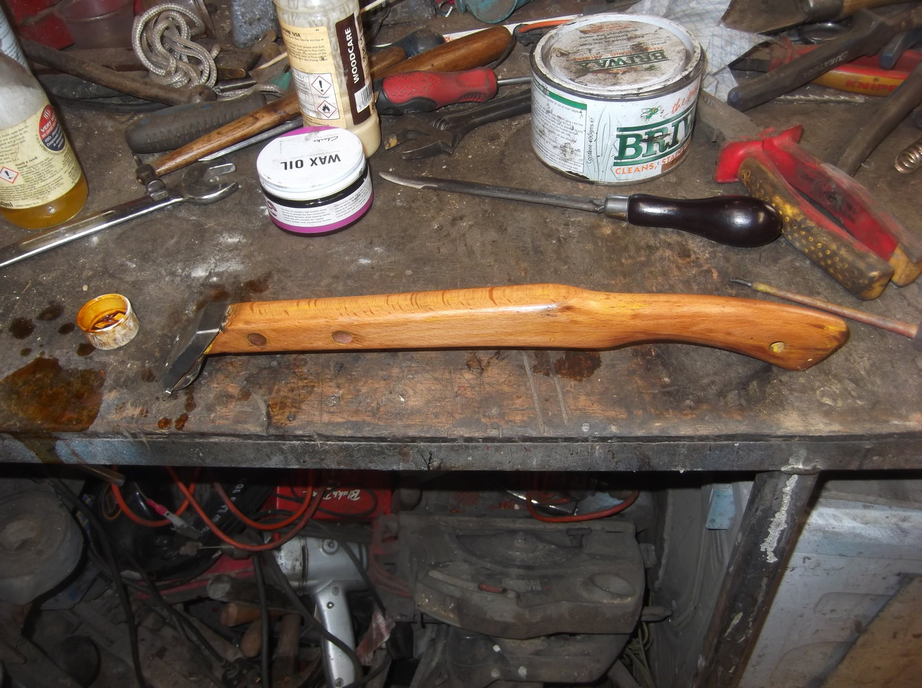

It needed some TLC, mainly fixing the handle.
The handle has been cleaned and 3 coats of French polish applied. The tang was cleaned up and now is ready to be fitted.

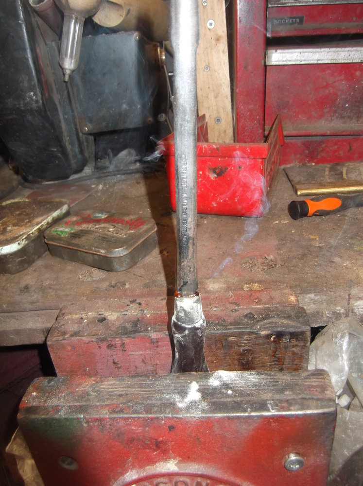

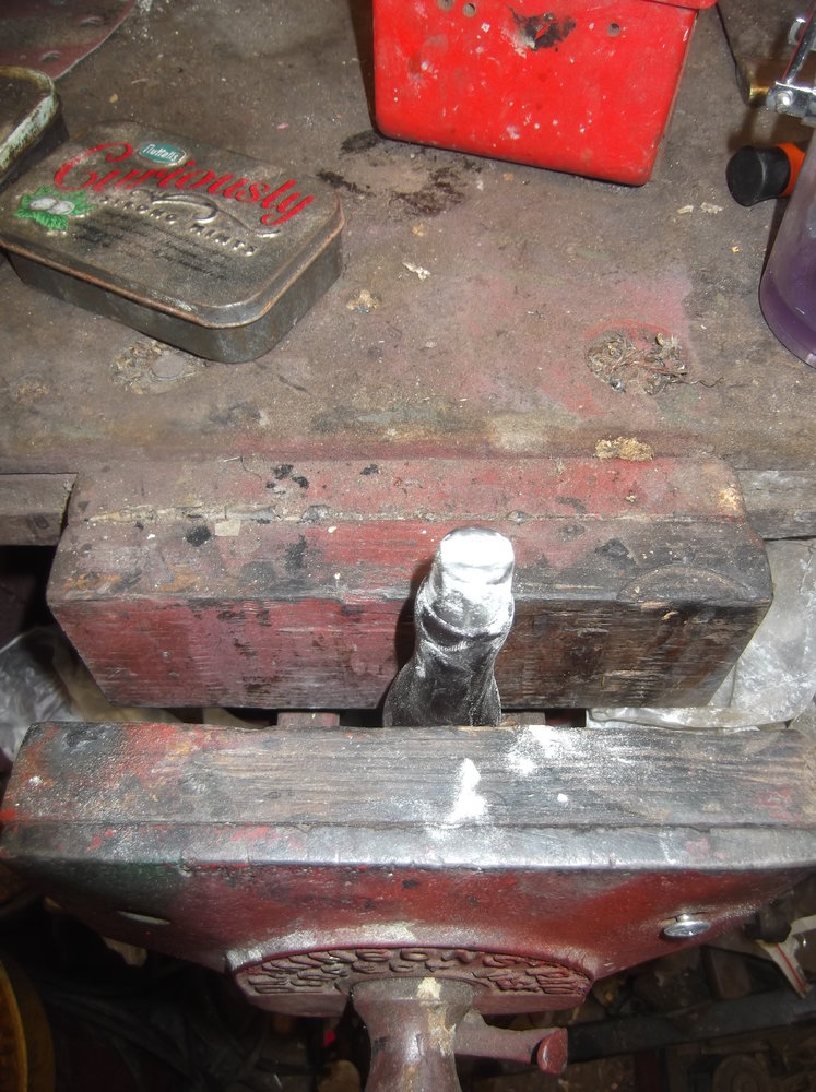

Handle filled with Sulpher.
Smoking.

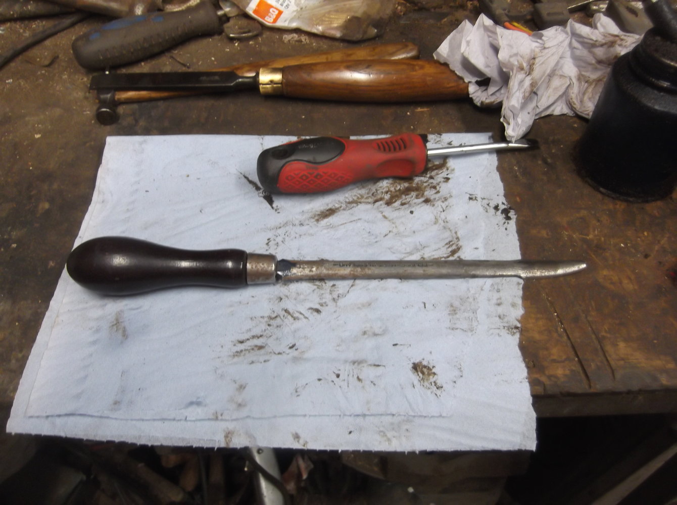

This blow torch is being fired on dirty lamp oil, why waste it.
The tang is heated so spit boils on it. Then fitted to the handle.
