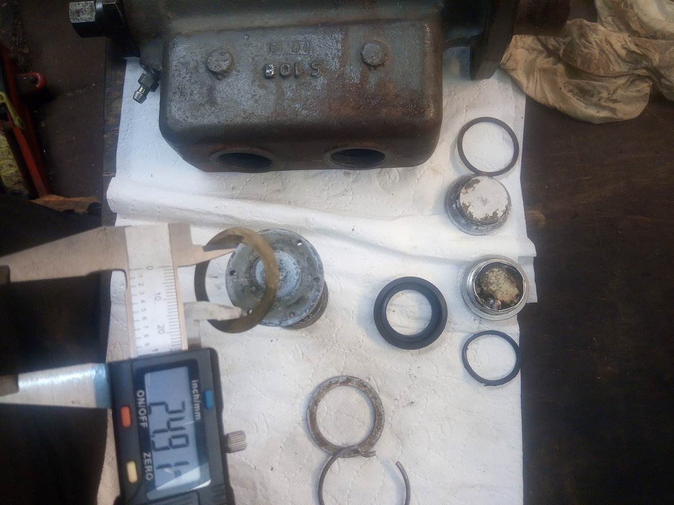

Do not do that.View attachment 414522

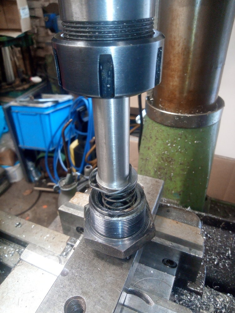

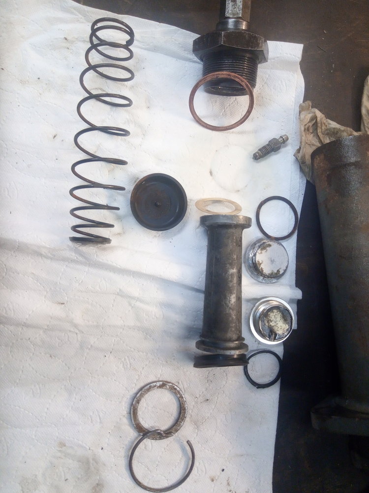

think I need to hone the cilinderwall or get a stronger spring. View attachment 414524
What, stronger spring or honing?Do not do that.
This company might be able to help:What, stronger spring or honing?
I say honing but wat I mean is fine emery cloth to smoothen the surface a little.
Spring seems a little weak but to find a fitting one that has the correct strength is going to be a challenge.
from what I can see the rubber seals are worn out. Honing the cylinder with sandpaper is definitely not worth it. Flex-hone for manual work will give the necessary surface cleanliness. What is an amplifier, a pneumatic actuator or a vacuum amplifier, is not so important. If the main brake booster fails, either buy a new one or buy a complete repair kit. There may be wear and tear further down the hydraulic component chain. You need to audit the entire system.What, stronger spring or honing?
Cilinder is depressed (on-off) by a big air actuator so I don't think it is really critical.View attachment 414541
