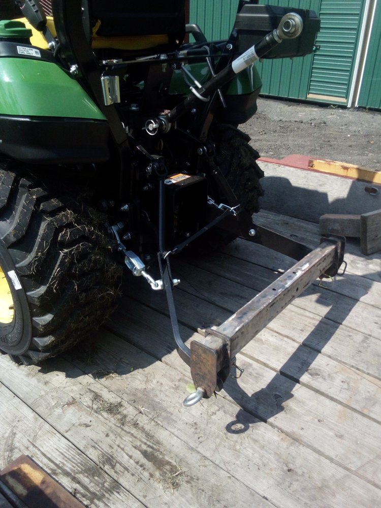

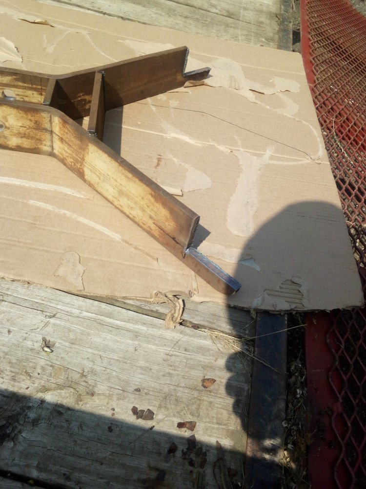

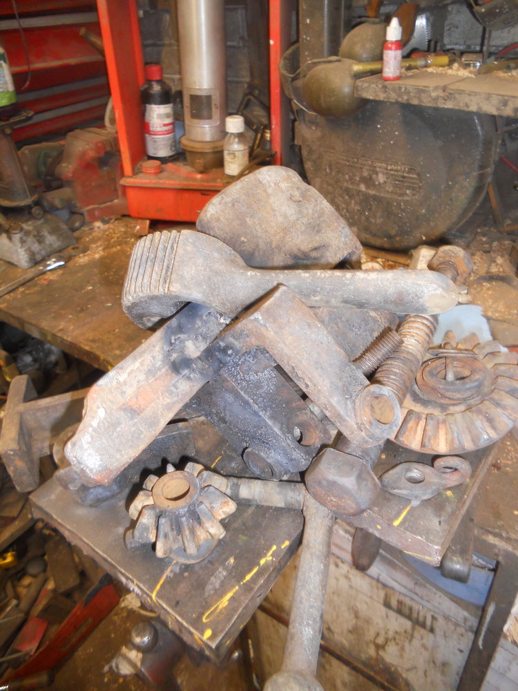

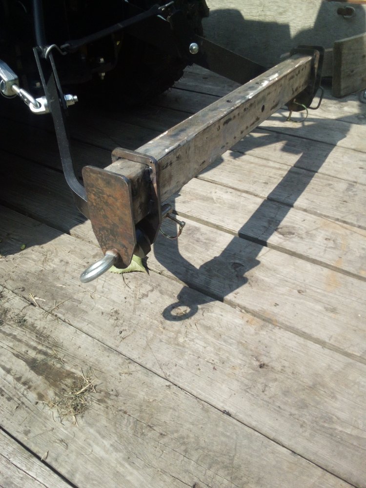

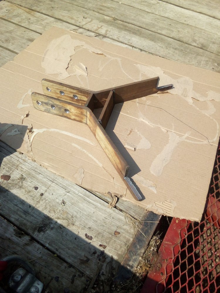

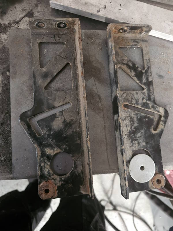

Yesterday morning I drilled and bent some flat bars for a friend, making a 3-point tow adapter (will apply a 2" receiver hitch
in the center on the bottom cross bar.)
I burned out the outer pin supports for the 2x3 box tubing for him last week,
he wanted to use those "3-point hitch pin bolts" but only using 1/4" thick plate with them.
I don't like them much at all with the cantilevered loading, so this is my method with 2 plates, and the arm in between.
